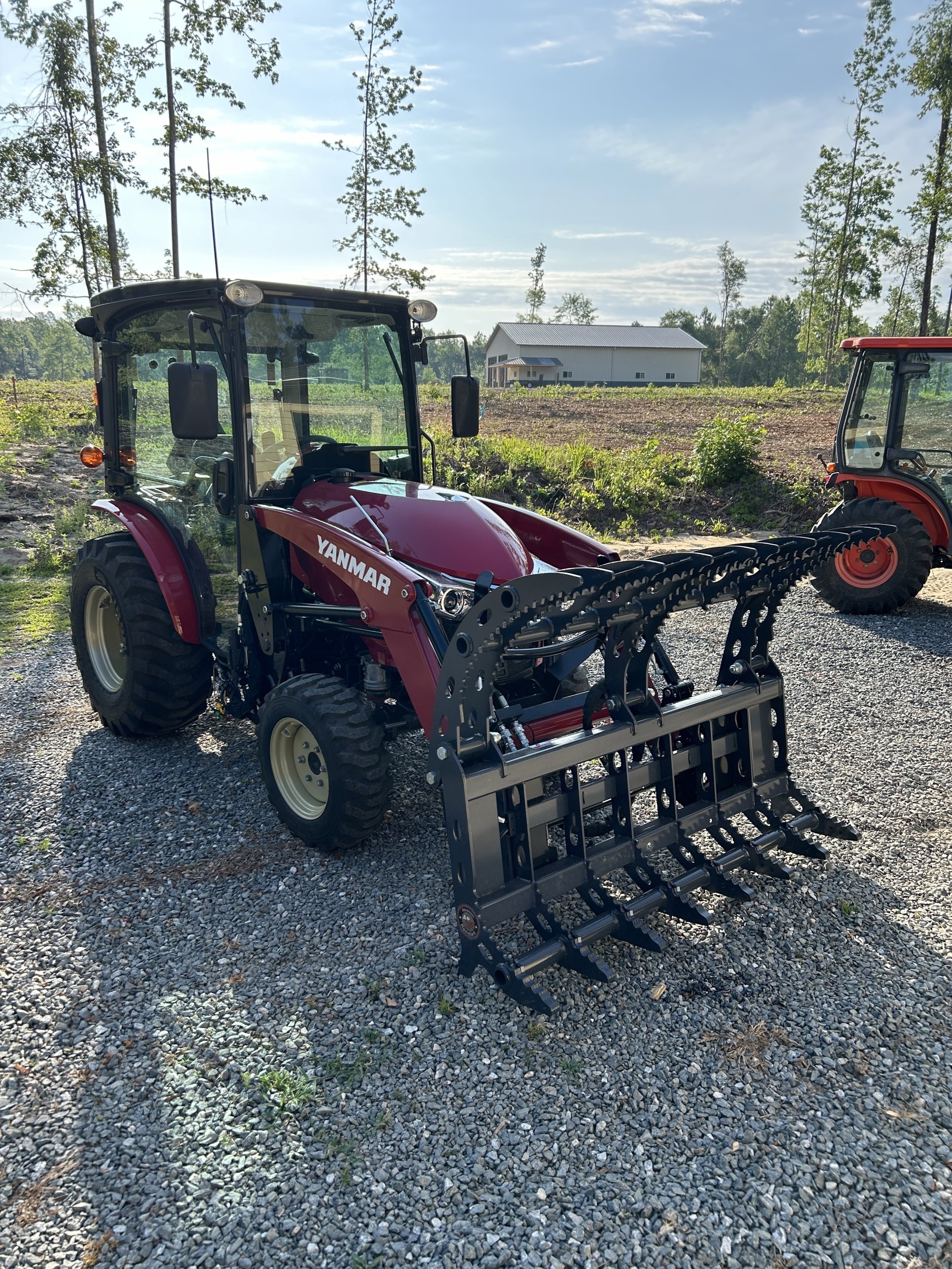

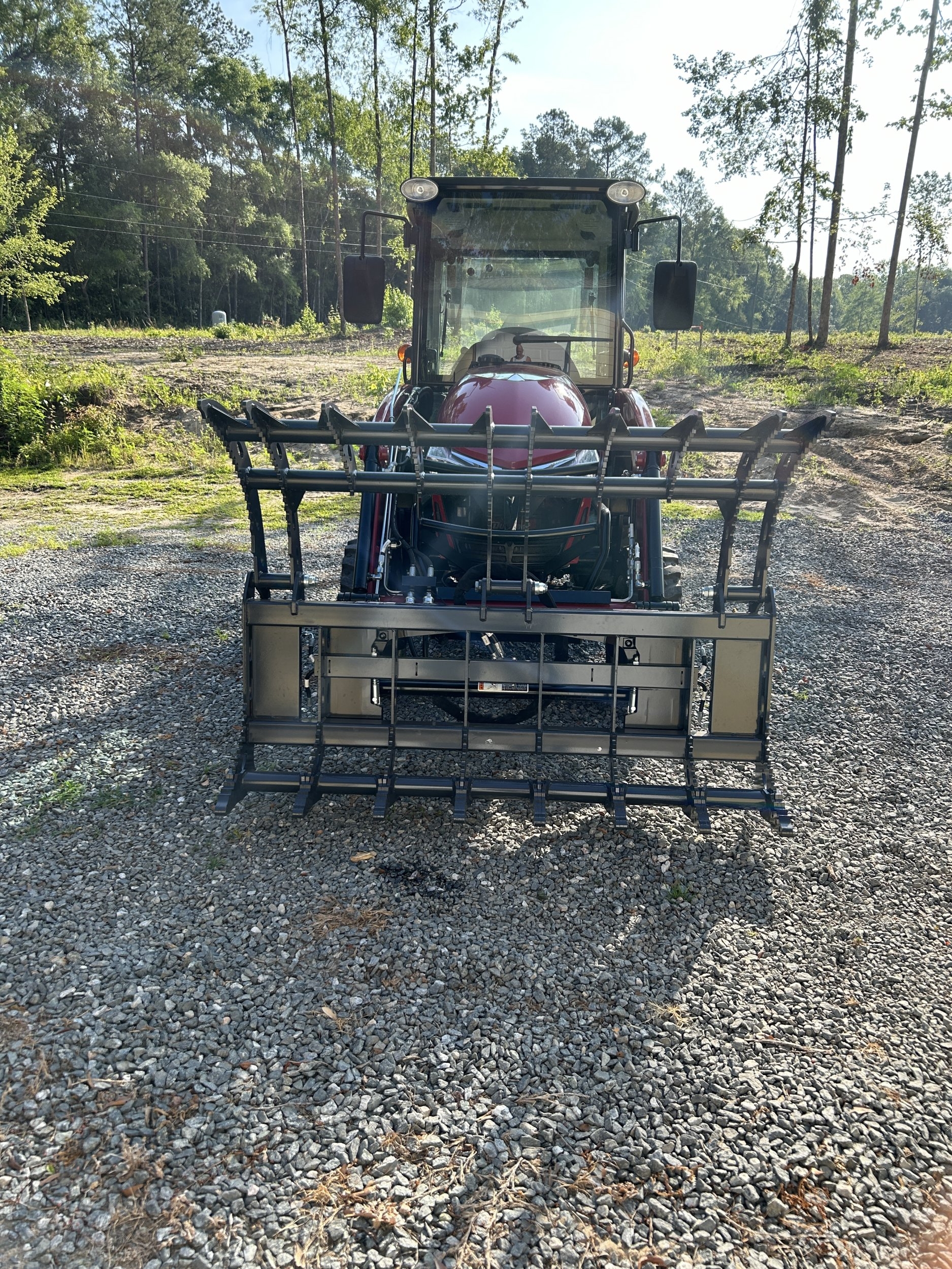

Hooked up and functions well. A few things to note. On a YT235 the hydraulic hoses are excessively long and the quick attach lever locks don’t have as much spring tension on them as I would like to see. Seems just the tiniest bit loose. That should be an easy fix.
The 62” seems to be a pretty good size match for this tractor. It looks much larger in the photos than it does sitting in the cab. With the wheel spacers installed it’ll be roughly the same width as the rear of the tractor.

Looks good.

That looks very nice. I like their take on putting the little wedge feet at the bottom back so it will stand itself up easier. Nice touch.
I like those too.
However, I wish each tooth had them so they could be used for raking backwards.
By having the teeth at the back of the grapple the bucket tilt cylinders would be closed/retracted and in their strongest position.
Thus keeping one from bending the cylinder shafts.

I like those too.
isn't that part of EA's "engineered" approach, putting the scraper on the inside of the lid?
