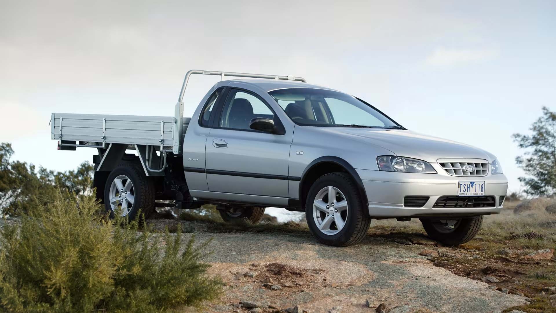

This looks like something that would be built in the backwoods of Southern Indiana! :ROFLMAO:
I don't get the reference.:confused: Is it complimentary? Or sort of an Appalachians-style thing?
/ Car - what if engine suddenly quits #23
I think to most of us here in the US, that vehicle looks a mis-mash of different vehicles put together despite the practicality: rear bed of commercial work truck + nose/cab of a commuter sedan + raised 4wd running gear. There are poorer folks here in the US that use "Yankee Inginuity" to take junkyard vehicles with good parts/portions to make something functional but definitely looking like it wasn't originally engineered that way.

Yes to the second although it doesn't have to be derogatory by default ... without offending MTGreen by putting word in his mouth or yourself by offending your built in anyway I will try to explain further... One could've used redneck or hillbilly to describe it (Appalachian style) probably the first though most people think when looking at it, although it is only because of it's miss match nature and out of place parts (the car part or all the rest), it is not by it's looks because it is very clean looking built. Although these term are often used or intended to be derogatory and judge by it's looks alone, at least for me a rednecky looking thing could simply be a custom built someone did with what they have to save money at the detriment of their time. Most people think why not simply used a 4x4 truck and put a flat bed behind it instead of doing all this work. It doesn't mean it is not ingenious by nature and made by a skill person.
/ Car - what if engine suddenly quits #26
Here in Australia, it was a Ford BA series, RTV variant. The RTV apparently stood for Rough Terrain Vehicle - beefed up & raised suspension, diff lock, under-body guards, different diff ratio, 4 speed automatic, 1 tonne carrying capacity and drives with the comfort of a normal car. Fantastic vehicle? You betcha! Mine's a 2004 build, bought at a government auction for used fleet vehicles in 2006. It was pretty high mileage for an 18 month old vehicle - 123,000km - and it had been used by the MRD (Main Roads Department) as a "scalies" vehicle (used for carrying portable weighing devices to do roadside checks on possibly overweight trucks, semis, etc). Now at 20 years old, it still has less than 180,000km on it, so a very low mileage unit! Love it!
I think that is an interesting little rig. I wouldn't mind looking at one in person and seeing if it fits a large person comfortably. But it would never get imported into the USA.
/ Car - what if engine suddenly quits #27
The "Utes" in Australia have always seemed like practical vehicles for much of the rural US. I have never really understood why they weren't imported here. Perhaps I am too bottom line about my utility vehicles / pickups. I want them to do certain things like haul / tow / tolerate driving around on back roads / pastures. I don't really care if they "look" a certain way, nor am I a " I have to own a brand X vehicle."
Those Utes are a darned sight more maneuverable than my current one ton, that's for sure. "YMMV..."

OK, I think I understand now. Incidentally, they were only two-wheel rear drive, but the diff lock feature means it's highly unlikely you'd ever get stuck in slush too badly. Sort of halfway between 2WD and 4WD.
Comfort wise, I'm 6'2'' and there's still more travel available on the seat rails to go back even further. And with the seat-back at a comfortable laid-back angle, there's very useful storage volume behind the seats.
The thing with Aussie utes (short for "utility vehicle", but no one over here uses that term - sounds a bit pompous;)) is that these days, the trend is for what are called "style-side utes". The hip tradies go for them in a big way - lowered, and with a big chrome roll bar - but in practical terms, no match for a cab-chassis with drop-down sides! I bought mine specifically so I could carry two standard size pallet-bins, one behind the other. The tray on mine is 8' long! (2.4m) The photo of the shiny one is not mine, by the way, and it has the standard length tray.
