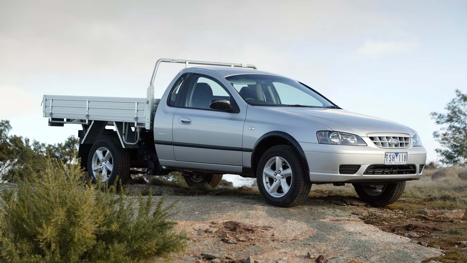

Here in Australia, it was a Ford BA series, RTV variant. The RTV apparently stood for Rough Terrain Vehicle - beefed up & raised suspension, diff lock, under-body guards, different diff ratio, 4 speed automatic, 1 tonne carrying capacity and drives with the comfort of a normal car. Fantastic vehicle? You betcha! Mine's a 2004 build, bought at a government auction for used fleet vehicles in 2006. It was pretty high mileage for an 18 month old vehicle - 123,000km - and it had been used by the MRD (Main Roads Department) as a "scalies" vehicle (used for carrying portable weighing devices to do roadside checks on possibly overweight trucks, semis, etc). Now at 20 years old, it still has less than 180,000km on it, so a very low mileage unit! Love it!

This looks like something that would be built in the backwoods of Southern Indiana! :ROFLMAO:
