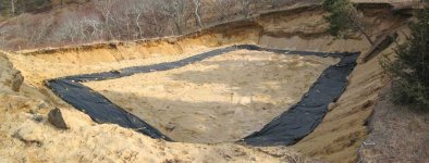

Thanks for the pointers on the slab. I'm a few months away from that, and will make sure we do this right. Junkman, you make a good point for the thicker slab. My current slab design varies from 8" to 4". 8" is the thickness at the edge of the garage door opening for extra beef there where the stress is high. The picture below shows that on top of my 4' deep frost wall and footing.
It then tapers back to 4", but I wanted to have some slope to the interior slab floor, so that water would drain out the garage door side (or melting snow on a vehicle), so I was planning on making the slab 1 1/2" thicker on the side farthest from the garage door.
I guess I could taper the slab back less, to say only 5" in the middle, and then thicken it to 6 1/2" on the far side for my drainage. That extra inch would give me a slab that ranges from 5" to 8" thick. Sounds like a good idea to do so.

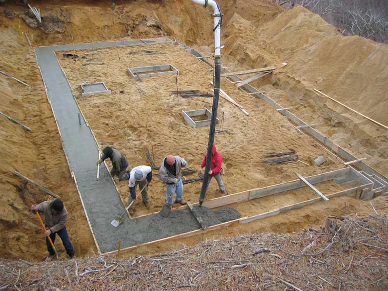

Well today was an early spring day on Cape Cod -- it has been warm enough for the ground to become unfrozen and for the concrete pumper truck to show up to pump concrete into the barn's footings. Needed to use a pumper truck since there is no easy access to the far side of the barn. It took 2 full cement trucks about an hour to fill up the footings, which have a total perimeter length of about 170 feet by 3 feet wide, by 1 foot deep, all at least 4' below grade. But the job got completed finally by the end of the day. The guy on the top of the bank is controlling the boom with a joystick he's wearing on his belt, while the rest of the crew is placing the concrete and smoothing it out. More pictures soon.

Finally got underway a few weeks ago as the weather turned to spring. Here's a photo of the footings being poured. Had to pump them because the access is not so great.
