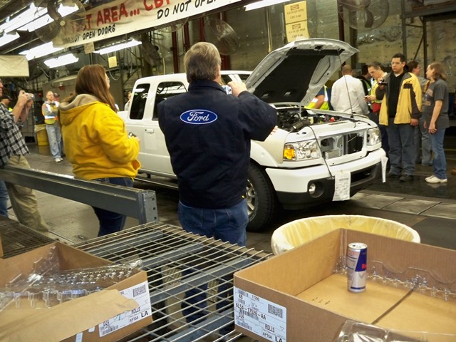

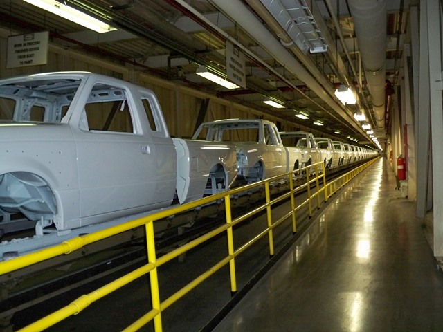

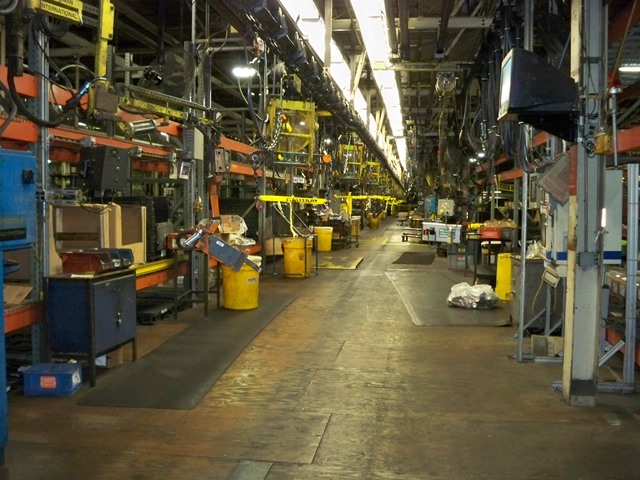

Here are a couple of pictures of the last Rangers out of the Twin Cities Assembly Plant. The picture of the single Ranger is the last one built at Twin cities. The other two are just empty conveyor lines.
