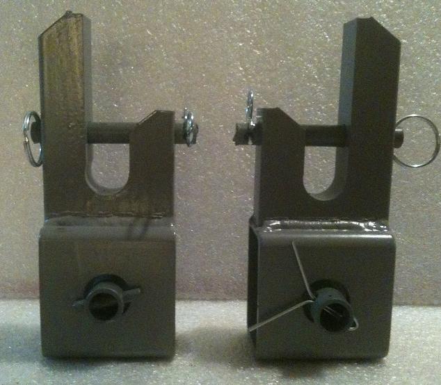

   / Cant hook up bushhog.. #25
This is a picture of the Carter EZ hitch I got, they work very well.
