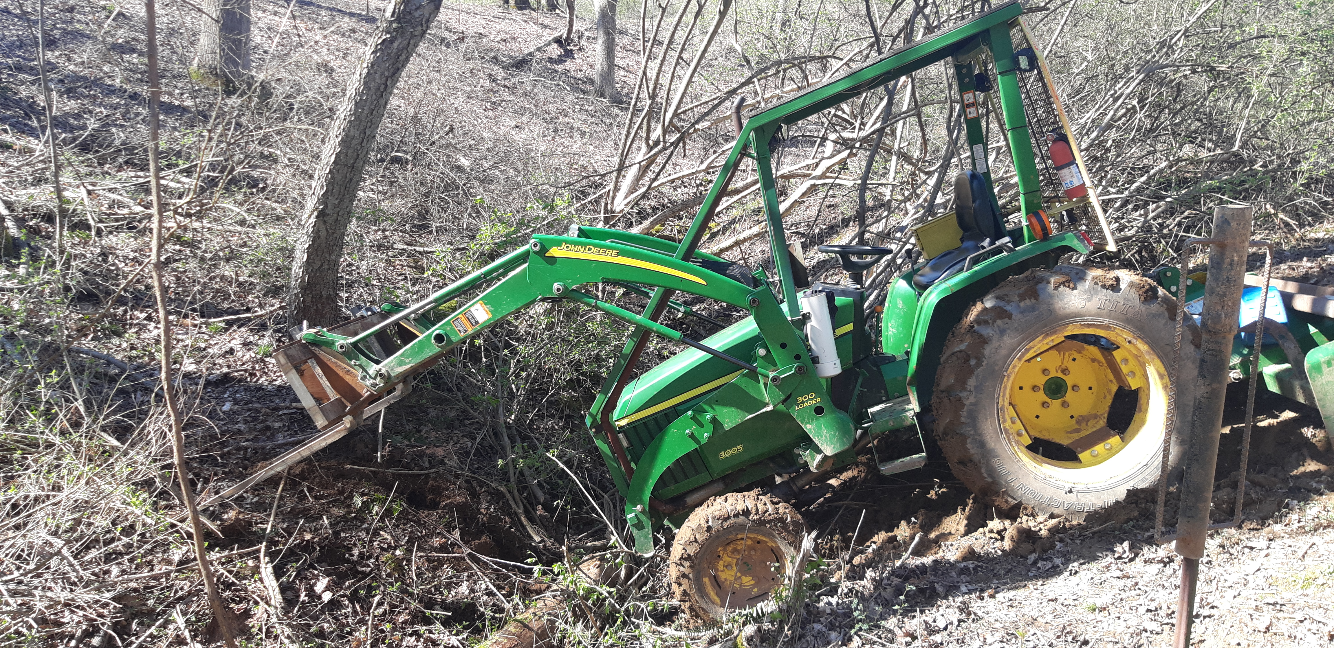

The 790/3005 is a good little tractor. I've had my 3005 (rebadged 790) since new in 2013, with about the same hours as yours, 530-ish.
I'm surprised by your gearing issue. I normally use 3rd low at wide open throttle to run my 5' brush hog, dropping to 2nd only for thick grass on steep hills. I doubt they changed the gearing... I normally find reverse in low range to be just a little too slow also...
Regardless, it's a good tractor... I've used mine HARD since day one... but it just keeps on taking the abuse... including getting stuck in the holler yesterday! I've added a roll cage and wheel spacers, a brush screen for the back of the ROPS, and fork for the loader...

Were you able to push yourself back out from being stuck - with the forks?

No... it took 2 Honda atvs, chains and come-a-long, and half the life of the clutch to get back up and out of that little creek... soft loamy soil, damp too... wife and oldest son on the bikes, 12yo son on the come-a-long... it came out shortly after. Forks just dug ditches, bucket would have worked much better for self-extraction.
