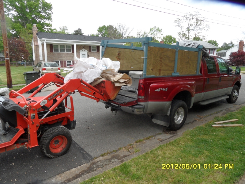

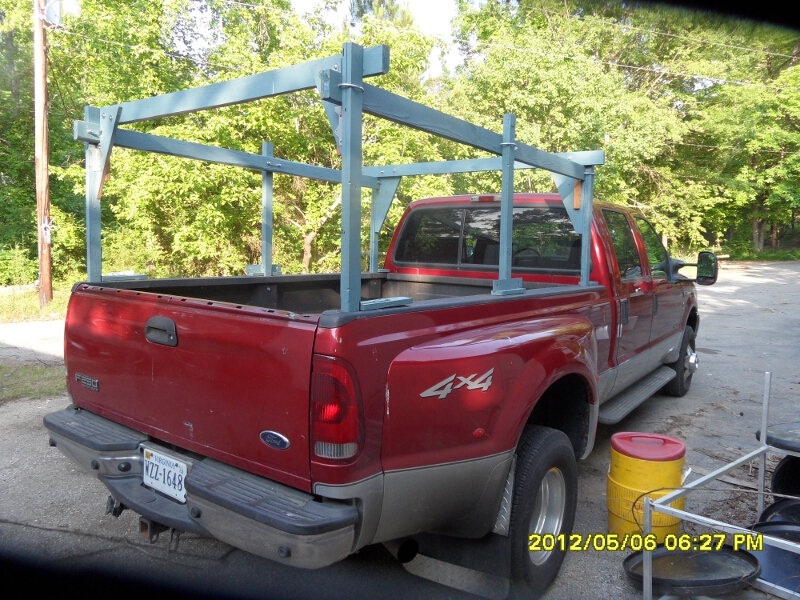

Build a ladder rack:
attachment.php
About $30 in U-bolts etc. (remember to use lock washers), $30 in PT 2x4's.
(That pic is down in Mississippi after I put sides on, loaded it up, drove from
Virginia, unloaded and took the sides off.)
I could not find a reasonably priced easily removable ladder rack for my superduty. Lowes carries a nice one for $300 but it's supposedly too low for my truck (I called the mfg).

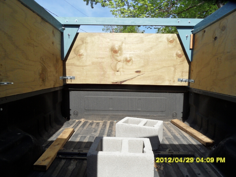

And then when you decide you need to transport a whole bunch of loose items (in my case mainly cardboard boxes of books) buy some 3/4 PT plywood and more U-bolts. (They were out of shorter U-bolts.)
attachment.php
Then start using your tractor to fill it up.
attachment.php
I put down a large tarp (you can see it laying on the cab) then wrapped the tarp back after loading to keep it rainproof.
If you want to leave the sides on later I suggest putting a window in behind the cab (plexiglass).
Everything is bolted together (with lock washers!) and has withstood an 800+ mile trip from Virginia to Mississippi.
The U-bolts work well because they provide easy strap tie down points.
I probably should paint the sides.
The rack also unbolts easily. But I don't know how it will affect mileage.

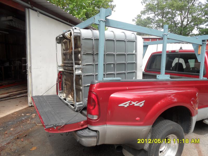

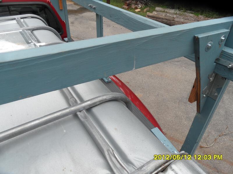

One further thing -
IF you build your own ladder rack make sure it will accommodate things you need to carry, both above and below the ladder rack.
I'm in the habit of judging things by eye and cutting it where I think it will fit, then making the other parts the same size.
So when I made the upright I judged it so the ladder would clear the cab. I forgot that I'd probably like to be able to load IBC totes without dismantling the rack.
In Mississippi I had made an expensive rain water collection system comprised of a discarded cooler, a free IBC tote and some cement blocks.
attachment.php
It had worked well and collected over 300 liters of water, which I used for lubing the mill and washing up. However it needed cleaning and prior to improvement I needed to load it into my truck to move it to an easy place to clean it.
So I made a ramp of 4x4's and went to slide it in. It hit the top rail. DARN. and double DARN.
But when I removed the 4x4's it fit:
attachment.php
JUST BARELY!
attachment.php
So remember to plan ahead!
