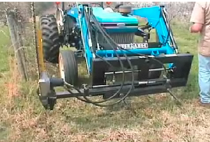

Thanks JJ! I was looking for a fixed setting to avoid accidental movement of the lever, but I may not have a choice. Also, I was going to use the PTO to drive the cutter and the AUX to drive a cylinder telescoping boom like the one in the photo. But I think I am getting ahead of myself for now. I will draw up a configuration of hoses, fitting and connectors to implement this. I will then ask for a sanity check.

JJ has picked the right valve for you. Both control of flow and pressure are integrated in one valve.You can set either pressure or flow from O to full flow and 0 to 3000 psi. The cutter uses a 3 cubic inch dispacement per revolution motor, so 3.3 GPM produces 254 theoretical rpm which is their ideal speed. In actuality they allow you up to a maximum of 400 rpm on their motor so you actually have quite a bit of leeway in setting the speed/flow.
The flow adjustment lever has a locking device on it once you set it you just tighten the knob and it stays. The same is true for setting the pressure, there is an allen head screw under the cap with a locking jam nut, it will not move once adjusted either. Flow is motor speed & Pressure is motor power in simplistic terms. That's a great looking cutter. Hedge trimmer on steroids, go for it. I can lend you a flow and pressure meter to set your speeds and pressures if you do this.
