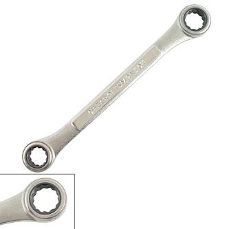

I do this kind of stuff all the time to make wrenches for special jobs. I wouldn't even use two wrenches for the job you're describing. Cut your wrench as described above and add a piece of 3/16 x 1 or 1/4 x 1 flat bar as long as you need it to be. If you don't need the open end then throw it an a box to be saved for some other custom job at some point in time.
Do you even need to cut up a flat wrench? I have a bunch of cheap sockets that I've collected over the years. Weld one onto the end of a flat bar as described in the above paragraph and there you go. If a socket is too long then just shorten it a bit before welding.
Edit: I'm not totally sure I have the right picture but I would make two wrenched for the job. One as described above and the second being a cheap ratcheting style stubby wrench with a hole drilled into the shank or the open end. Bolt a flat bar onto that leaving it loose enough to swivel and just use the flat bar to operate the ratcheting flat wrench to quickly turn in the bolt. Then use the first wrench to tighten it to the final torque.
Hopefully I described s clear enough word picture.

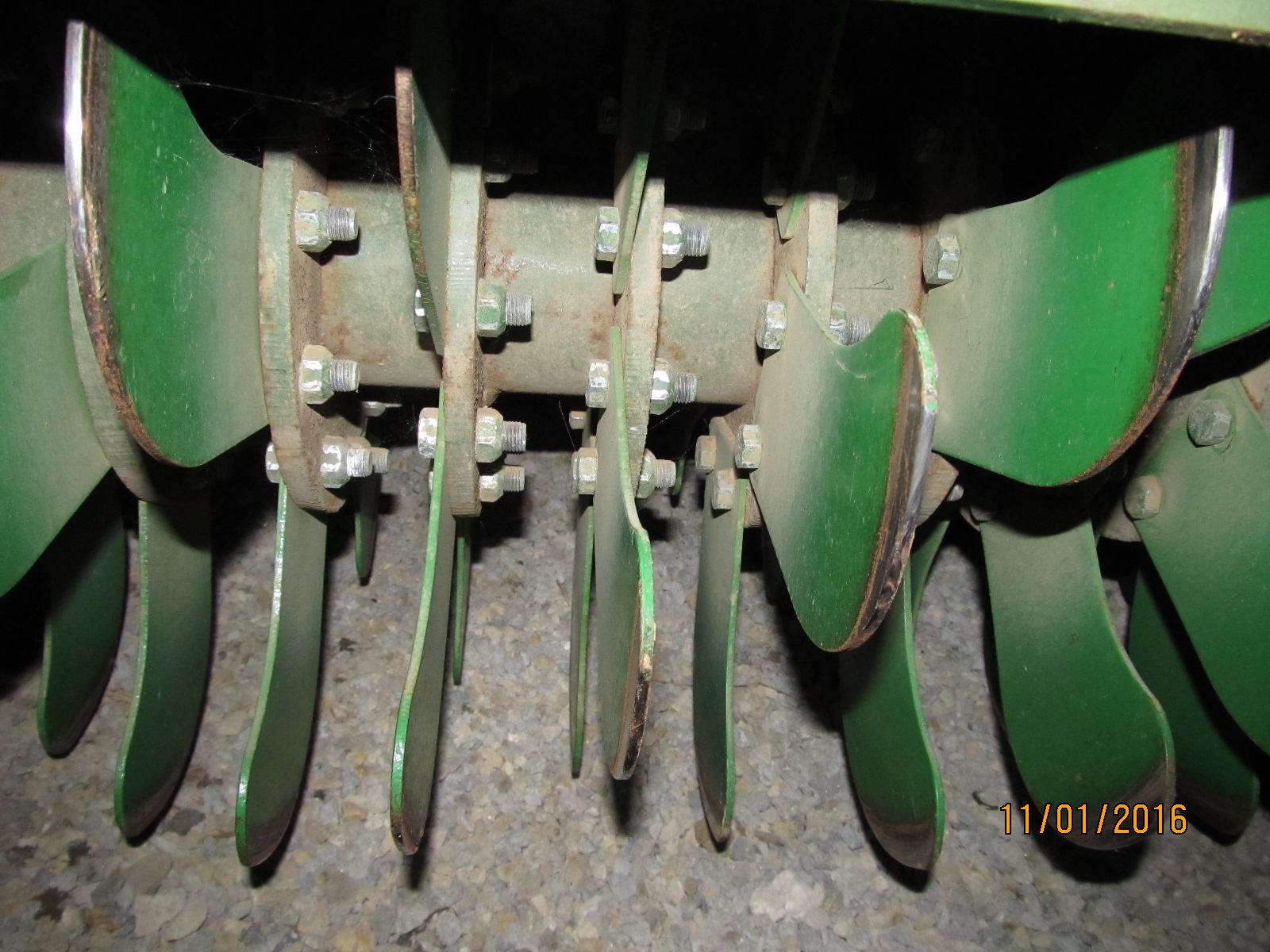

Here you go. I think the tines (slitters) are on a 2 3/4" center and the tines themselves are long enough that when the wrench is on them I can only grab the last little bit of it and can't get enough torque to fully tighten. That's why the longer wrench thinking. A ratchet will not fit and the only solution seems to be a pair of extra long 12 point box end wrenches. That's all that will fit.
I'm really trying to stall this job until spring so I'll have time to think about it --plus I don't really want to do it. I'll feel better in the spring. :D
