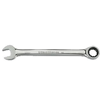

I'd use LD1's advice and extend a ratcheting wrench. It will save a lot of time and you'll have a ratchet on one end and an open box wrench on the other end of the extended wrench. One for speed, and the other for power.
   / Can I cut and weld two wrenches to make a longer one? #19

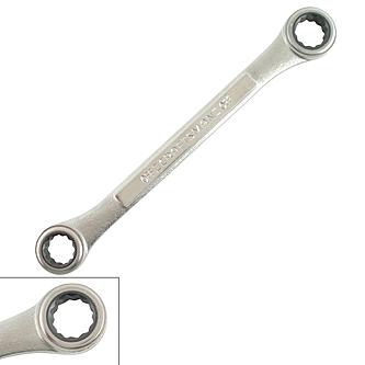

sixdogs, have you seen or used a ratcheting box end wrench?
You would still need to lengthen it.
   / Can I cut and weld two wrenches to make a longer one? #20
I have several of those, and they are dang handy!. Like the others I would not hesitate in welding to make the tool I needed. After all if the crows can make little hooks to dig out grubs, surely we can weld on an extension. :)
