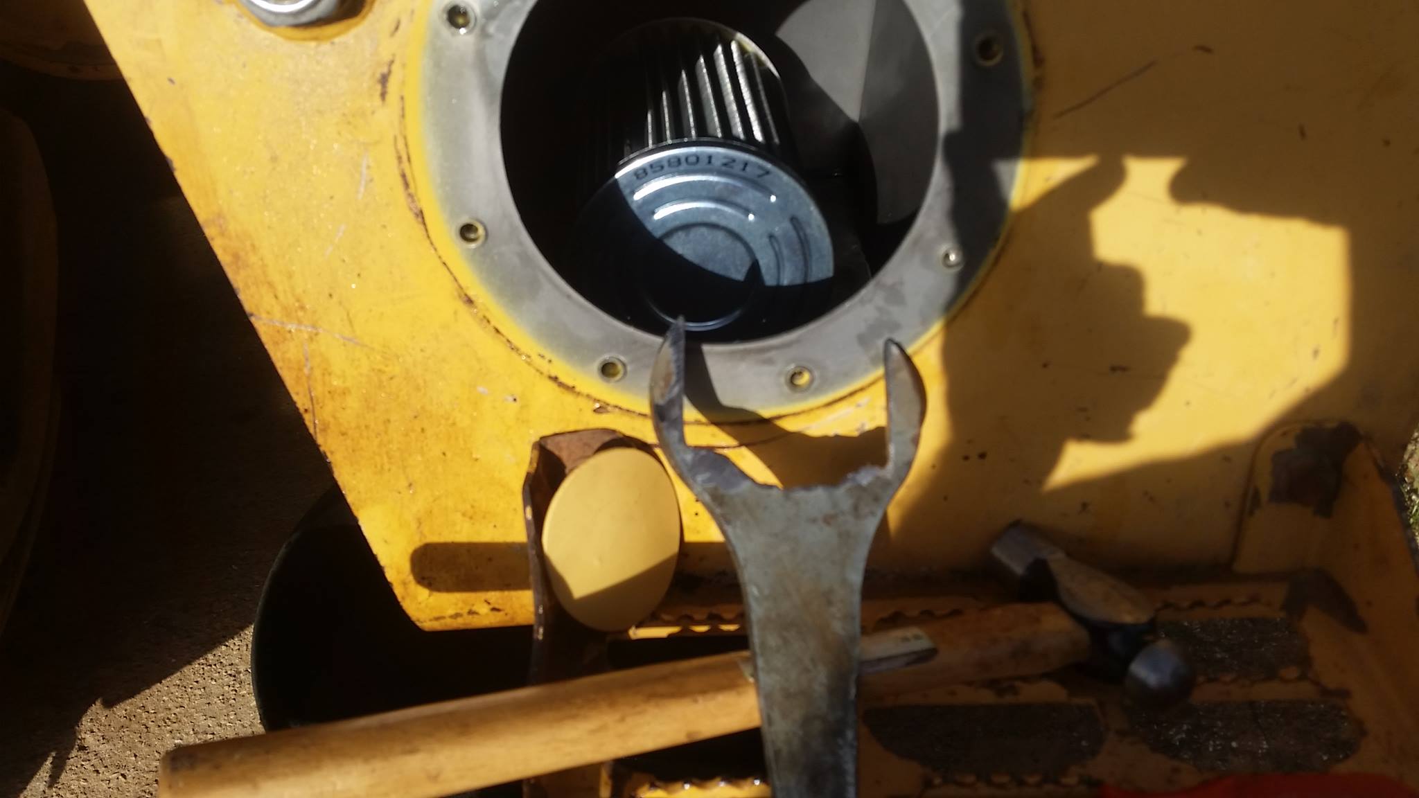

Uhhh, you must have missed it. I'm the OP and used suggestions mentioned to solve the problem and said so in post #39. There is a wrench out there called a "flywheel wrench" that is extra long and will work perfectly for me. Who knew?
The extra banter is very helpful to those who don't know. Knowledge is passed down in much the way all of us learned.
   / Can I cut and weld two wrenches to make a longer one? #56
A breaker bar and socket should fit in that space with no problem. I measured a 1/2" breaker bar with a 1" socket on it and it's 2-3/8" from socket edge to the back of the breaker bar head. You should be able to roll an 11/16" twelve point socket in there with no problem.
If you have a Harbor Freight store near you go choose your weapon. Search results for: 'breaker bar'
I have their 36" half inch bar I use often. The 3/8" breaker bar is 17" long and should afford even more clearance if it's strong enough.
BUT, your welding two wrenches together will work without a problem. It's just not going to work as well as a breaker bar if you can fit it in the space.

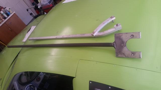

I build and modify tools all the time.
Here is a peg wrench I made to get my stabilizer cylinder gland nut off. I have since modified and reinforced it to remove a larger gland nut and kept it's original functionality intact.
Here is a wire wheel knockoff wrench from an MG I modified to remove the oil screen in the tank of my backhoe.

Yeah, they are. It just takes time and will do over the winter. One ratcheting box wrench and one extra long box wrench and it's OK.
