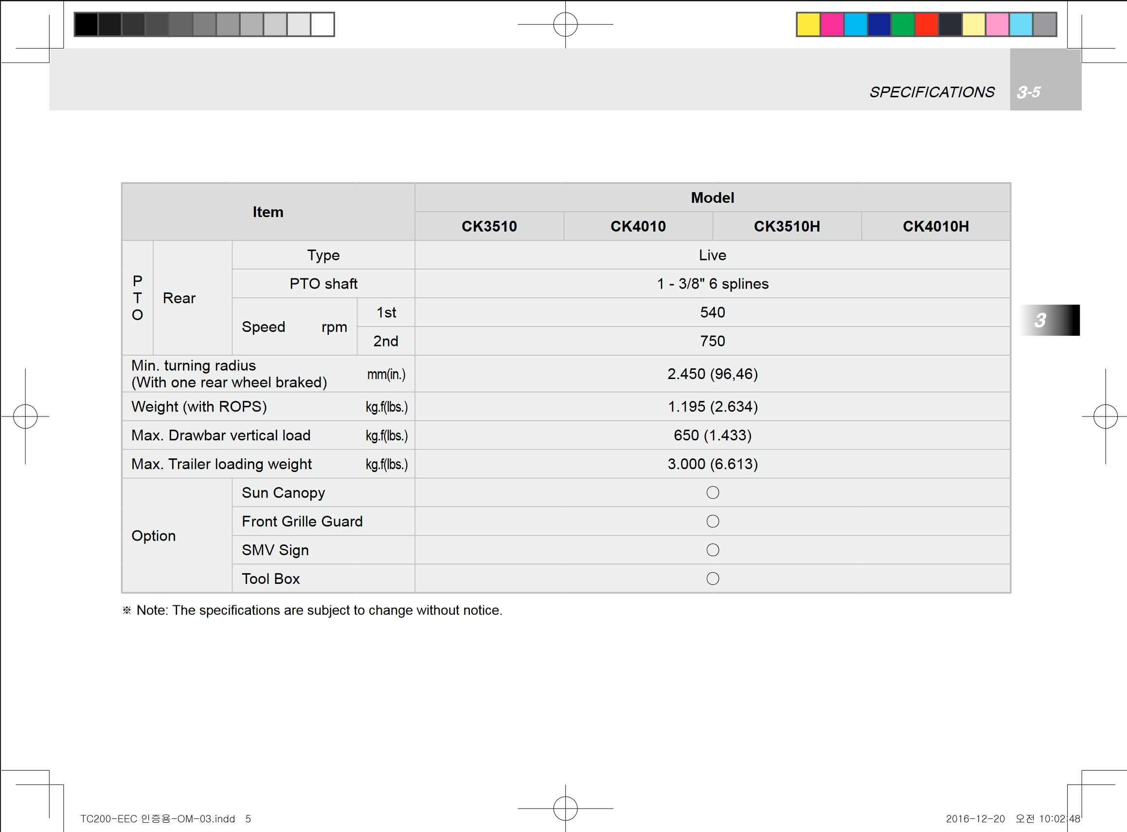

There are a few discussions about how much a tractor can pull. For example, Deere advertises that the 3D series tractor can pull about 4500 pounds. They also give a recommendation of 1.5 times tractor weight for an unbraked trailer and 4.5 times tractor weight for a braked trailer, but this is for on-road use at full speed. We've pulled a whole lot more than that for hay wagons and grain wagons on the farm, but at about only five miles per hour.
Most likely your limiting factor is going to be tongue weight if driving on dry ground. A bumper pull trailer unlike an agricultural wagon is going to put weight on the drawbar, and your tractor has a limit on how much drawbar weight it can handle. On my tractor, that is listed in the manual, you should look in yours to see what they say. I suspect you would be traction limited where it's wet if you have stuck a truck multiple times. Do note you may need a lot more tractor to pull out a full 14k trailer. I pulled out a four-wheel-drive F-250 pulling a 14k bumper pull trailer loaded with five tons of round bales that got stuck in a field not that long ago. (It was not my truck.) It took a six-cylinder MFWD rowcrop tractor weighing close to what the truck + trailer + bales weighed to do the job.

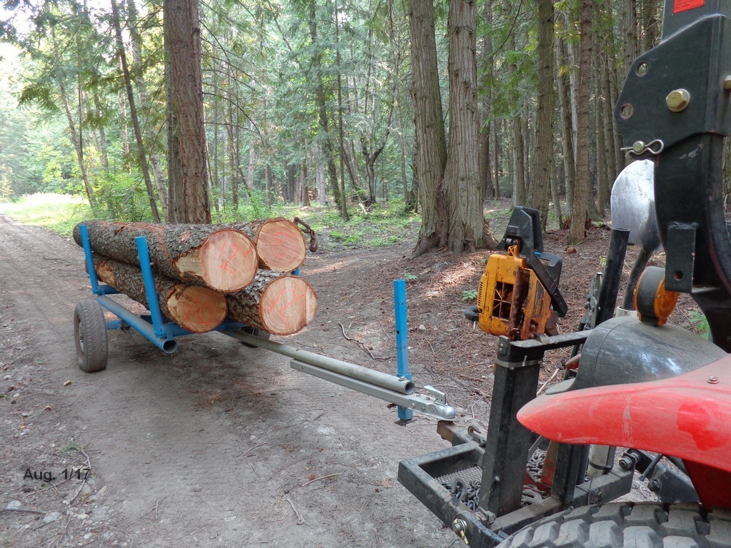

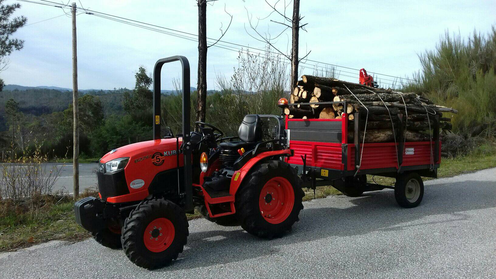

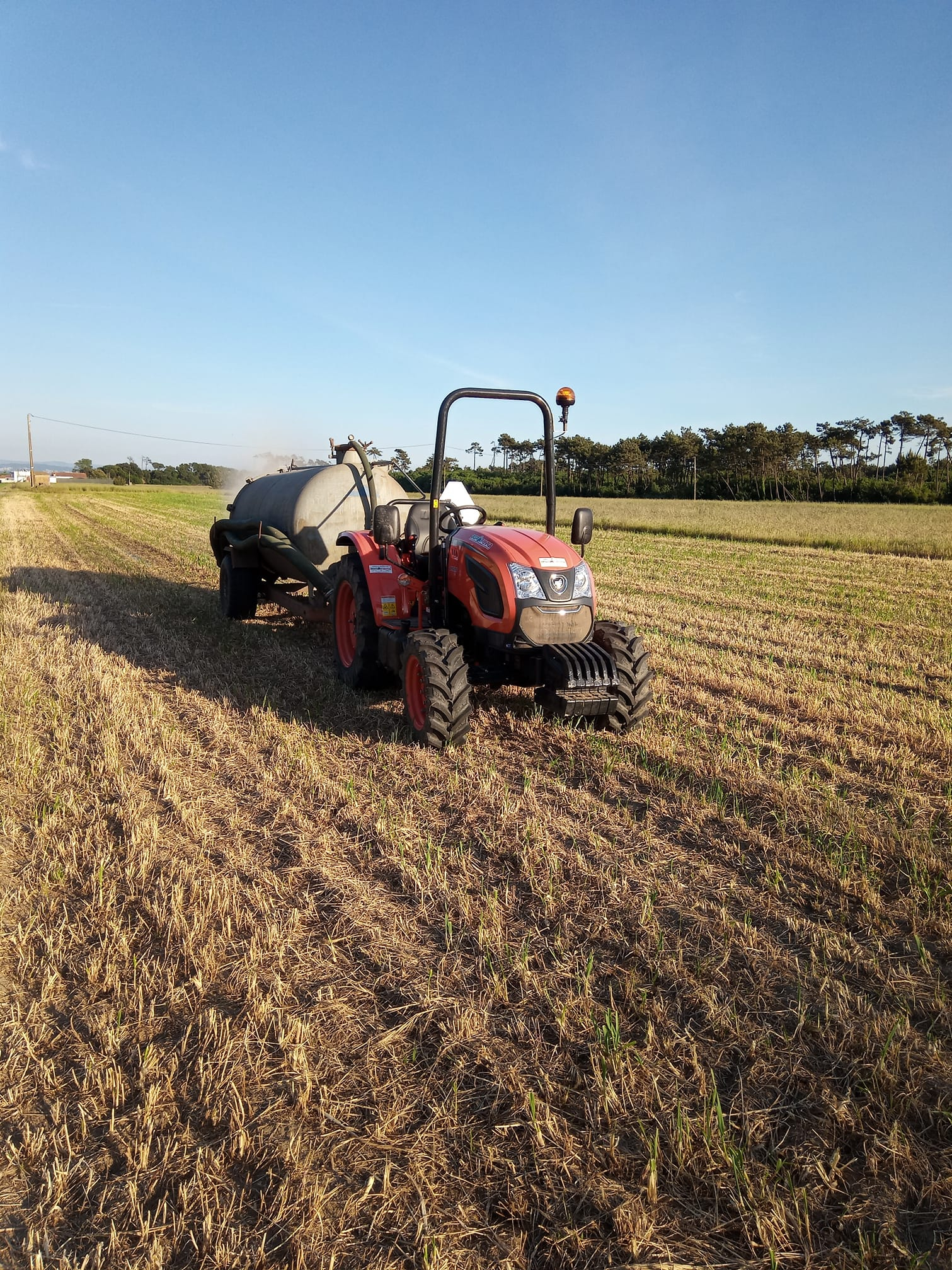

As they say, a picture is worth 1000 words. I use either a little tiny b2920 or an l3200 to jockey trailers around without issue. Heres about 11000lbs getting towed around by a 1500lb tractor. Its just very important to stop and turn slowly. We could go round and round about how steep the hill are and how slick and deep the mud is, but the definitive answer always will be that it depends.
