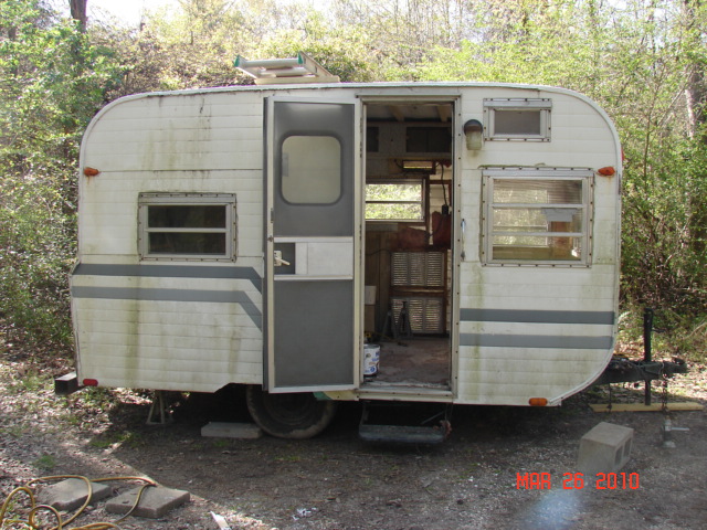

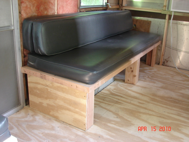

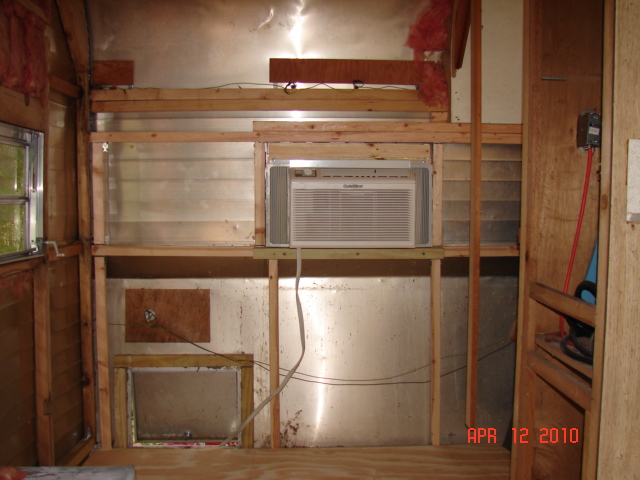

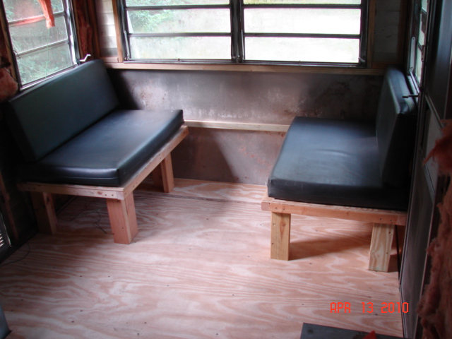

I 'v gotten good advice on the trailer forum from members about brakes, but its time to expand here for more feed back on other aspects. I 'm having trouble prioritizing work order for this project. I want to get it minimally serviceable for short camping trips ( mostly primitive ) while I continue work.
1973 Go-Tag-A- Long out of production
I have gutted it, repaired all exterior road lights and wiring ( 4 pin flat plug), installed new roof vent, caulked and repainted roof with polymeric paint to stop leaks, replaced old wood floor, installed new anchor bolts to chassis, checked 110 V system, new small window AC, new tires ( spare ), and built kitchenette benches and foldout couch sleeper. No DC power at present.
Tow vehicle is 2003 Ford Ranger XLT Hitch rating - Weight distribution system 6000 lbs 600 lbs tongue, without distribution 3500 lbs. 350 lbs.tongue. Have no WDS

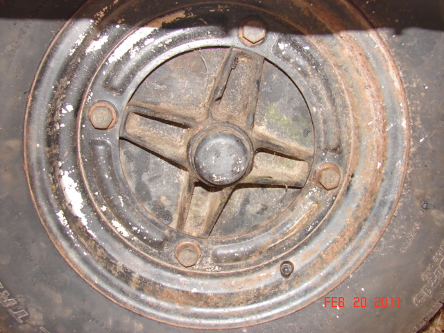

Trailer brakes must be completely replaced.
I have no idea what the trailer weight is now, but I can pick up tongue easily and I 'm 5' 6" 132 lbs.
Where do ya think I should continue and what might ya need to know ?

You'll definitely need brakes regardless what it weighs. Wait till it starts wagging around back there and all you have to do it touch the brake button to straighten it out. Or, it's full of gear and you are on a long winding downgrade.
Best thing is pull the backing plate off and take it to a axle and wheel supply house to match it up. This is all pretty standard stuff. They'll hand you a complete bolt on backing plate with shoes and magnets and everything, ready to bolt on. Drums too, if you need them, along with grease seals, bearings, etc, and you're all set.

You may want to look at replacing the whole hub assembly and maybe the whole axle with new brakes and current style rims. The cost isn't too bad unless you have odd sized stuff on there. You can look at electric brakes from Northern Tool + Equipment for the brake setup and axle if you go that route. I would definitely setup a 12volt system that your truck will charge while driving and with LED lights for those times that you don't have a place to plug into. Electric brakes and power from truck to camper will mean a 7 pin plug. Other than that make sure you have enough tongue weight, standard is 10% of the trailer weight I think. BTW, it may be worth while to have it weighed at a weigh station to get a baseline.

Sailorman: Please do the brakes! Until it happens, you can't imagine the feeling when you apply your brakes on a wet or loose surface road and realize your trailer is coming around to meet you. Your tow vehicle's brakes were designed to stop the Ranger, the extra weight of the trailer will cause brake fade on a long application and will tend to push the rear of the Ranger sideways. If the Ranger is automatic, you will definately need a transmission cooler, not very expensive and easily installed in front of the radiator by any backyard mechanic. You can purchase a complete 10' electric brake assembly from Trailer Parts Superstore, Trailer Parts Superstore - Recreational & Commercial Trailer Part Store, for about $40. per wheel, can't beat that. Enjoy camping.
