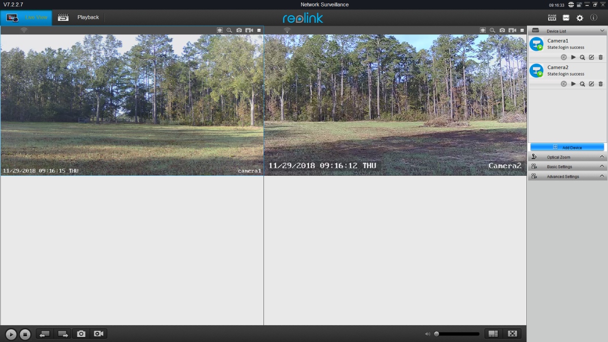

dragoneggs, I don't know anything about Blue Iris but try logging into the camera from your internet browser. Just enter the ip in the address bar and use the default name and password if you haven't changed it.
My Reolink cameras have a built-in interface I can access via web browser. I use the gear symbol at upper right to open the camera settings panel. There you can change all the camera parameters.
The software that was designed for and supplied with the cameras works okay but for some reason the browser interface is a little more stable. Probably because it only sees one camera at a time in it's window. You can open each individual camera in different tabs. The software supplied will see all the cameras on the same page in multiple windows.
Here is a screenshot of the windows software. Not sure how the Mac version looks.
