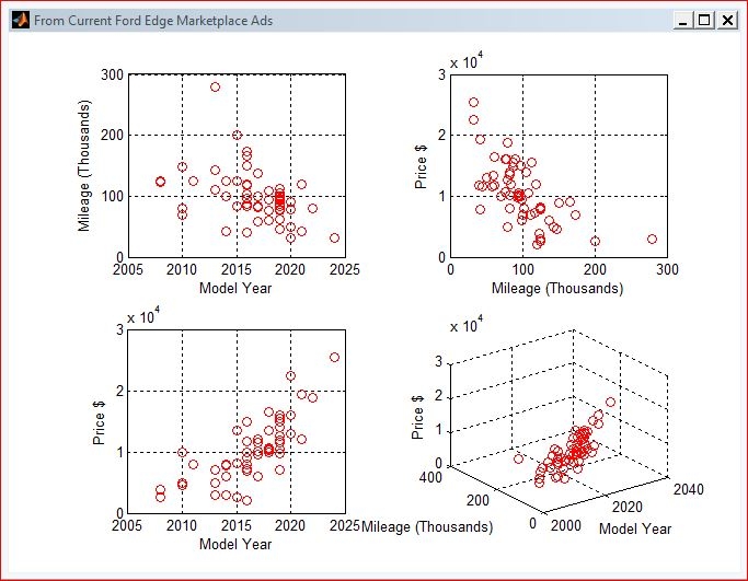

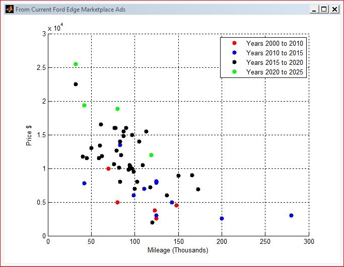

I use an engineering & scientific program tool (Matlab) to process, retrieve & store records into an Access database. Matlab has a Databas toolbox that lets me interact with Excel and Access via a GUI interface that is remarkably simple to construct using the Matlab GUI builder. This has served me well for analyzing data for statistical, prediction, model fitting, and graphical analysis. Whatever you choose, a 'relational' database is what you want so you can add new fields at any time without redesigning the whole project.
All this in about 15 lines of code using FB marketplace data.
