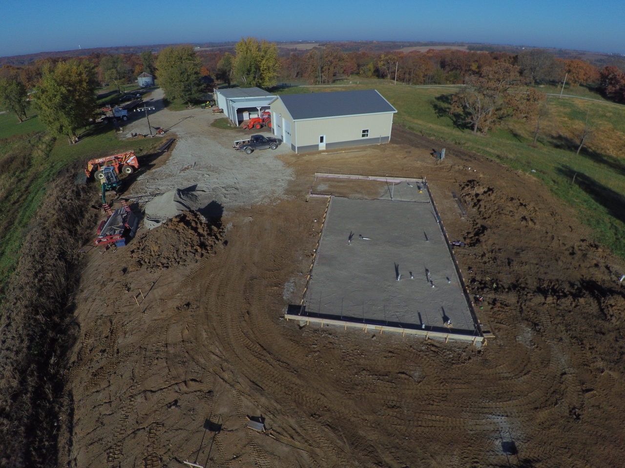

I'll have wireless Internet at the location. Based out of the house. Shop in close proximity. I think I want a camera on the front of the shop. Another on the front of the house. Maybe one inside the two buildings as well??
I could easily bury wire no farther apart than the two structures are but would prefer WiFi if it works good.
Here's a pic of the area as it is today for an idea of distance. It's 40ft from the shop to the house.

You may be better off to bury wire and then put another router in the shop and use the Wifi from it will give you a better signal and would probably reach your other building in the picture as well that way!! Especially if the shop is a metal building can't tell for sure..my $.02

I'll have wireless Internet at the location. Based out of the house. I could easily bury wire no farther apart than the two structures areView attachment 578451
A hard wired camera is always preferable and works better than one over wi-fi. If it's easy to run a cable (relatively), pull cable. If you do that I'd put in a conduit for future runs.
My distance from house to barn is greater, and crosses unmarked utilities. So I went wireless because of that. Not so between my garage and barn- I installed conduit and wire for that.
