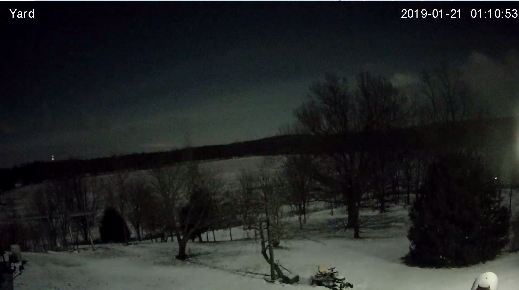

/ Camera Security Systems??? #245
A little snow, a full moon, a low light camera and .... presto ... near daylight at 1AM:
#247
I didn't know you had trees where you live?
Where is that anyway?
