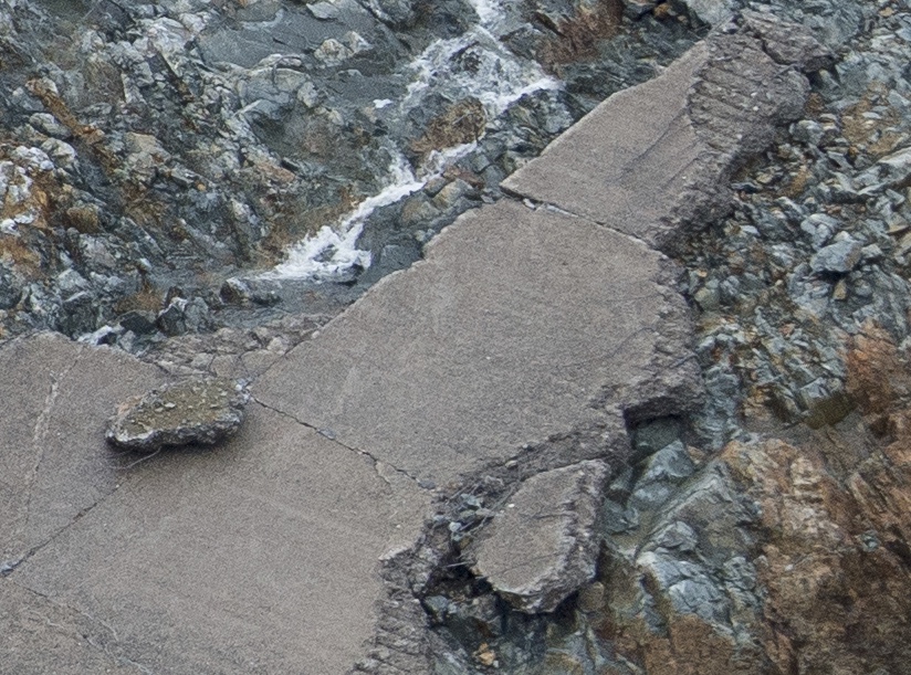

No limestone.
Take a look at the photo above. It comes from the Metabunk web site, about half way down the cited page. It shows the bottom of the hole in the spillway after the first time DWR stopped the water flow. The stone is gray, not green, like the serpentine in this area. To me, that makes it limestone. I say this for a few reasons:
I live on the bank of the West Branch of the Feather River, upstream from the dam site, and both green serpentine and limestone can be found in abundance under my property. Bands of these limestone outcroppings can be observed in the canyon wall from the bridge that crosses the West Branch a few miles closer to the dam than my home. A marina nearby is named Lime Saddle, and back in the '20s limestone was mined and converted to cement in kilns that can still be found downslope from my property. Unfortunately, my well is drilled into that limestone, and as a result the harness of the water is very high.
When the serpentine around here gets wet, it turns dark green. Since the photo was taken shortly after the water was shut off, it is reasonable to conclude that the rock shown is wet. Another photo located closer to the top of that same Metabunk page shows water dripping off the broken spillway concrete and two workers in the hole, one of them in full raingear. The rock in both photos does not show the dark green color that is characteristic of the serpentine in this area. It's gray, same as the limestone on the canyon wall when it gets wet. It's been wet a lot this winter, and I pass over that bridge and look at it every time I head into town.
Very likely there is serpentine in the area that the dam was built, but I don't see any in the photo. It's limestone.
Somewhere is a geologic survey map of the Oroville Dam area, but I've been unable to find it online. I did find one for the Auburn Dam, and areas of serpentine are clearly marked.
But what difference does it make what the rock is for the purposes of this discussion? The original concern was that the spillway was built on earth fill, which would rapidly erode back to the reservoir once the concrete broke. That is clearly not the case, so perhaps we can come to agreement over that and move on?
Agree.
The spillway isn't on earth fill, its on rock that didn't erode when the Feather River cut down and made its canyon.
That photo looks to me like ancient laminated something, with white (quartz?) intrusion. I too looked for geology info before posting, found nothing.

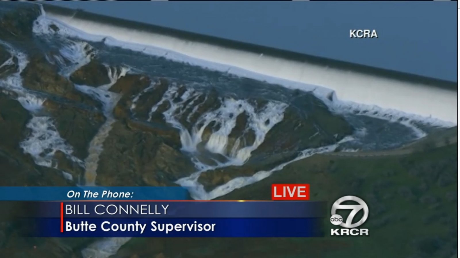

Looks like the emergency spillway is eroding and could fail (causing the top 30 feet of the emergency spillway to fail). An evacuation has been ordered for areas directly downstream.
Due to the rock outcropping under the emergency spillway, this cannot cause the dam itself to fail, but dropping 30' at once will not be good.

The regular spillway problems are no big deal. Yes, there will be more damage to it if they keep using it, and it is severely damaged, but they must keep using it and it's failure doesn't threaten the dam.
The bigger issue is the emergency spillway. As the water pours over the top it erodes the sloping hillside that the water pours onto. The parking lot next to the emergency spillway is also overflowing down the same hill.
The cascade of water is cutting deeply into the dirt slope and the cut is undercutting backward and upward toward the emergency spillway. It appears to be just mountain dirt. If this undercutting undermines the emergency spillway, it will fail and open up a port to the lake from underneath. Then the erosion from lake water will cut a channel that will begin to drain the lake. That will be uncontrollable and devastating.
They are currently sandbagging (with some kind of giant bags filled with rocks) the undercut to try to stop it as the regular spillway is open for business and getting the emergency overflow stopped.
No big deal how much damage occurs to the regular spillway as long as it can lower the lake level and I read they have increased the flow to about 100,000 cfs to do just that.
Early on in the regular spillway failure, there was a lot of mud being scoured out and flowing down into the river. Then the water cleared up and they announced the cut had reached "bedrock". Whatever that material is, it's not just soft dirt and it's much harder to cut. That's reassuring and will allow them to open the gates for max flow to save the emergency spillway from being undercut.
Overall, it's a poor design where an overflow can cut soft ground and lead to a catastrophic failure.
If there is a major failure it probably won't be for another week or two. By then everyone will be back in town!
This is going to be a very expensive re-design and fix. The scale of it is really impressive. That spillway looks small in pictures, but it is huge in person.
