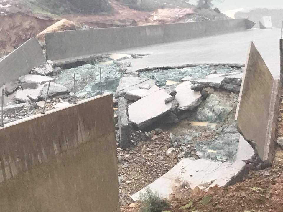

Relax, Oroville Dam isn't failing, only the overflow spillway next to the dam. The concrete spillway is disintegrating and soil beneath the spillway is eroding a few feet down to bedrock but it can't erode that. None of this affects the primary dam.
Beyond that concrete spillway, when the dam was built they leveled an area for an Emergency Spillway that is at lower elevation than the primary Oroville Dam. If the reservoir reaches capacity, water will overtop that and it will dump a broad sheet of water down a native hillside.
The forecast this morning is the rain has ended and the reservoir is no longer rising, so that emergency spillway is not likely to be used.
The real consequence here is a huge amount of erosion debris in the channel below the dam and headed down to the fish hatchery below. F&G is presently trucking the salmon over to another hatchery. Aside from that, downstream consequences should be minimal.

The main spillway is damaged, that's all:
They've continued to release water down the spillway since that photo was taken, and the hole is much larger as a result, and the concrete continues to erode down the spillway. I've been watching the KRCR-TV web site for info, and they seem to be posting pretty much in real time.

The concrete of the spillway was bad and it eroded from the top down. As I understand it there are pictures of trucks parked in that spot and people inspecting that section or within 50 feet of that section back in 2015.

The lake was dry in 2015, no water had ever gone over emergency spillway since 1968.

This photo was taken yesterday morning when the spillway was shut down for inspection. It shows the exposed bedrock below the concrete, and I think I can make out some rebar in the concrete. Keep in mind you're looking across about 200' of material, 2/3 of a football field, so small details like rebar are gonna be difficult to see. Easy to understand that the water will continue to undercut the spillway concrete, but once it reaches rock it's not gonna go very much deeper.
