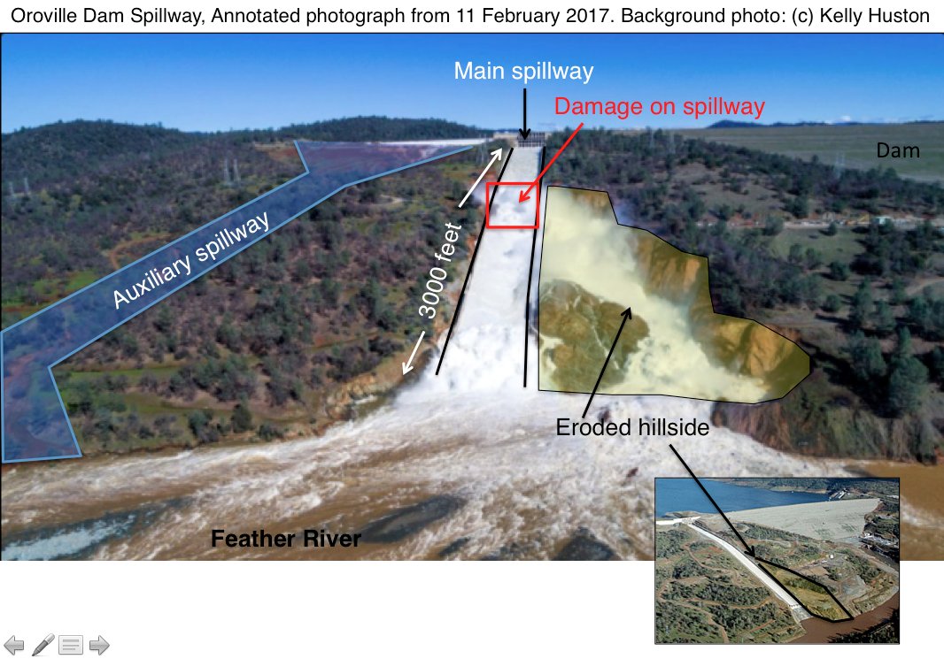

Let me repost a picture showing where things sit:
Picture of the whole area with some good markings of where everything is to give some perspective:
Source: Twitter
Even if both spillways blow out, there is still a large shoulder with rock underneath that it has to get around before it can eat into the dam itself.

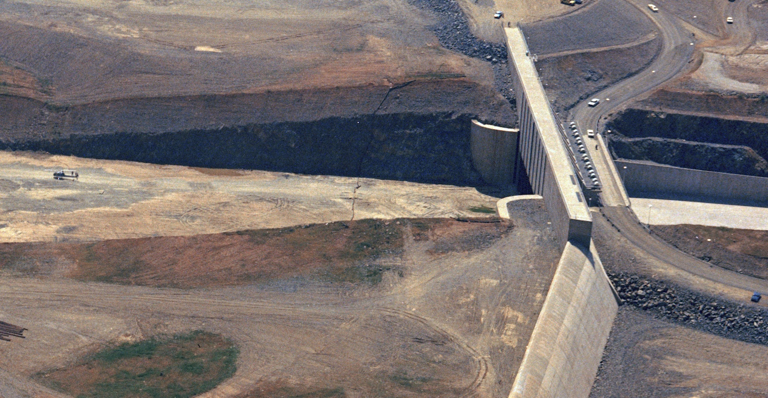

In this picture, you can see the rock lining the side of the main spillway:
Source: Oroville Dam Spillway Failure | Page 7 | Metabunk
The evacuation was in case the emergency spillway blew out as they were getting undercutting that was getting close to the base of the emergency spillway.

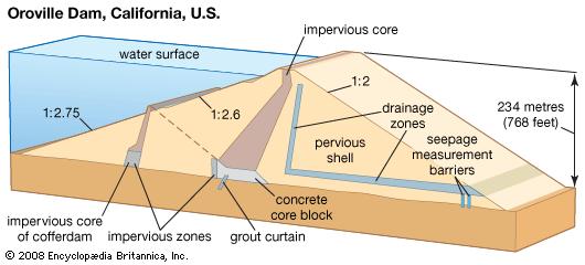

Here is a cross section of the Oroville Dam which is one of the highest embankment dams in the world. Until 1980 or so it was the highest in the world. The so called impervious core bit that is supposed to hold the water back is simply compacted clay.

The spillway is NEXT to the dam, NOT ON the dam. The area that the spillways are in is a shoulder of rock. That is why they built it there
If you look at the main spillway, it has scoured out the clay and the reclaimed tailings that they used for fill and the area is down to rock (other than the corners of the bottom end of the upper spillway which are still eroding uphill a little), this can be seen by comparing the reddish flume coming off the main spillway for the first day or two to the white flume coming off now.
See Oroville Dam Spillway Failure | Page 3 | Metabunk for comparison pictures.
The emergency spillway is 20 feet lower than the top of the actual dam, it is not likely that there will be enough water to fill the lake to where it over tops the emergency spillway by 20 feet.

Wrong, the spillway is on and is a part of the dam. That concrete bit to the right of the spillway is just the concrete bit for the power house etc. Earthen dam flanks that part of the dam on each side.
Ummm, the power house is way down the hill at the bottom of the dam (it appears that it is even on the other side of the Feather river). Nowhere near the spillway.
Here is a graphic showing where things are:
498709d1487039586-california-drought-spillway0212-jpg
Source: Compromised Oroville Dam Auxiliary Spillway Leads To Mass Evacuation: SFist
The main spillway is cut into the rock as seen in the picture I posted earlier.
For all you guys who keep repeating that the spillway is rock, why do you think that will stop the water?
Rock is one of the worse materials for holding water in a pond because of all the cracks. Rushing water over it will break it apart in time. Yosemite is an excellent example of what water does to solid rock.
What is protecting the solid rock from the rushing water? and how long will it remain solid rock?
There is clay and fill dirt/riprap/concrete (depending on where you are talking) on the lake side keeping the water out of the (mostly solid) rock. What the rock downhill from the spillway does is resist erosion. Yes, it can be worn away, no it wont hold as well as good concrete, but it will hold a lot better than dirt does.
If you follow the link in my last post, you can see where the water coming down the main spillway has cleaned the dirt out and the water coming down the hill is white (no mud/clay unlike the bottom of the emergency spillway).
