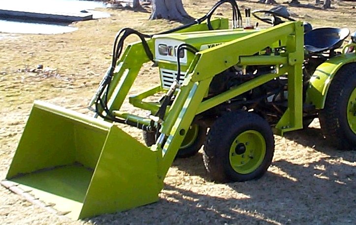

Hi,
I built a cadloader for my Yanmar (model 907 I think). I love it, building it was a blast and it is surprisingly useful, on such a small machine.
The plans were excellent! I got the hydraulics from MetKit, and obtained steel locally.
A photo is attached.
Matt

Harry,
The only place I deviated was to design a new bucket. The plans called for a larger bucket, made with flat stock I had access to a roller, so I rolled the back ans downsized some. The smaller bucket is better suited to my tractor.
Attached is a photo of the bucket built from the plans.
Matt

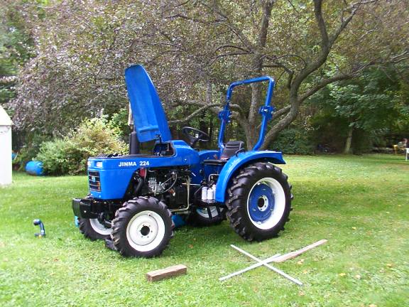

Mrbule, Nice job on your loader. I hope mine comes out as well.
Hi RWB, the 204 is a nice size machine. I'm sure you know you will have at least 20 HP or maybe a little more as the Chinese rate there units on a 12 hour test and not the 1 hour test we do. You will probobly have the equivilant of a 21 0r 22 hp. My 224 has all sorts of power actually more than I need. I was breaking it in as they suggest by pulling against an immovable object and break in the gears by "digging" the tires. Well, I found a 10" damaged Maple that I was going to take down anyway. Well I chained to it and thought something was wrong as the tires started dancing when I reliazed I was uprooting the tree. I pulled it the rest of the way down with a longer chain and dragged it away. Good move with getting the tractor first and then enlarging the shed/garage. Golden Rule-get the main toy first then make necessary adjustments. Wives just don't understand this. Good luck with your 204 and send me a pic when you get it.
I was in your neighborhood on 9/10 inspecting buses. Nice country area. I think we are going to have a rough winter so get the plows and loaders ready.
Regards, Harry g
