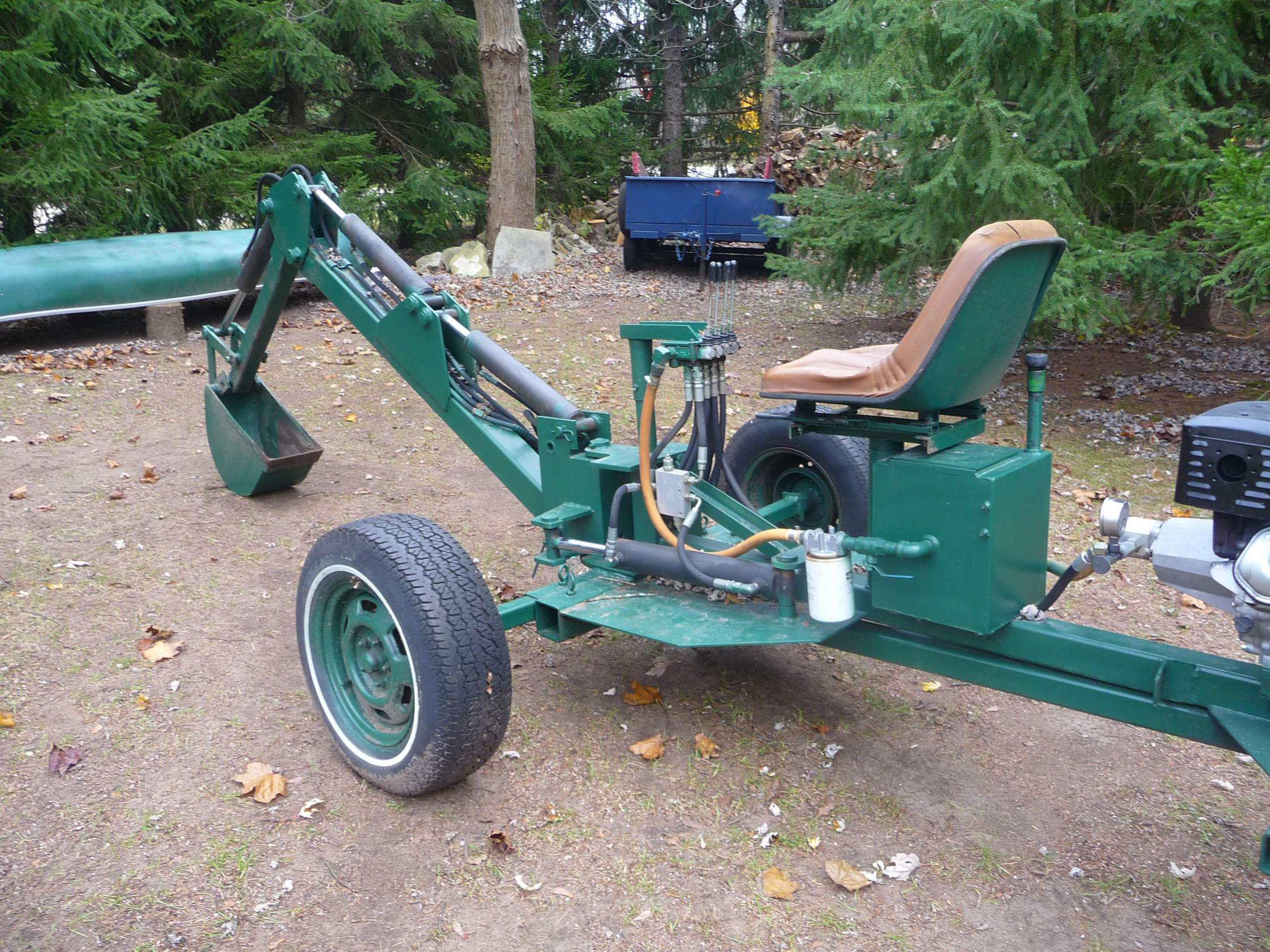

/ CadDigger 628 build #29
Here's my Caddigger 728. Shown in the towing position and with the small 9" trenching bucket. All the cylinders are the same size.
