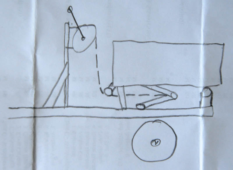

So say a 1000lb trailer with a 3000lb load would need 14*4000=56000lbs of force just to get the scissor started. Because as stated, when starting out, most of the load is not trying to lift, rather pull straight forward.
I was thinking along the same line since Army Grunt first posted pictures of the build but I thought the 3:4 block and tackle might be able to handle it. I had no idea of the actual numbers involved.
I have been thinking of building something similar but using an 1800lbs boat winch. However I thought I would connect the cable to the scissor mechanism in the way shown in my Charlie Brown sketch. I thought of putting a pulley or something like that on the front edge of the dump box so the first 12-16" of the pull is almost straight up from having the winch mounted on a post. I was going to use 2:1 block and tackle. Any thoughts?
That would be a lot better than a direct hook to the scissor and pulling in a straight line. I Acutally like that Idea a lot. It will help start the dump and open the scissors and then a much better angle is achieved before the scissors have to do all the work.
And if you plan on using a hand crank boat winch, you wont have to bend over as far to crank.
No real good way to figure the capacities without some measures though. You have to account for the measurments of the scissor mechanism itself, How long the cable is between the winch and scissor, measurments of where the contact point on the nose of the trailer is in relation to the scissor and winch, the angles of the line across that pulley, etc. Lots of variables. But that method will definatally take much less force than the previous mentioned idea.

easygo,when I first started planning this system the winch on a post was my first setup, my thinking was the cable would go around a pulley mounted on the front this would get the "start-dead pull".Than my Buddie said he would design a 3to2 block an tackle using 3" wheels. an we could power it with one of those inexpensive 12 volt winches from northern tool($50.00)So that's where we are at, the sizzors are not closed, they are at 15 degrease apart from start.It will be a few weeks till i get home to do more on it Ill post update then. later

So are you going to use the pully in the front to start the lift?? If so, I think you are going to need it.
I would still need to know the length of the scissor arms to accuratly calculate it, but assuming ~16" arm length and with the 15 degree open, roughly 13x more force is needed in a straight pull. So if you are using a 3000lb winch, (Not sure on the block and tackle but is a 3 to 2 a 5x's increase in pull??) if so, you would have 15000lbs avaliable. Divide that by 13 and you are looking at an upward dump force of only 1150lbs without the pully in the front of the trailer to start. If the scissor arms are shorter, this would be a little more, it the scissor arms are longer than 16", it woudl be even less force.

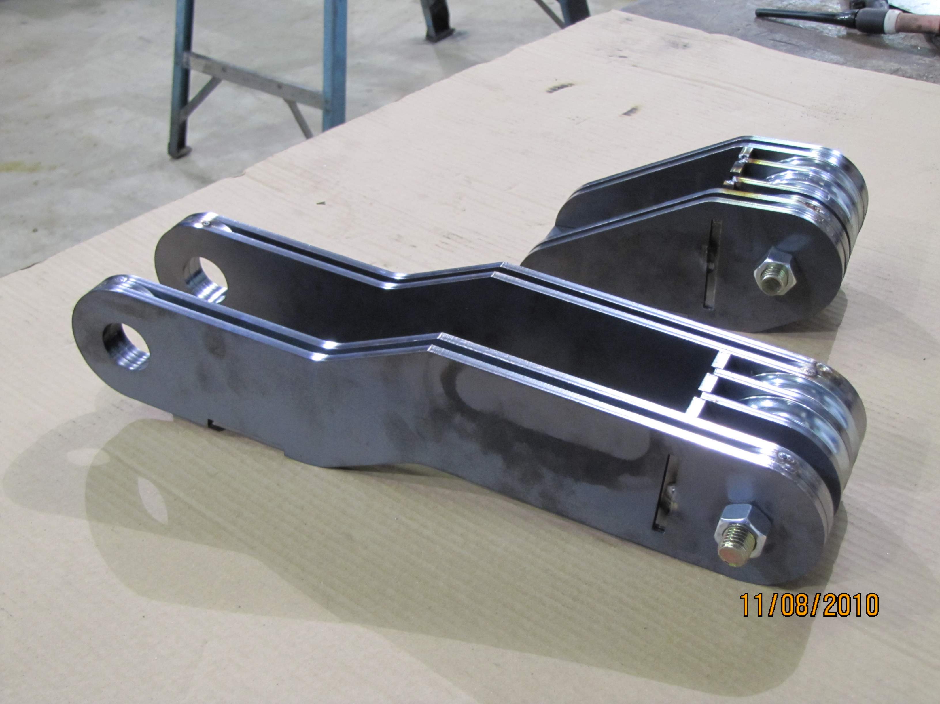

Here is a pdf file with the block&tackel my friend designed for my trailer

That looks really good, you have a good friend.
So. I assume that the shorter piece with the two pullies is going to be on the front side of the dump box and the three pullies will be on the center hinge of the scissors?
Are you going to build the hole rig or you are going to have a shop do that?

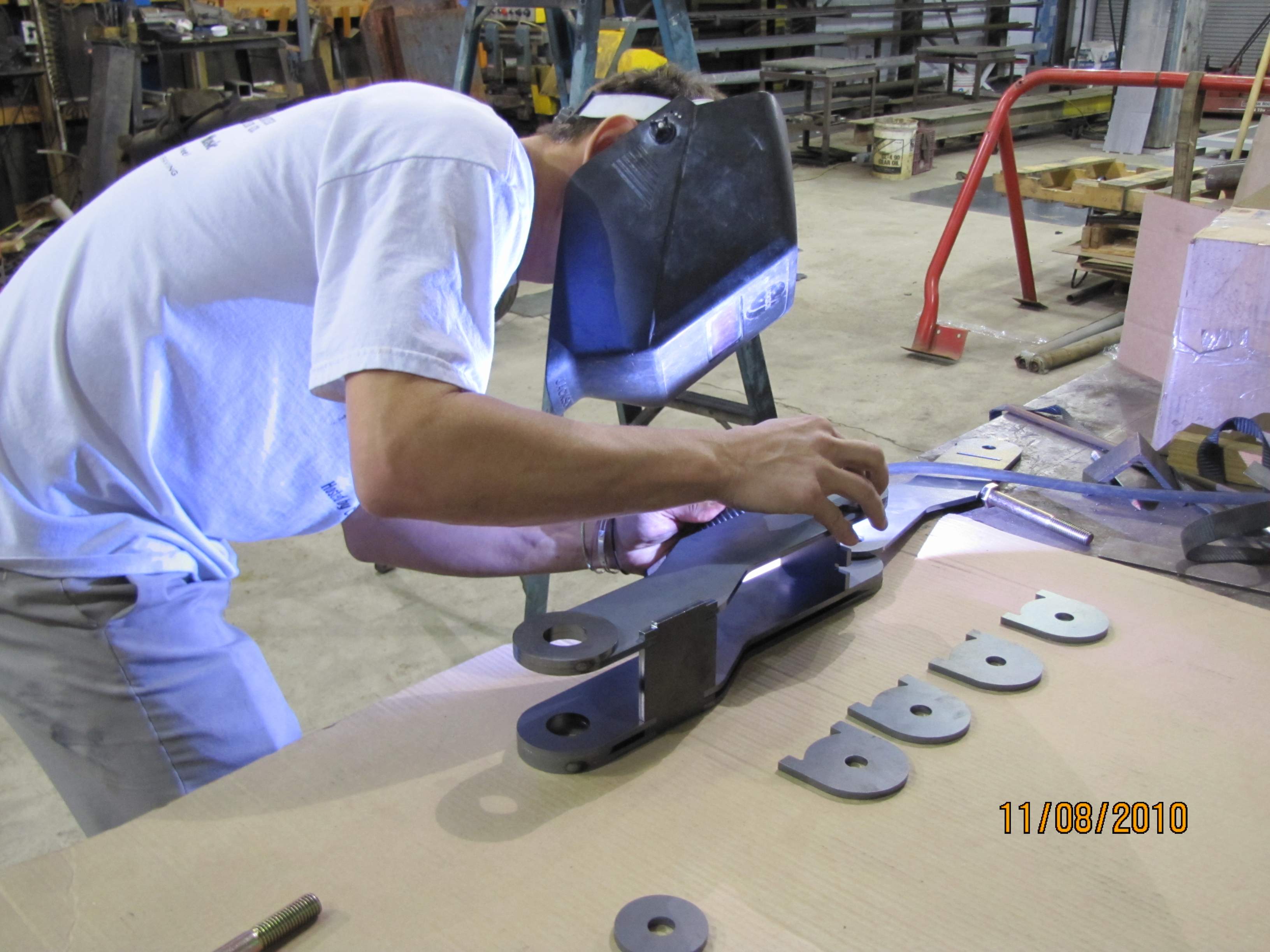

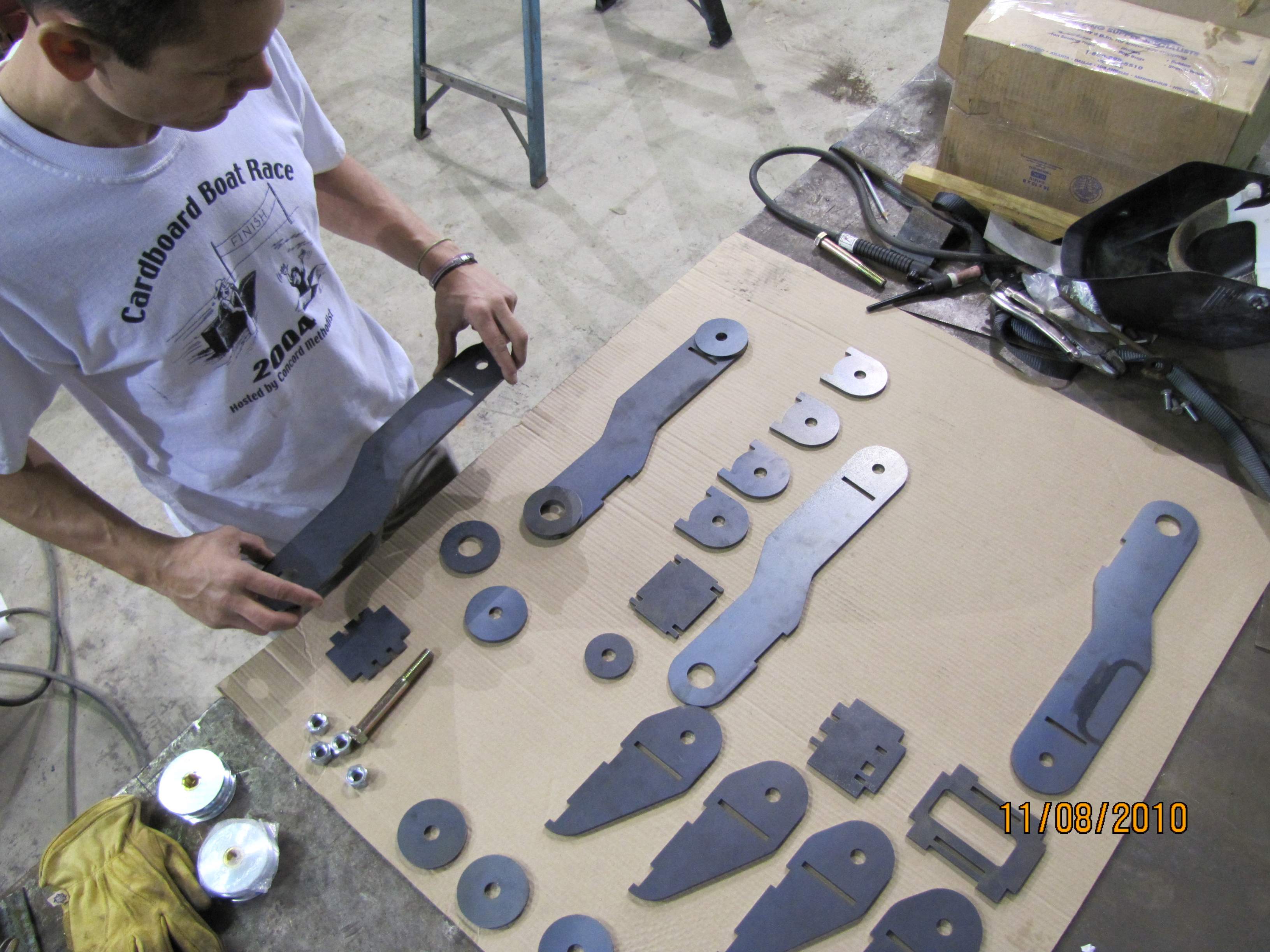

He will have it cut on a plasma cutter an ill weld it up an he will power coat it for me:)

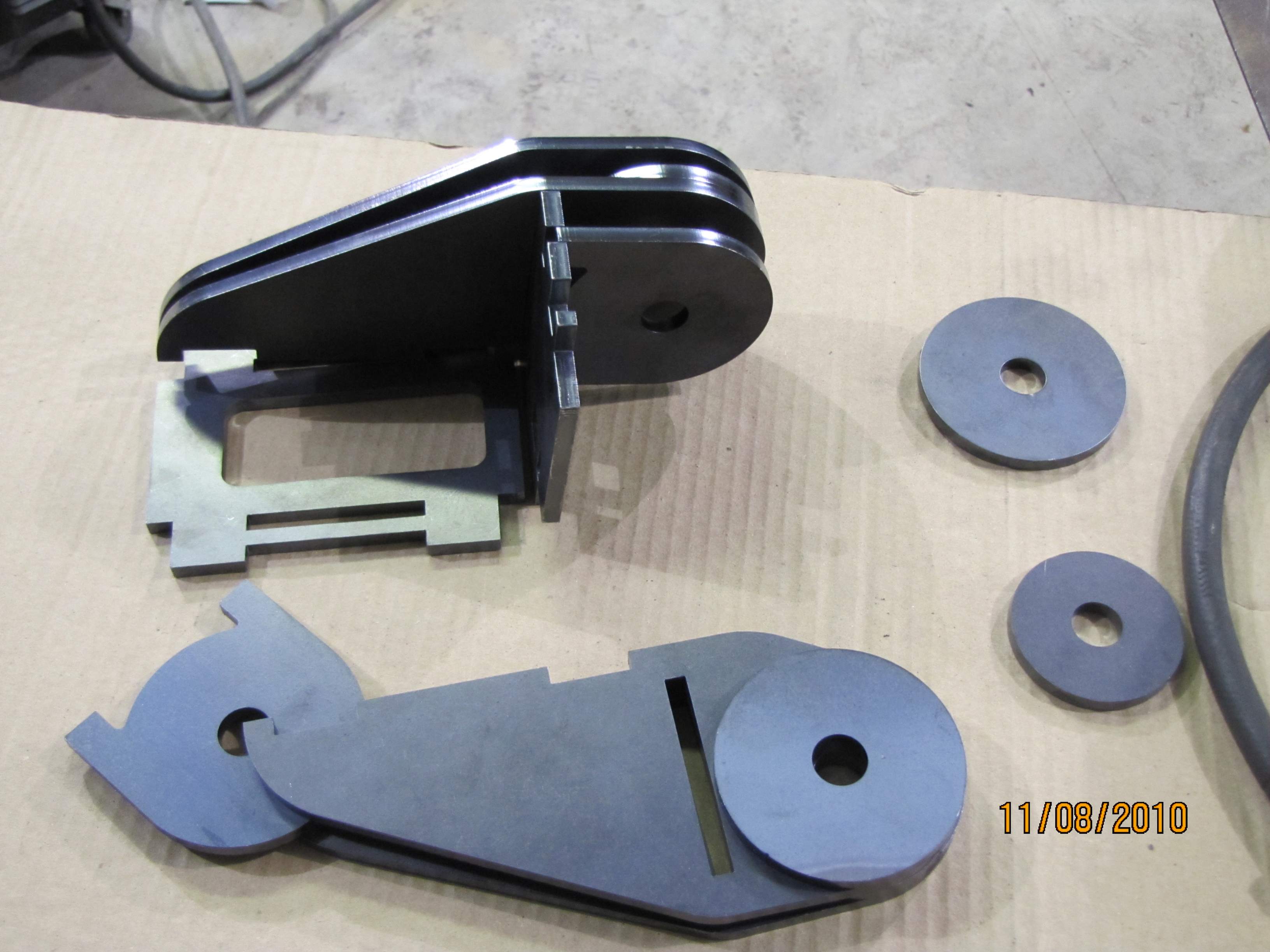

As promised, Here are a few shots of the plasma cut an assembly of the block& tackle.
Army grunt

It looks much nicer made into steel plates :thumbsup: then it was in the drawings. I'm beyond jealous and envious and all :drool:. When do you plan on mounting it on the trailer? Are going to bolt it or weld it?
/ cable operated dump trailer #40
Great looking project !
Those are incredibly clean and accurate cuts for a plasma cutter . They almost look like they were cut on a flowjet . What type of plasma cutter and table is he using ? I am curious aboutwhat brand and model plasma he used.
