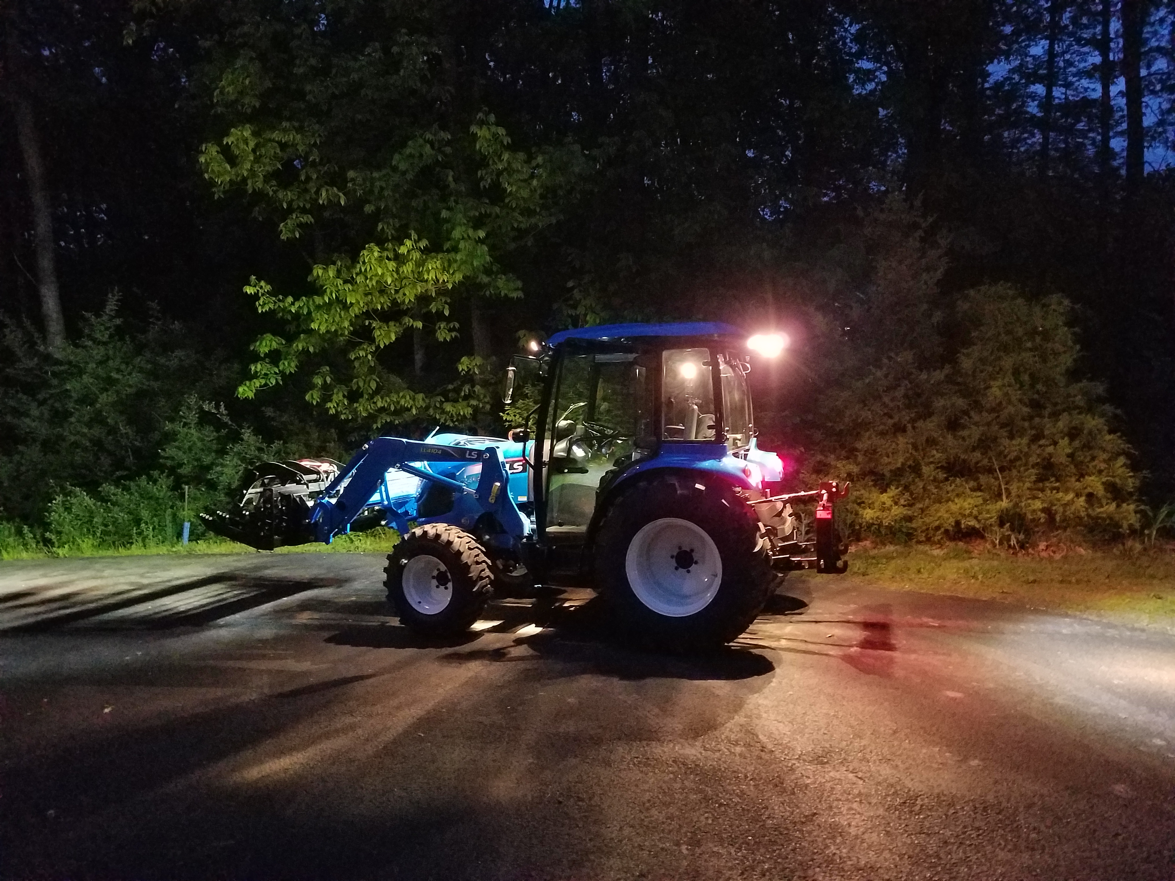

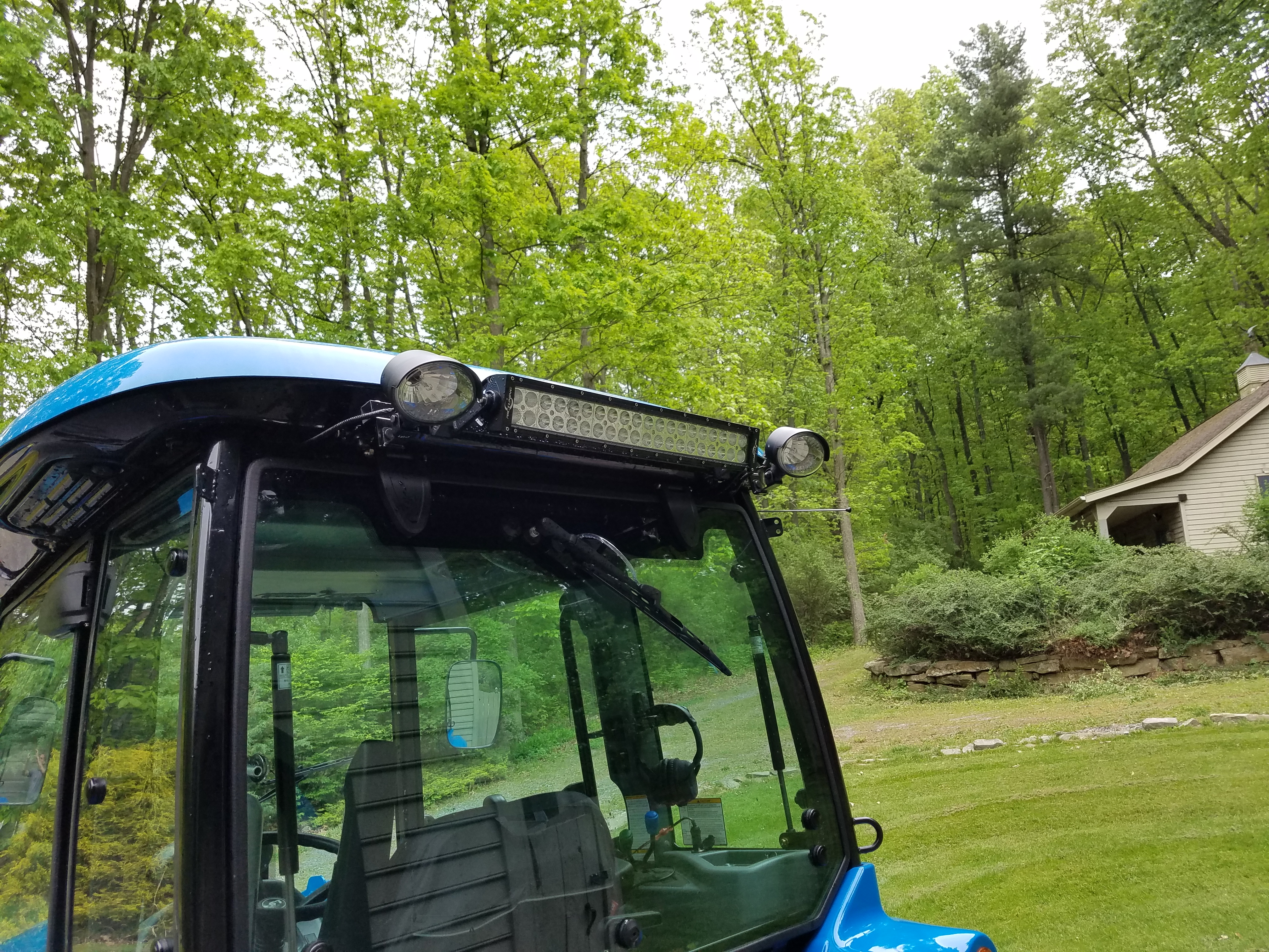

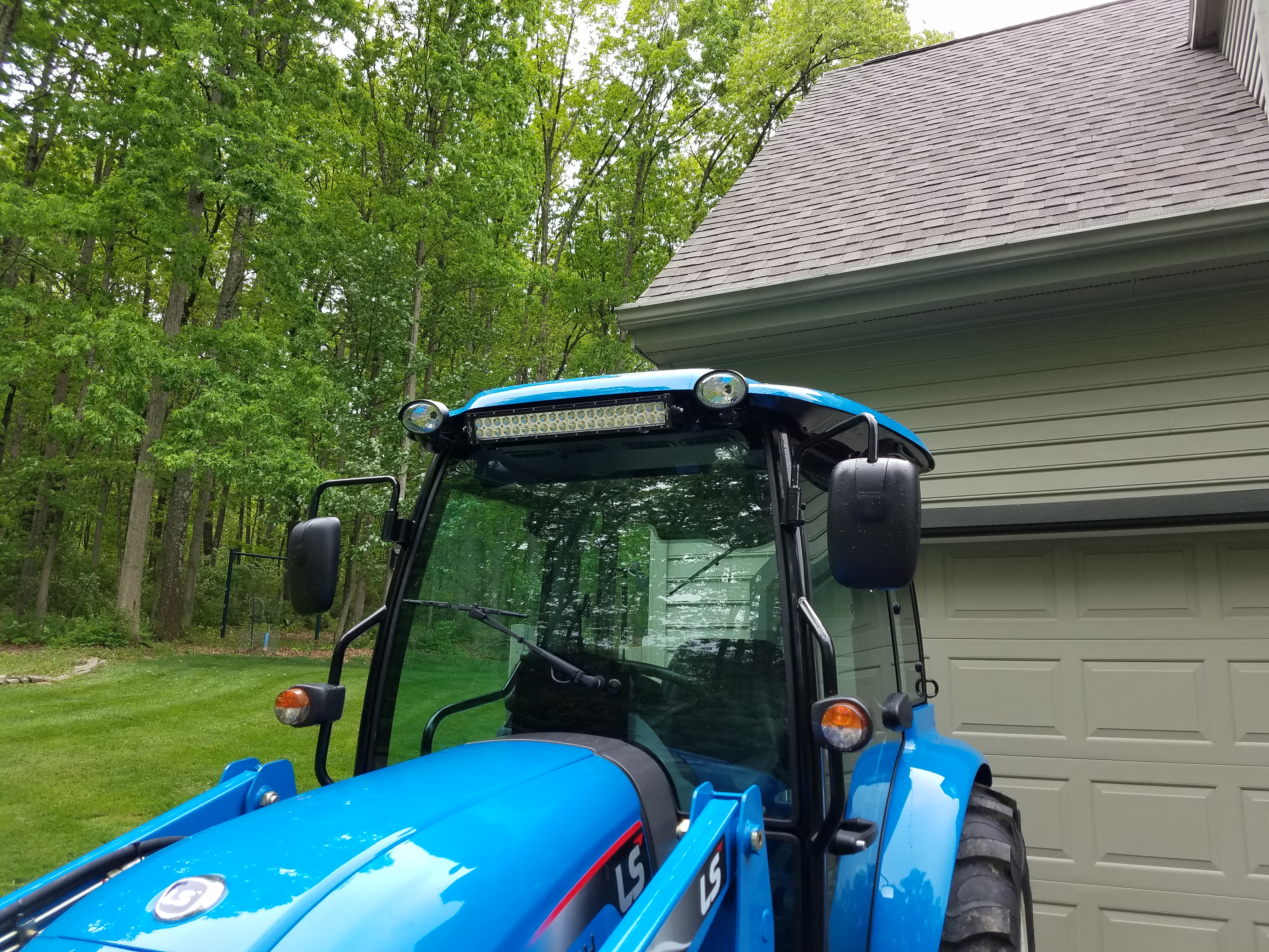

I installed a piece of square tubing between the existing work light brackets for LED strip lights. I left the factory work lights in place and wired the on/off control for new strip lights to the existing work light switches using a relay. For powering the new lights, I tapped into the fuse block on the left inside column of the cab. I used LED light strips from Amazon. They seem to be holding up okay and put out plenty of light. 2017-05-21 17.02.33.jpg2017-05-21 17.02.43.jpg2017-05-21 20.52.08.jpg
