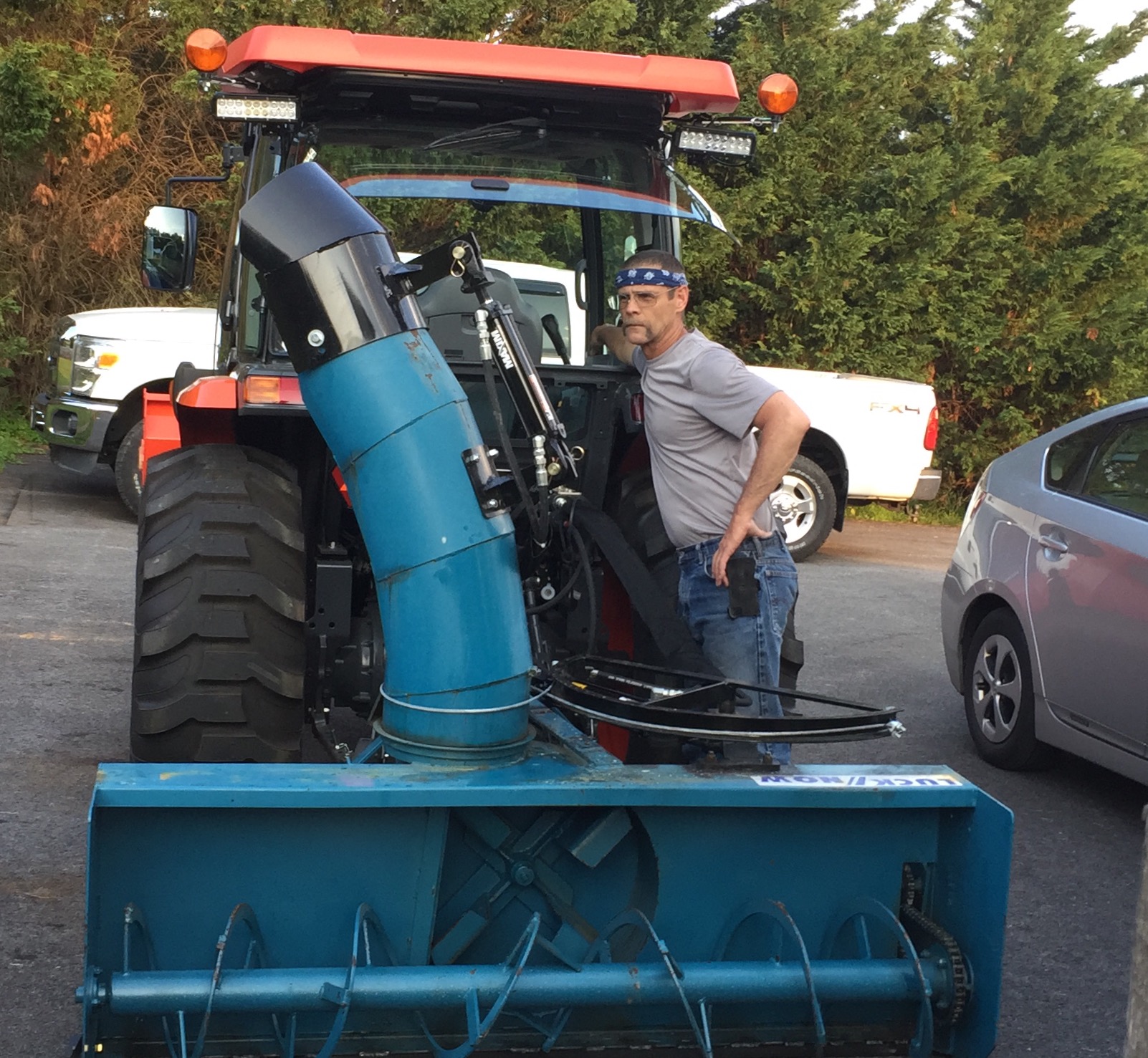

I also have been out in the elements for enough years, and moved up to a cab this spring. I spec'd front and rear wipers and a rear defroster. Most of the YouTube videos I have seen with cabbed snowblowers the glass is just wet and the operator is wearing light clothing. I suspect the heater keeps the glass clear of ice and snow for the most part. We'll see this winter. I will add that with my added front and rear lights (220w total) the defroster pushes the charging system over its ability. I should have ordered the higher capacity alternator (from 60a to 90a in my case).
I also had to add hydraulic chute control to my manual blower.
