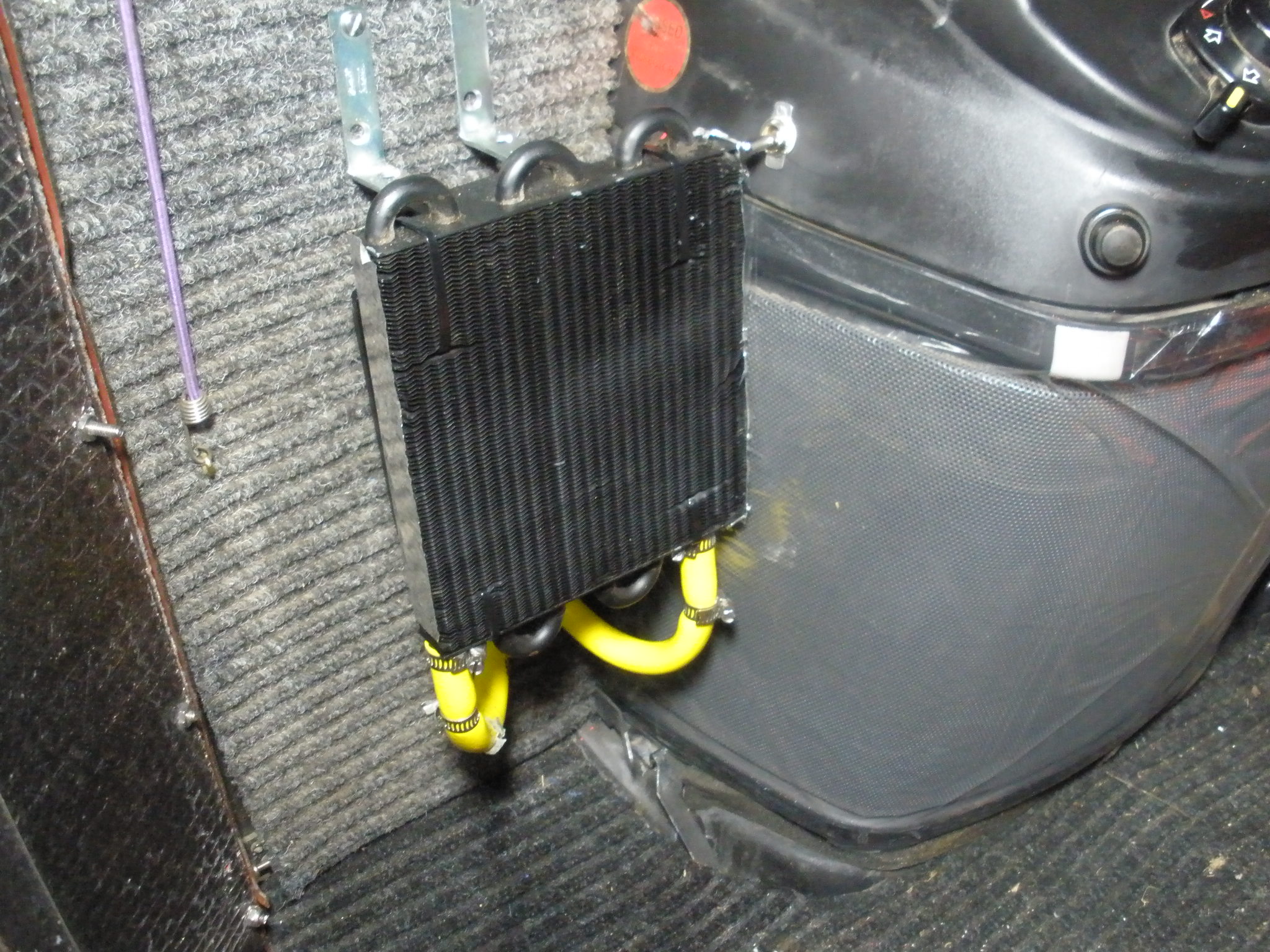

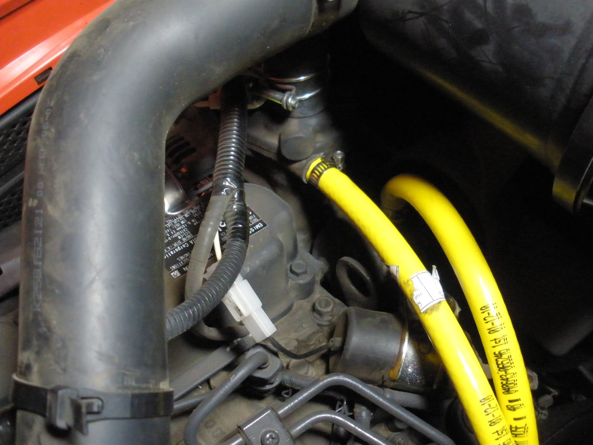

I installed this heater in my cab heater coil.JPG tapped into the bypass hose by pass hose.JPG installed a 4" 12v fan behind the core. Keeps the cab 40 dg warmer than the outside temp. Had the core, fan an switch hose $20.00 total.

Nice picture jb62901, you have a nice shot of the thermostat housing.
What type of coolant hose did you install, I've not seen this around my neck of the woods.

D W I got the hose at Lowes have since changed it out for 3/8" heater hose. The other hose was to soft.
