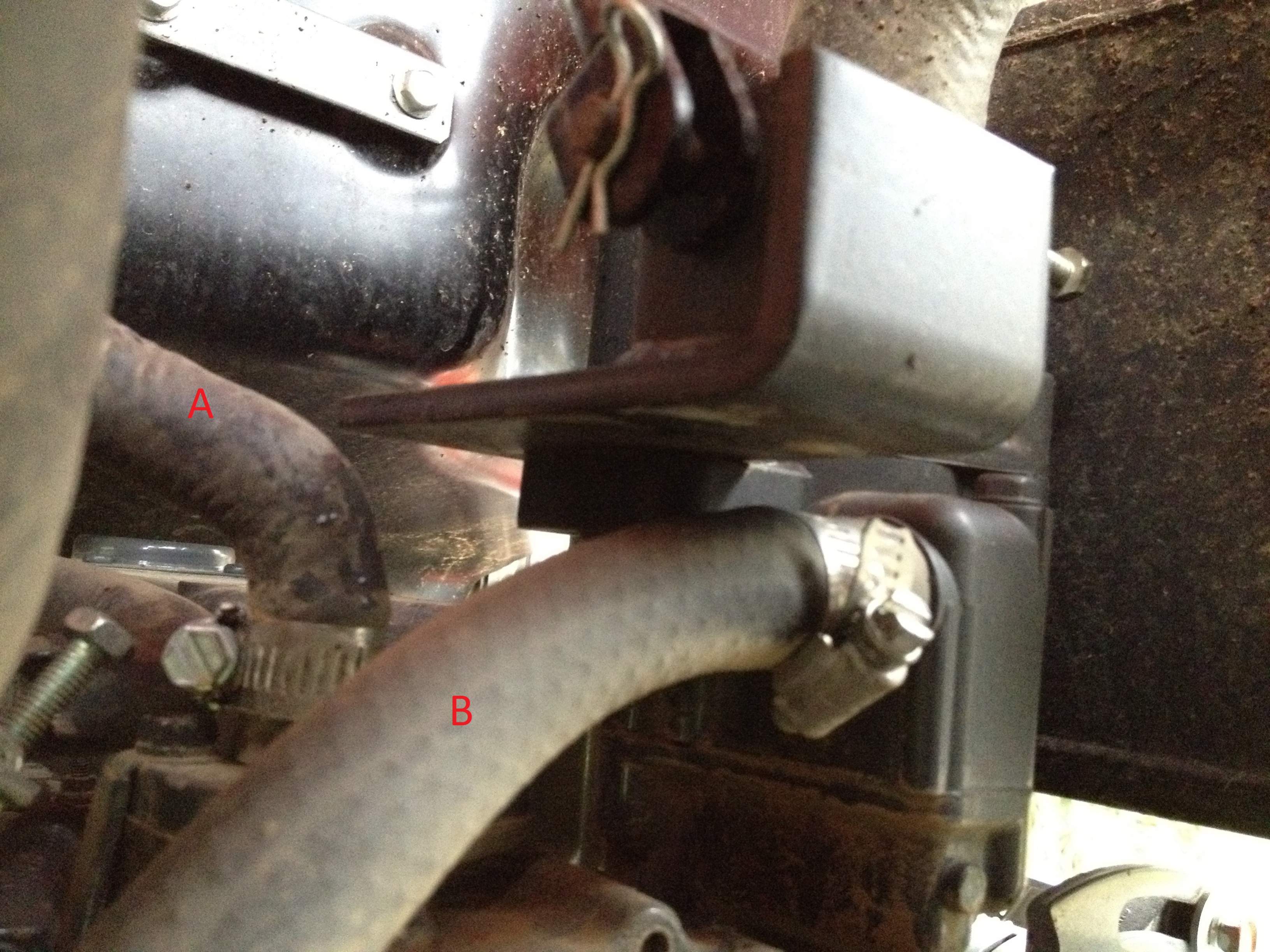

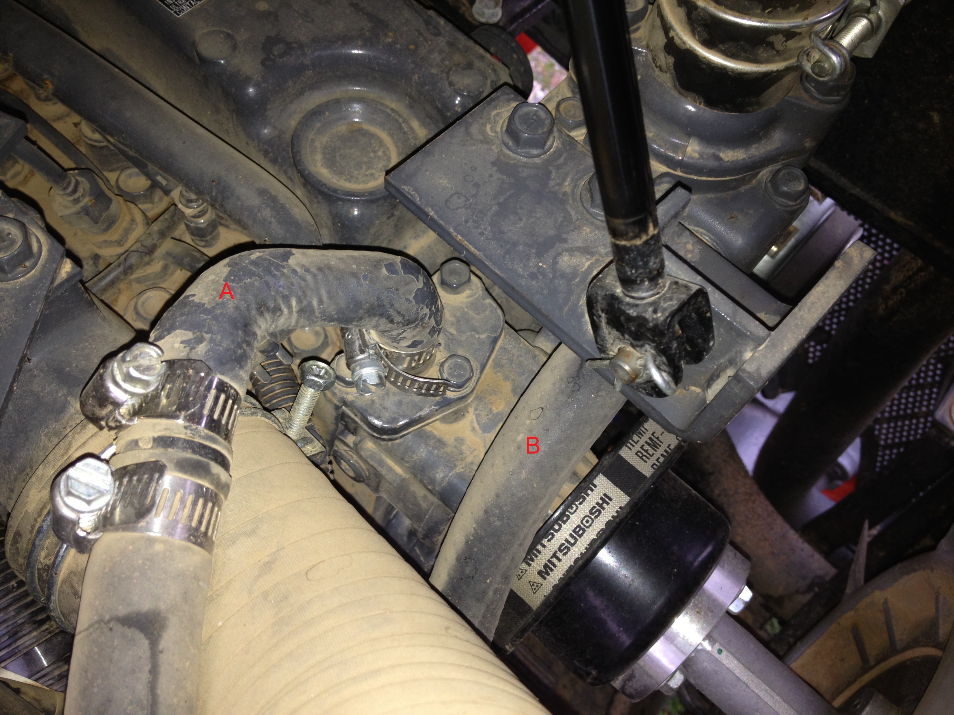

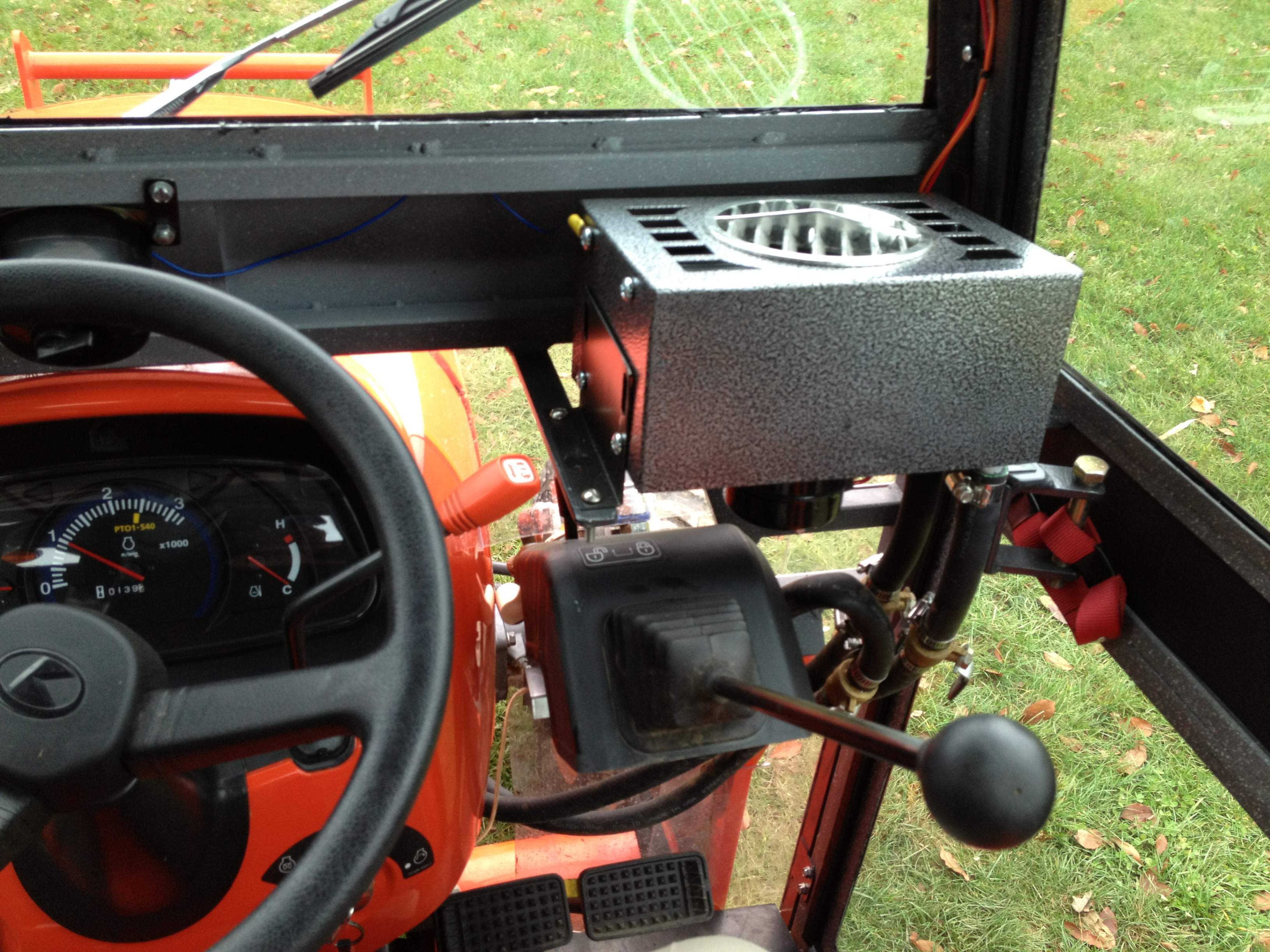

I'm glad someone else has the heater. Can you explain how you hooked it up? I understand the principals, but do you just cut the hose before the radiator, then put a return afterwards? Any pictures would be great.

Here are some pictures of my heater and connections. The first is taken looking down at the engine. The hose marked A is a factory hose used as the bypass. It must always have flow, so the heater is plumbed with valves that direct flow either through the heater core or bypass it. The hose is roughly in the shape of a 90 degree bend and has different diameters at each end. The larger diameter is 5/8" IIRC. That allowed me to disconnect the hose and rotate it by loosening the bottom connection. An internal type of coupling was then used to connect water through valves to the one side of the heater. The fitting where the factory 90 degree hose was connected was then used to connect the other heater hose (B).
The second photo is of the heater and valves. I bought the heater on line for around $150 late in 2012. The third photo is looking into the area where the connections were made to the bypass.

Thanks for the pictures. I found the hose on mine, have to take the alternator off to do it though. Seems the price is still $150, gonna have to work hard to sell that one to the wife. She's not convinced I need the tractor, let alone the cab, and we just got a bill for $5400 from the emergency room AFTER the insurance...
