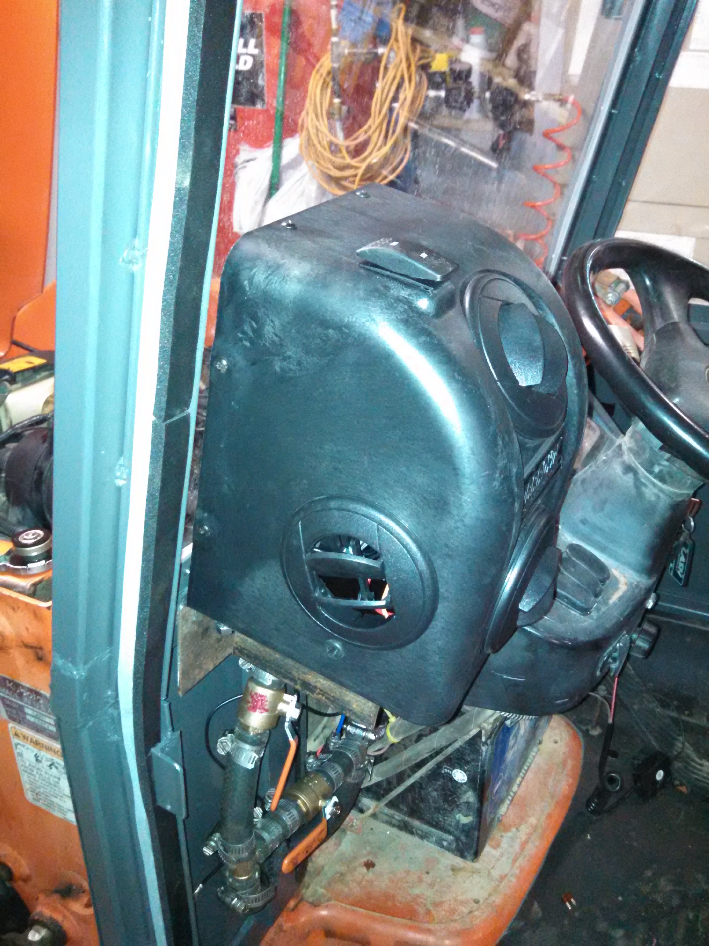

I'll try dropping the heater core down below, but logically, I'm not sure why this would be a problem. The water pressure required should be nil since it's a closed system, water up and water down. At least after all the air is blown out.
I would think that the water pressure would be high enough, from my understanding it's a water pump, bypassing the thermostat before it's open, so it should contain a fair amount of pressure. I'm not certain though.
   / Cab for the Kubota #102
It may work fine once you get all the air out, I don't know for sure. Also make sure there is a thermostat installed. Do the radiator hoses get warm?
I've come across several used tractors that people have removed the thermostat entirely.

I didn't feel the big hose but I'm assuming it's moving water since the water in the radiator does get warm. I'll take it apart and see if there's a thermostat, if there isn't that would explain why there's no water pressure in the bypass line, since there's no resistance on main line. Thermostat is $17, may just pick one up so it'll be here by the weekend assuming it's missing or failed open. Lows in the single digits for the foreseeable future anyway, but no snow to play in.

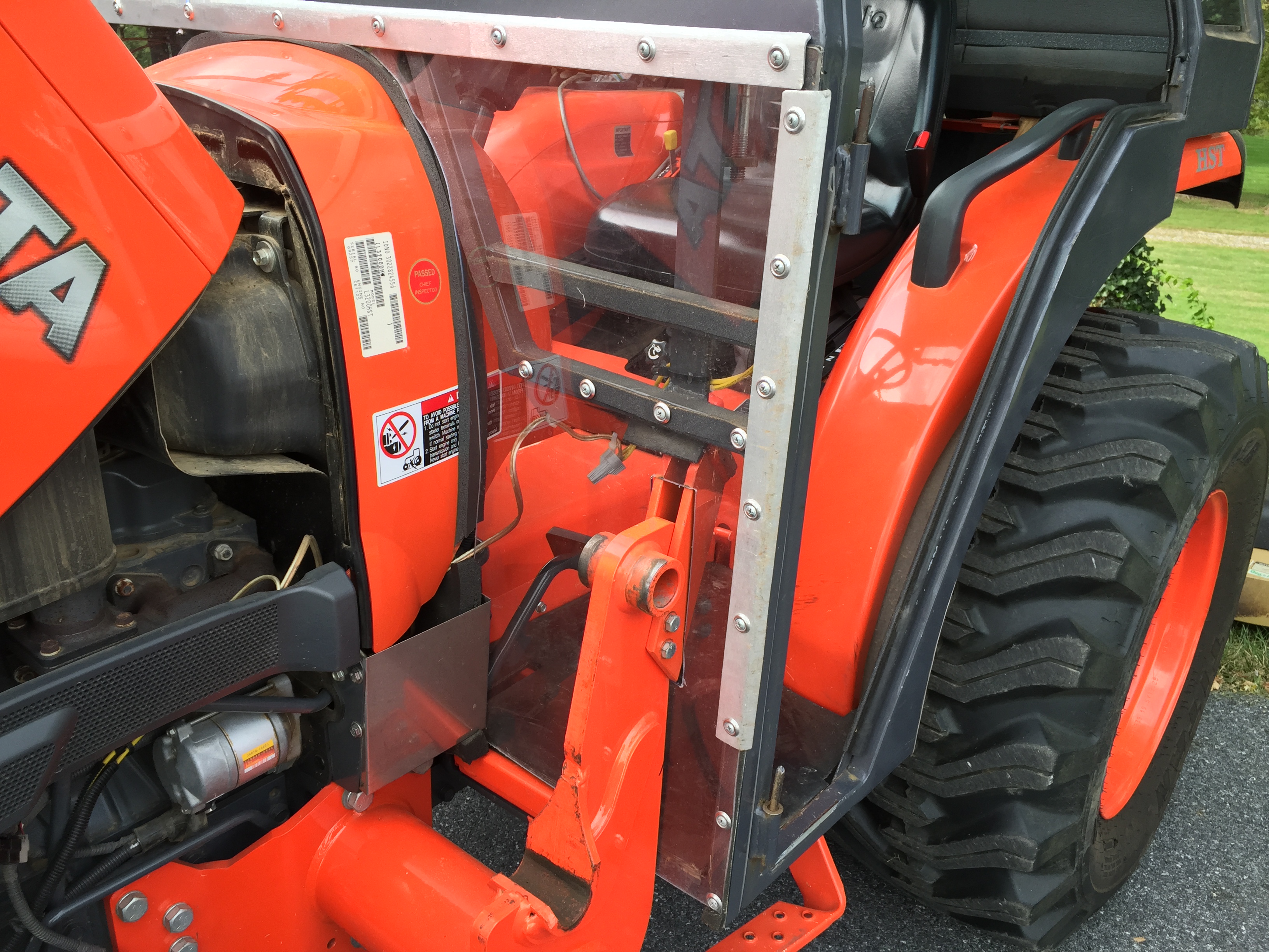

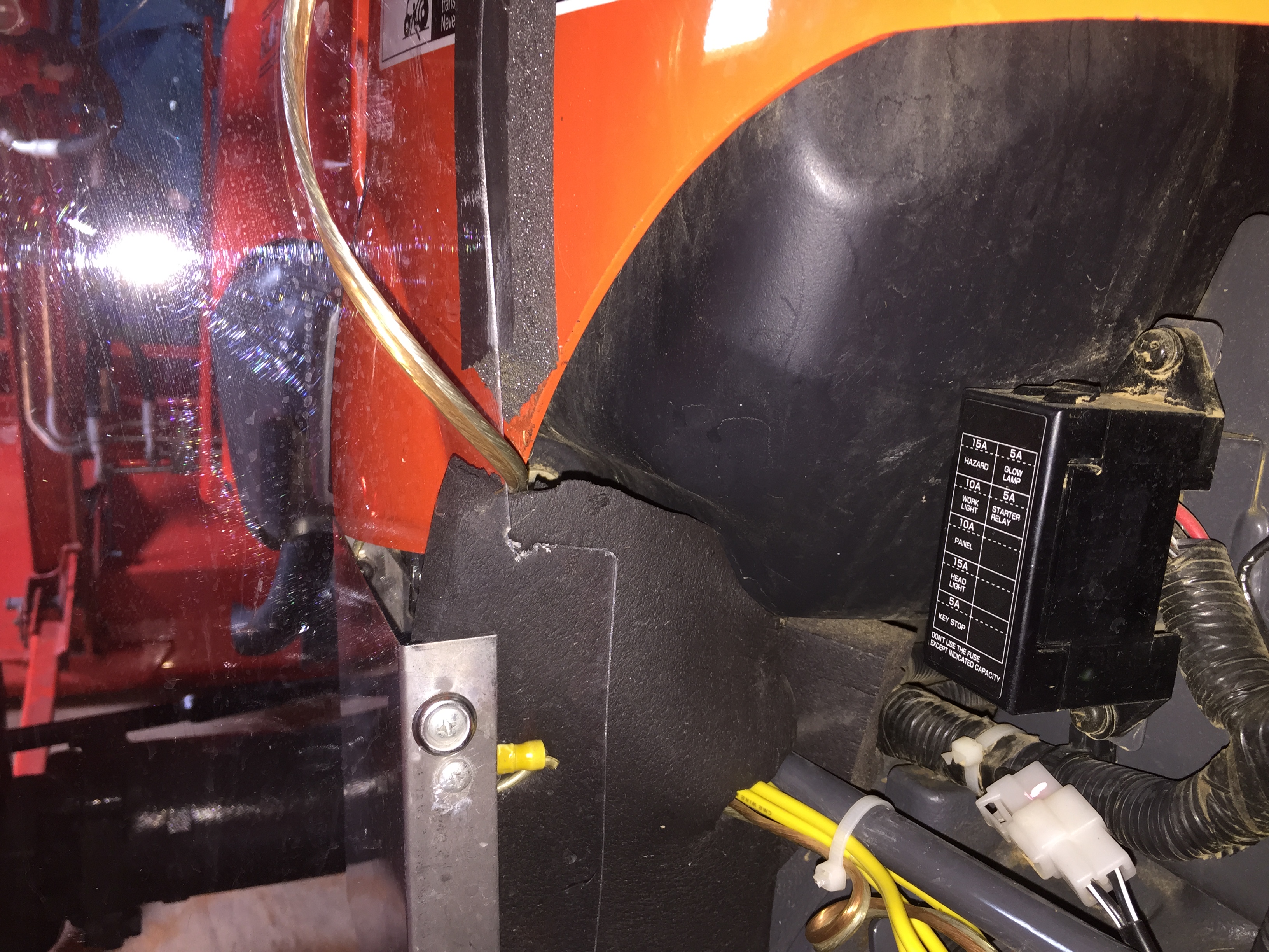

My cab didn't have too many gaps, but the front wall took some extra work. I made the initial front (below the glass) from strips of the thick plastic material used for big doors on refrigerated rooms that forklifts drive through. They had gaps and the plastic yellowed after a while.
In the pictures is the current version made of Lexan. I coped it around the body, trying to leave a 3/8" +/- gap between the Lexan and the sheet metal. Then I got some closed cell foam gasket material with adhesive on one side and stuck it on the metal. The edge of the Lexan just touches the gasket and that worked well. The hardest part was between the floor and the back of the engine compartment. Much of it was easy enough to close off with cut-out pieces of flat Armaflex. The left side was a little challenging, but adding a small piece of U-bent stainless provided a place to fasten an end of the Lexan plus hold a larger piece of Armaflex. A quick fix could be as simple as stuffing gaps with pieces of Armaflex pipe insulation.

Mine has no gaps at all except for the legs. I think some pond liner rubber is in order.
I like that a LOT. Very nice work. Great visibility. Good job!!!!

Your heater is mounted pretty high. I've only installed a couple heaters and they were mounted low in the cab below the top of the radiator so you could work the bubbles out.
To stand any chance of flowing water to your heater core, first try with the heater sitting on the ground so you can get all the air out of the system. Even then, it probably won't work very well being up that high.
I was thinking air lock also, then I saw the picture, I think it may be tough to get flow through heater core. Also thinking that you don't want to starve the cylinder head of its coolant flow. That will be nice when blowing snow on a chilly day. Good job!
