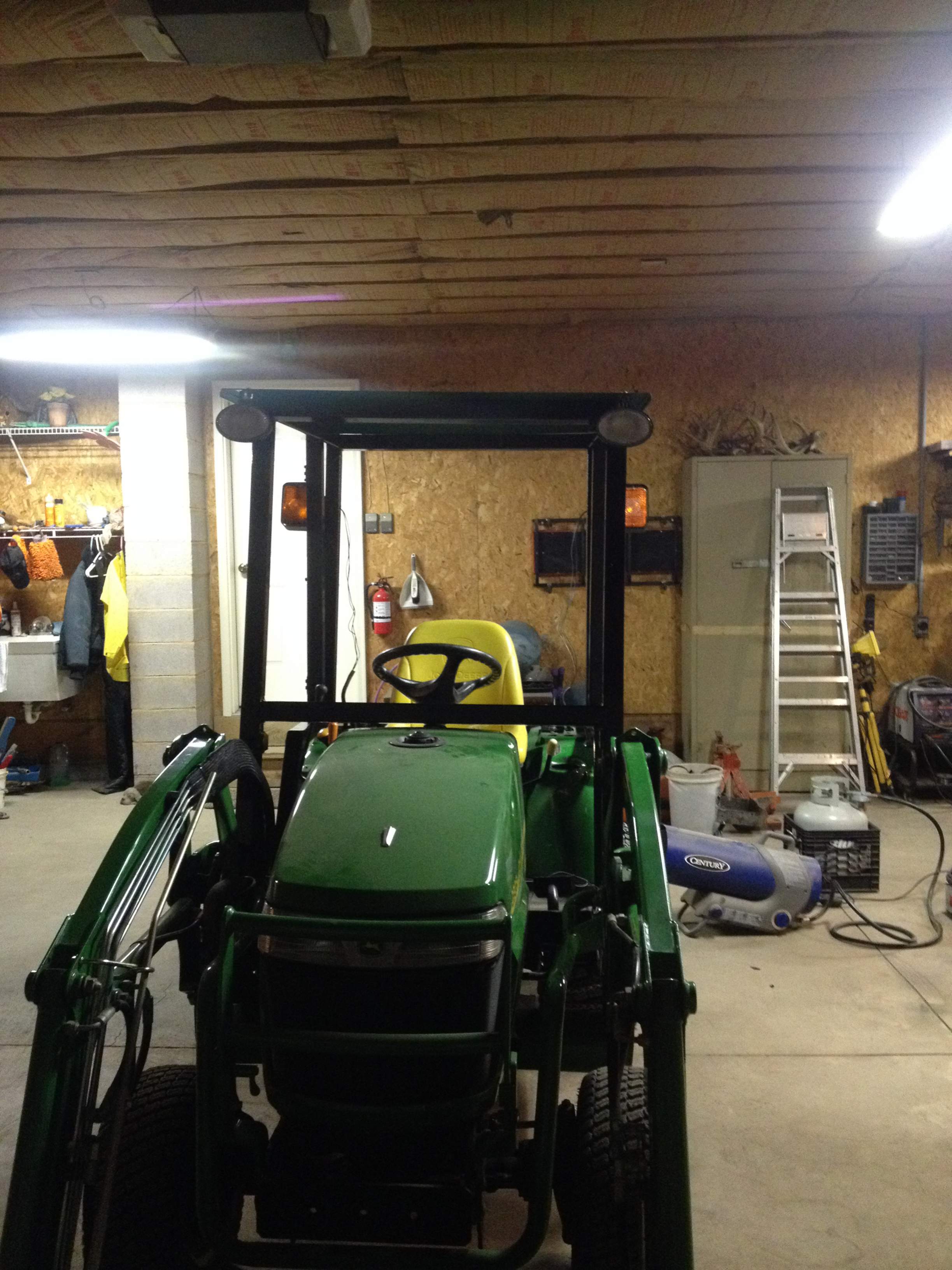

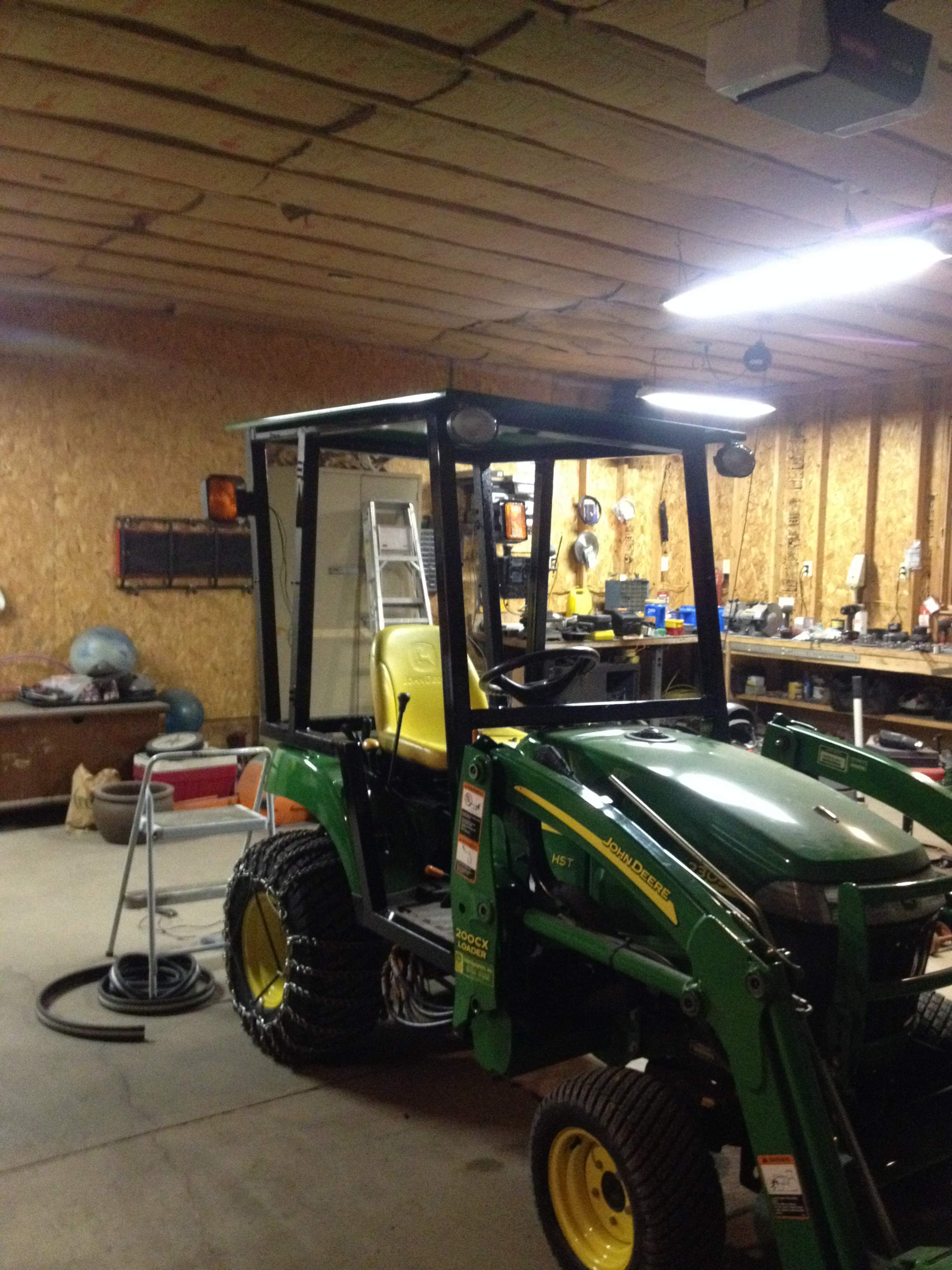

I got part of the cab back from the body shop today.

Nice looking cab. Congrats!
About 3 years ago I installed a heater in my Kubota and we are nearing the time to install one in a homebrew Montana cab at work. Both of these use the bypass connection at the stat and are piped (hosed) to the heater in an H arrangement using off the shelf components. If your tractor has a bypass like these do, it should be easy.
For heating, the engine coolant enters the bottom of the H on one side and runs straight up through the heater core and returns to the engine down through the other side of the H. There's a valve in the horizontal part of the H that is closed for heating and makes the coolant flow through the heater.
When heat isn't needed the valve in the horizontal is opened and valves in the upper part of the H are closed so the coolant flow is through the bottom half of the H only and not through the heater core.
