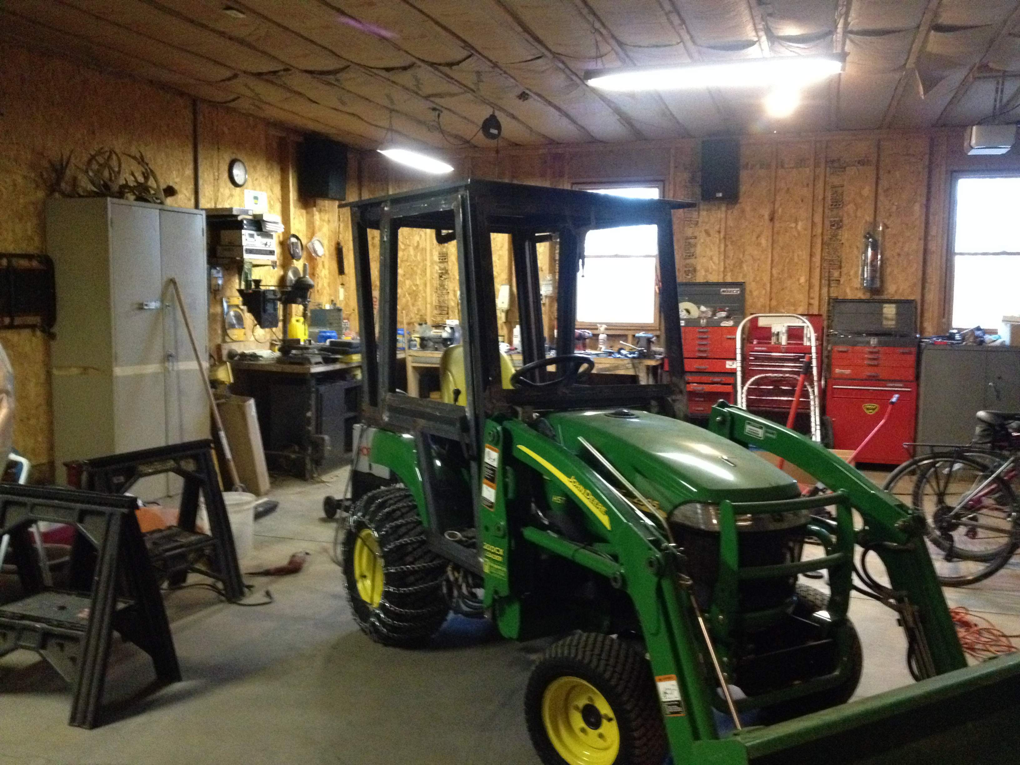

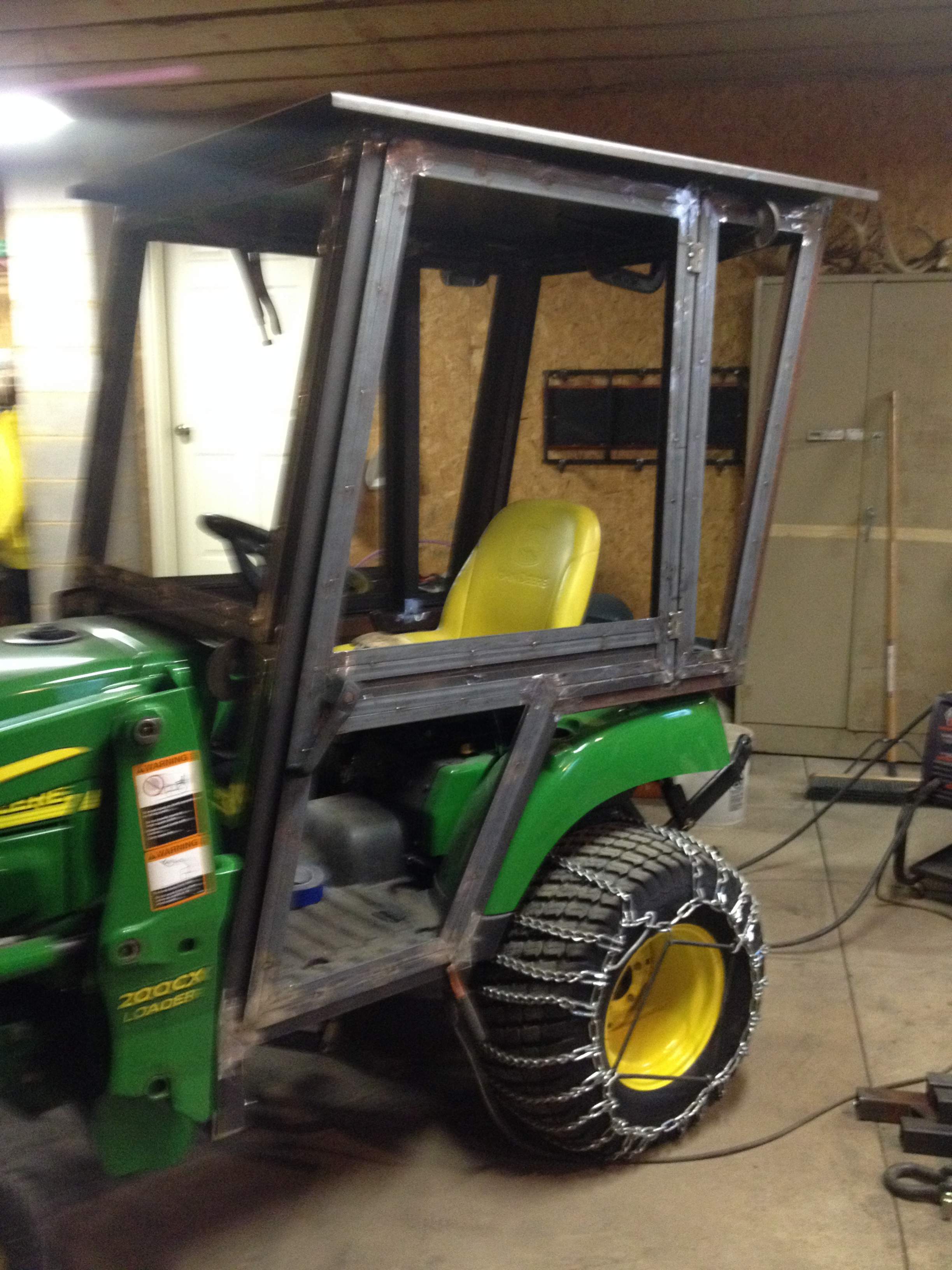

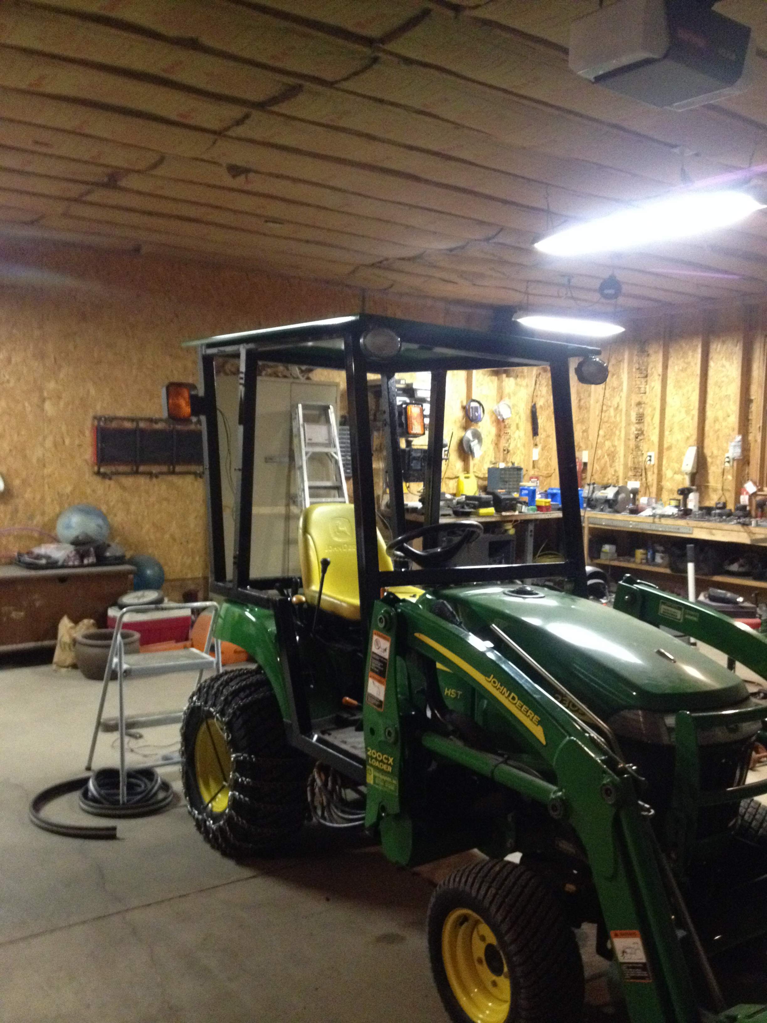

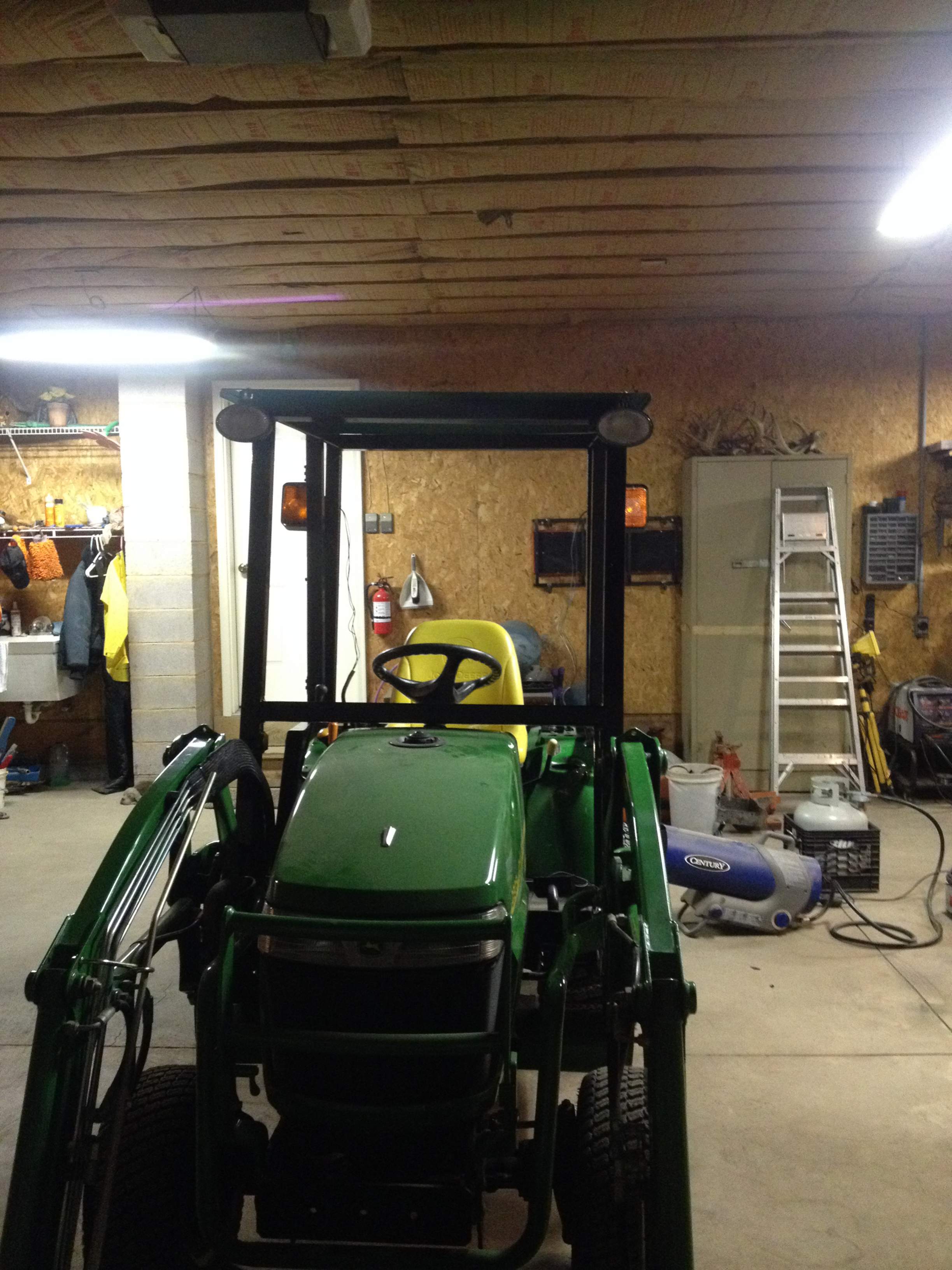

I dropped off the cab at the body shop yesterday. Going with a sprayed on black bed liner coating for the the main frame and doors and John Deere green epoxy paint for the roof. Decided to use lexan on all the windows except the front will be real safety glass so the wiper doesn't destroy it.

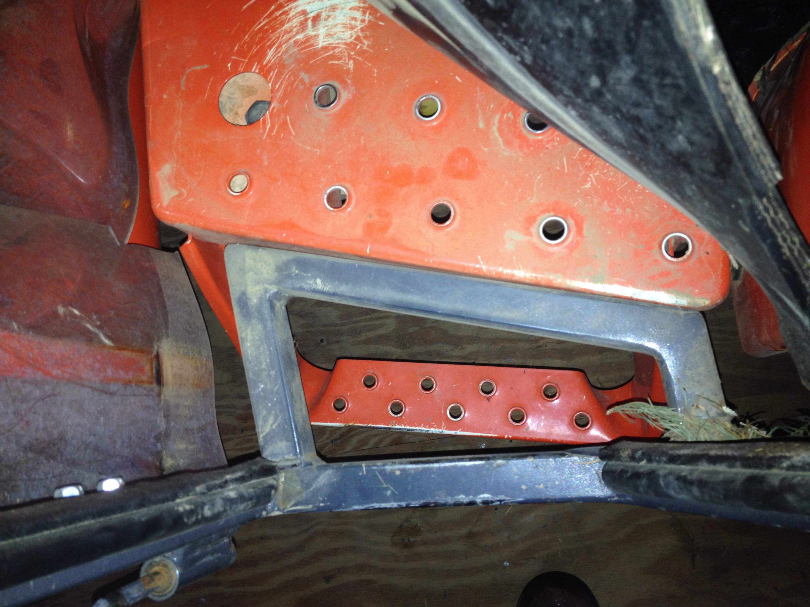

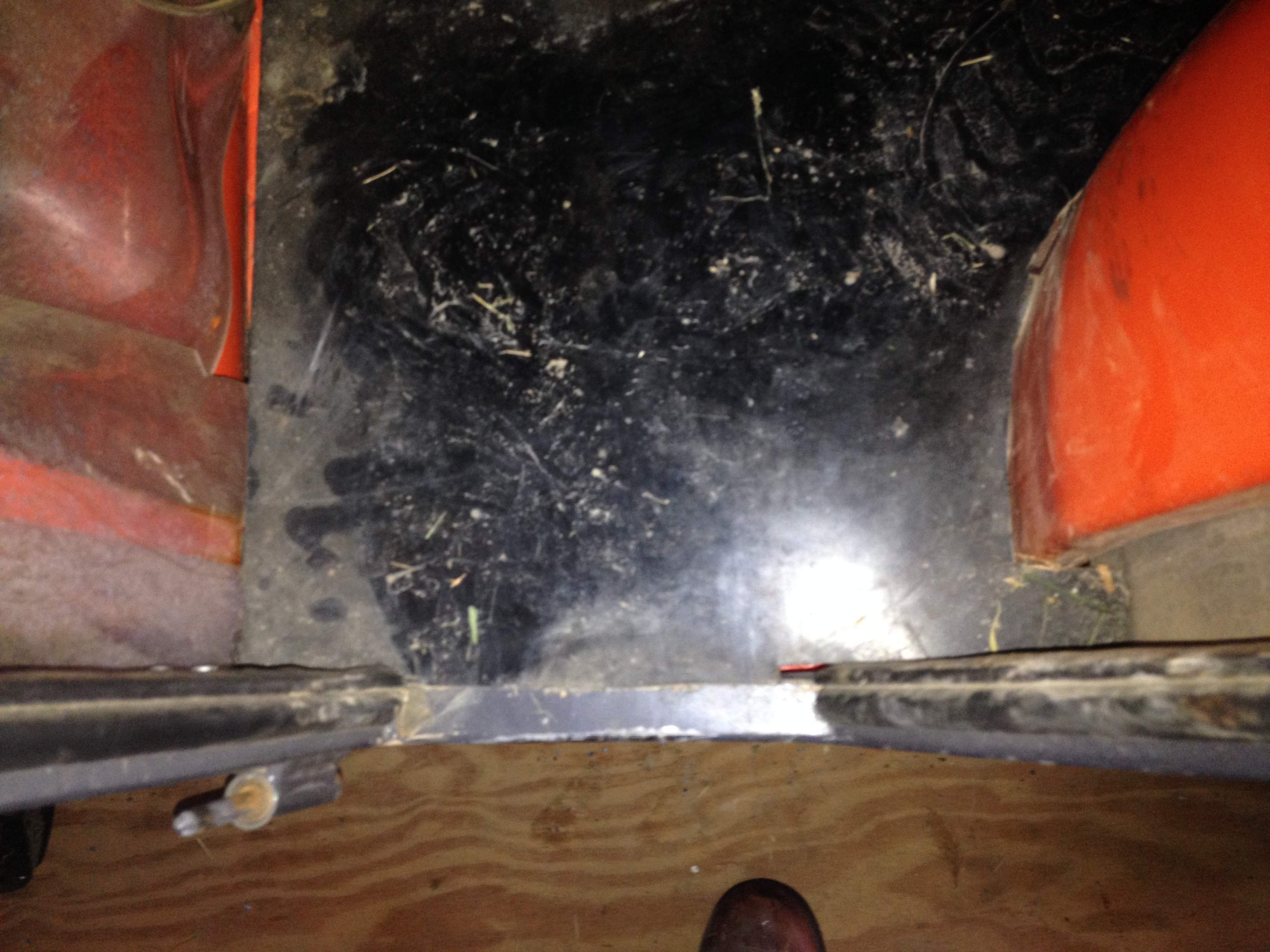

I got part of the cab back from the body shop today.
