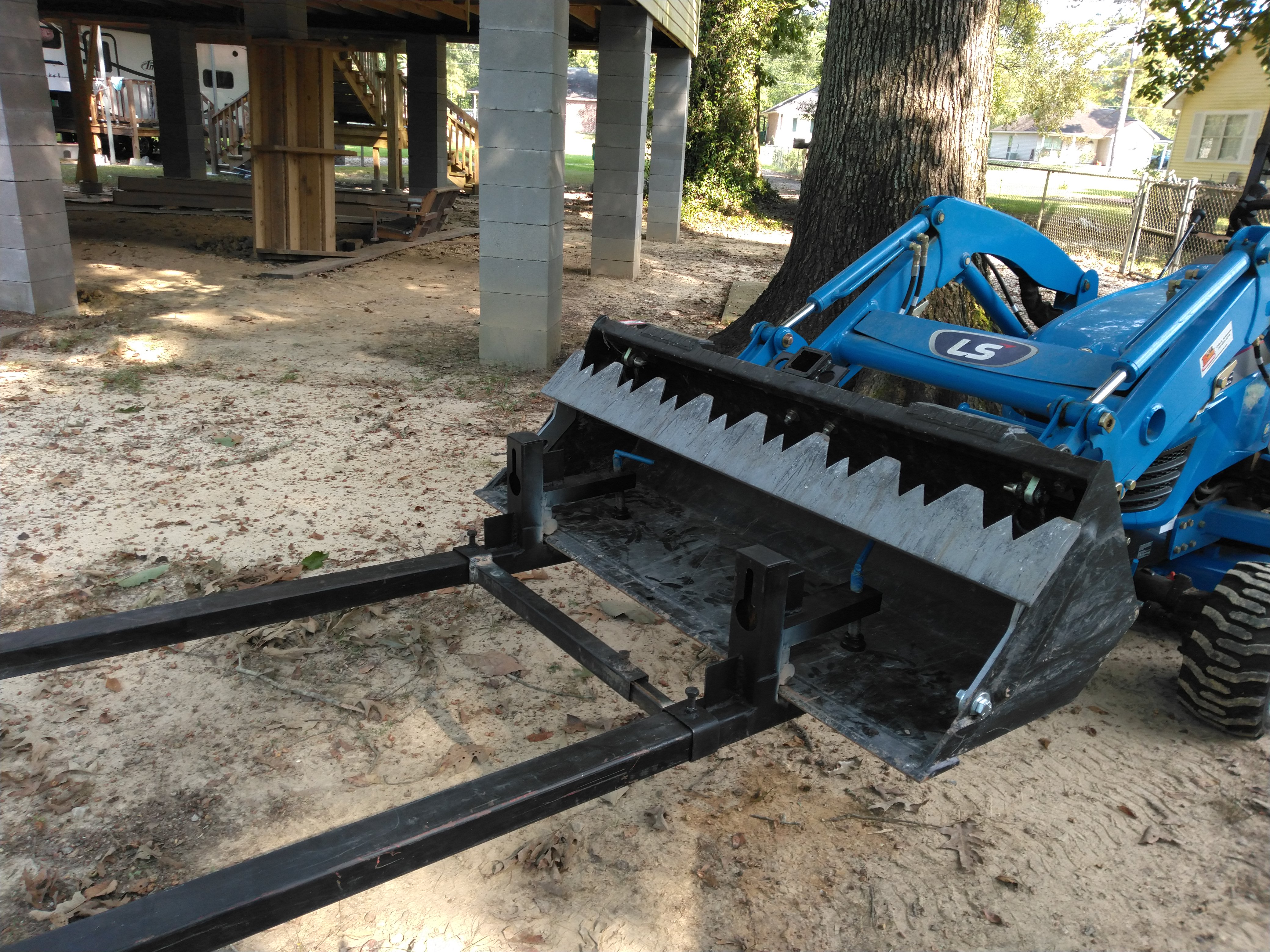

Here is the bucket with Piranha bar.
Piranha bar with Edge Tamers on.
Pick of bottom of bucket.
Pic of area I am going to clean up with Piranha bar, take out the tall weeds.
Jim.

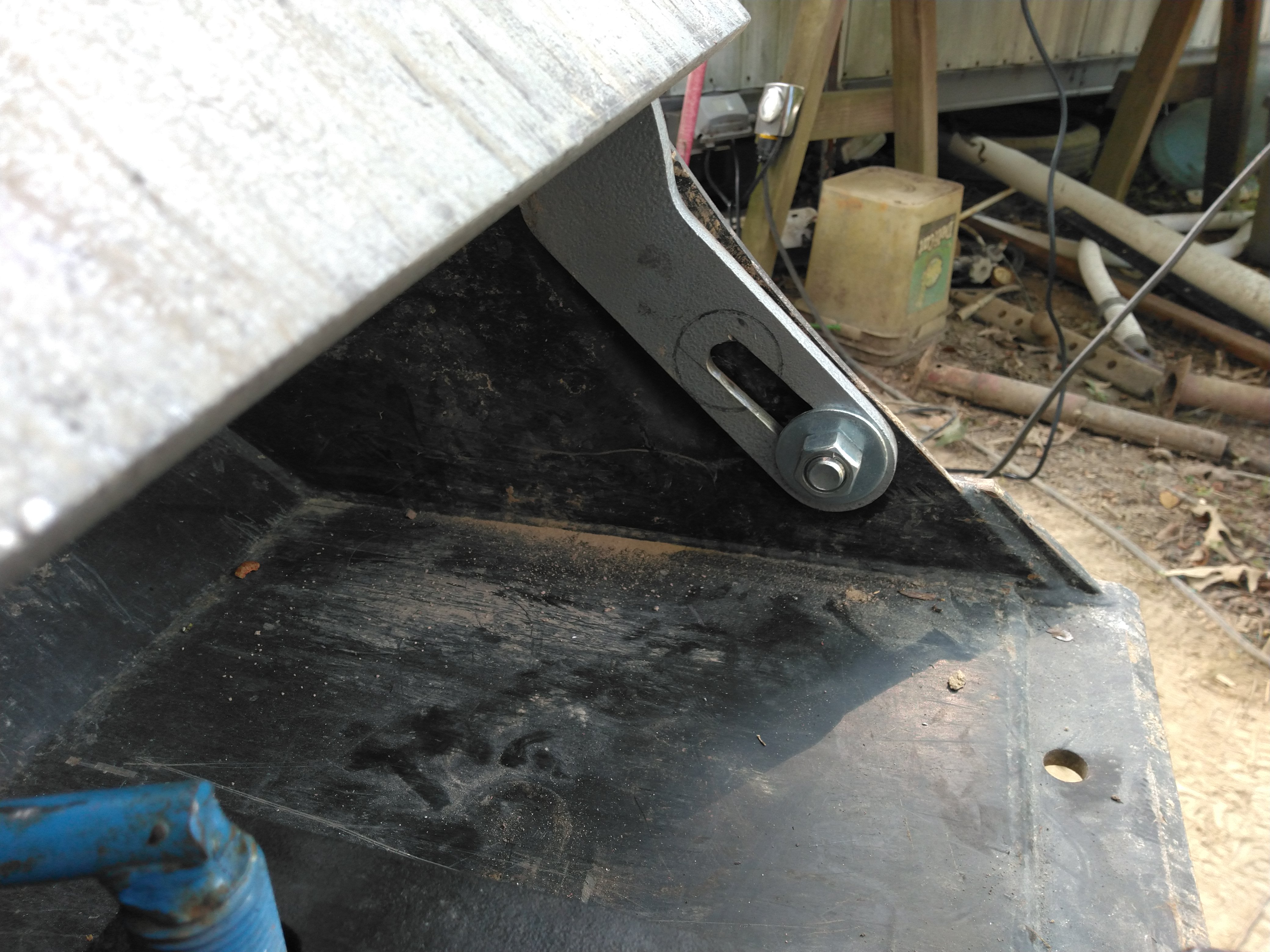

Ordered Piranha bar on 8/14, got it on 9/09.
Installed it, decided that I don't want to wrestle with
the weight of the bar every time I don't need it, so I
cut the slots longer, now I can loosen the bolts, slide
it forward and flip it up and out of the way.

That is a very good idea! I haven't had a reason to take mine off since I had it but this adds the option without of the fuss of lifting it and cutting the **** out of myself trying to reposition it back in place.

I am with you on that idea, I like it and I will copy it also because I have forks to use and a ball hitch to use on the bucket.

Yeah, I dropped it during the initial install, luckily I was
able to get out of the way, or I could have lost some toes!
Was gonna post a quick video clip showing how easy it is to flip it up, but I couldn't attach it...
I'm sure you all get the idea.
Best part is that when it's up, you can use the original edge again if needed

Being able to use the straight blade is nice plus you don’t need to store it anywhere unless you need to use the whole bucket.
