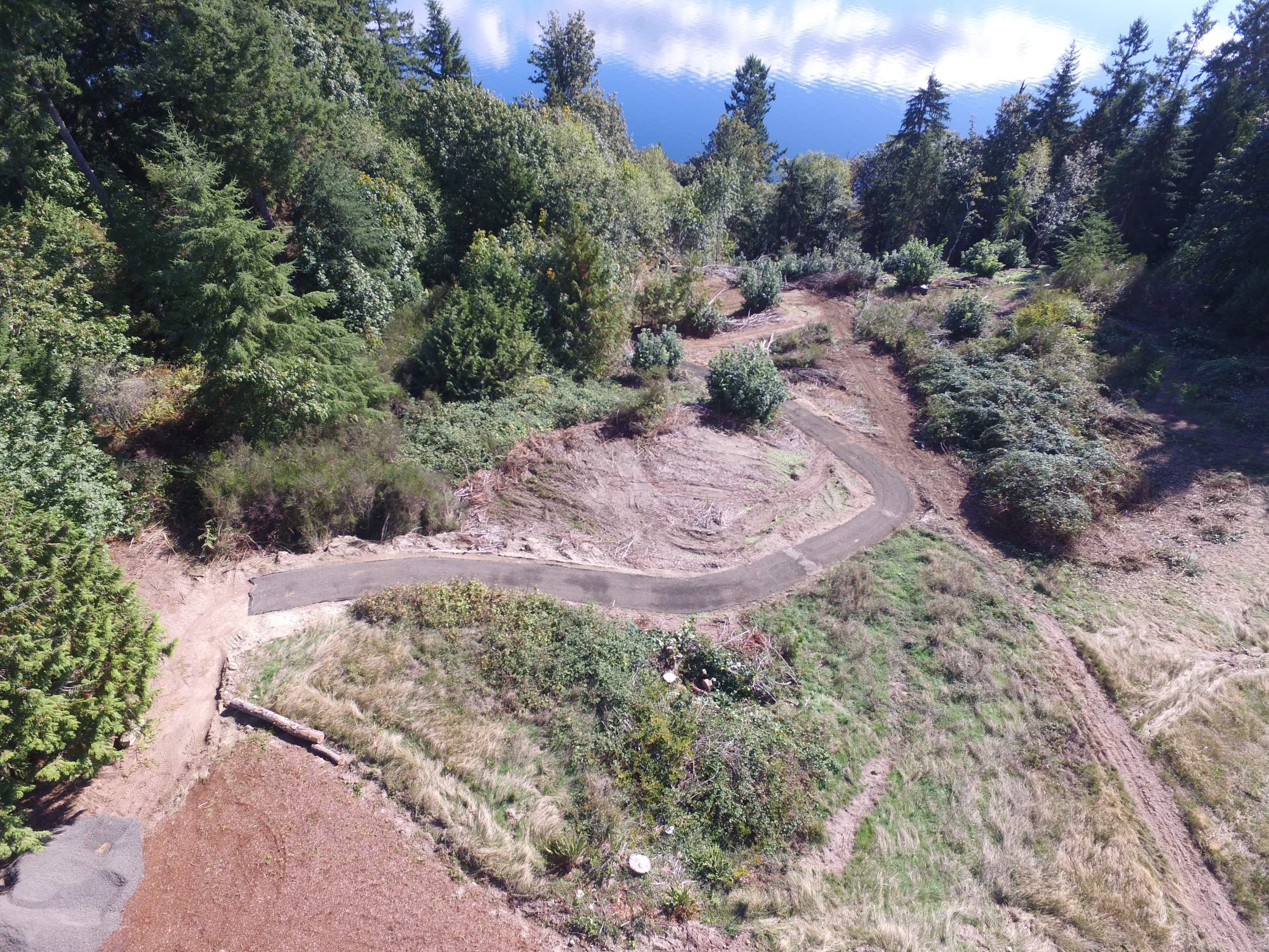

Finished for the day... actually into the night and LED lights. Having too much fun! Big 'ole burn pile going too. <img src="http://www.tractorbynet.com/forums/files/kubota-owning-operating/444295-bxing-stumps-img_6484-jpg"/> <img src="http://www.tractorbynet.com/forums/files/kubota-owning-operating/444296-bxing-stumps-img_6485-jpg"/> What is my BX looking at? Tomorrow's task to pull out another herkin' stump! Beautiful sunsets the last couple of days. Here is a shot of last night. Today finally clouded over and it felt like rain but nope... just good burning weather. On fire watch again this evening... and lovin' it! :D <img src="http://www.tractorbynet.com/forums/files/kubota-owning-operating/444299-bxing-stumps-img_6486-jpg"/> <img src="http://www.tractorbynet.com/forums/files/kubota-owning-operating/444298-bxing-stumps-img_6478-jpg"/>
Wow - nice view DE!

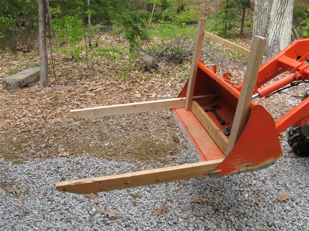

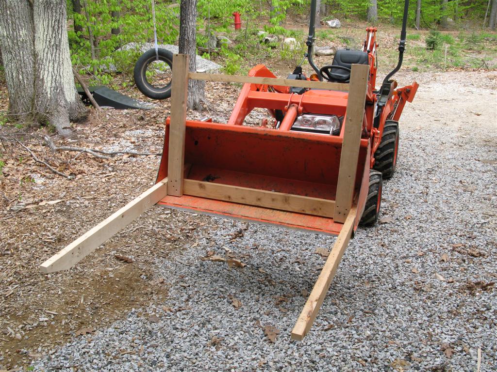

Forks make life so much easier for moving stumps like this. I built a set of forks out of 2x4s when I had a BX. They might look a bit flimsy but I loaded these over and over with heavy oak logs and they never failed. I ran pieces of plywood over the holes where I bolted thru the sides of the bucket (same holes the toothbar used) and fitted the ends of the forks snug against the back of the bucket. Cost was zero dollars. I eventually ended up buying a set of chain-on forks off eBay for $135 and am still using them on the B3000. Invaluable.

Thanks, Radair... I like your homemade forks, might have to do something like that as temporary until I get some 'real' ones. Beauty is you can burn them when you are done or even if not they are still biodegradable... ha, ha! :laughing:
