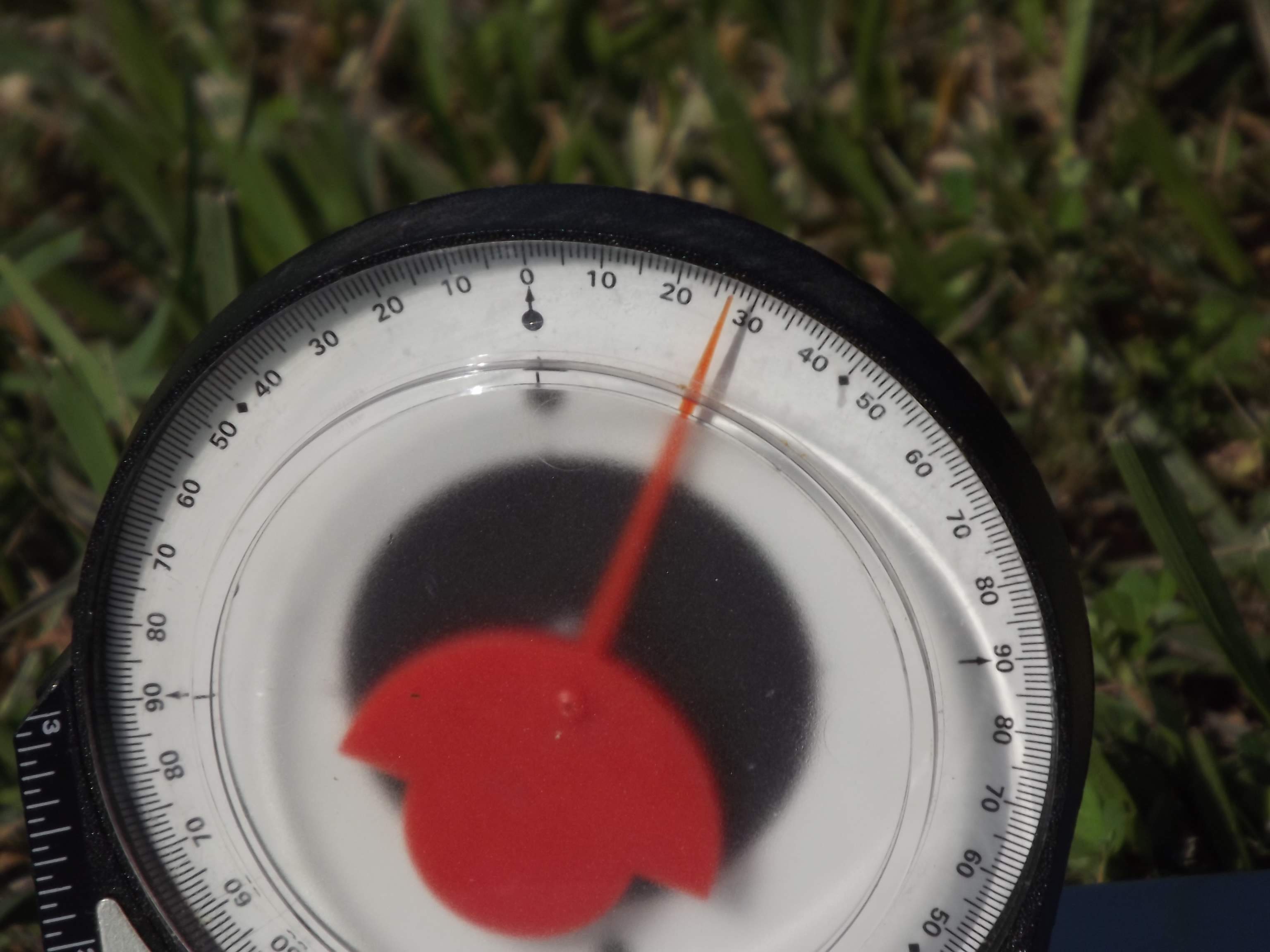

You need it to be comfortable for you.
I have gone across slopes a little over 30* with the BX. I don't know really what the steepest slope I have gone up is. I don't have a inclinometer for that direction. I know I can go up the 30* slopes I have gone across and it does not feel bad at all.
Wow! Are you talking % instead of degrees? Hope so, 30degrees is over 55%. I am scared at 25% (14degrees).

I walked the lower cleared area and most of the slope is about 20 to 25 degrees some 30 degrees. Maybe we should all agree on the best unit measure (% or degrees?). this I figured would be confusing in the discussion.
