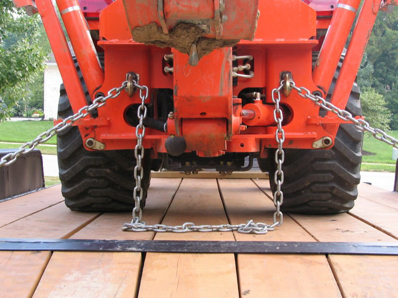

My preference is to use chains in the rear (because they are stronger) and straps in the front. My logic is because you are much more likely to hit something and the load will want to move forward vs. a jack rabbit start putting minimal stress on the straps
What is the load rating on that chain?
It doesn't look like transport grade.
You could also be stopped for no strap on the bucket.

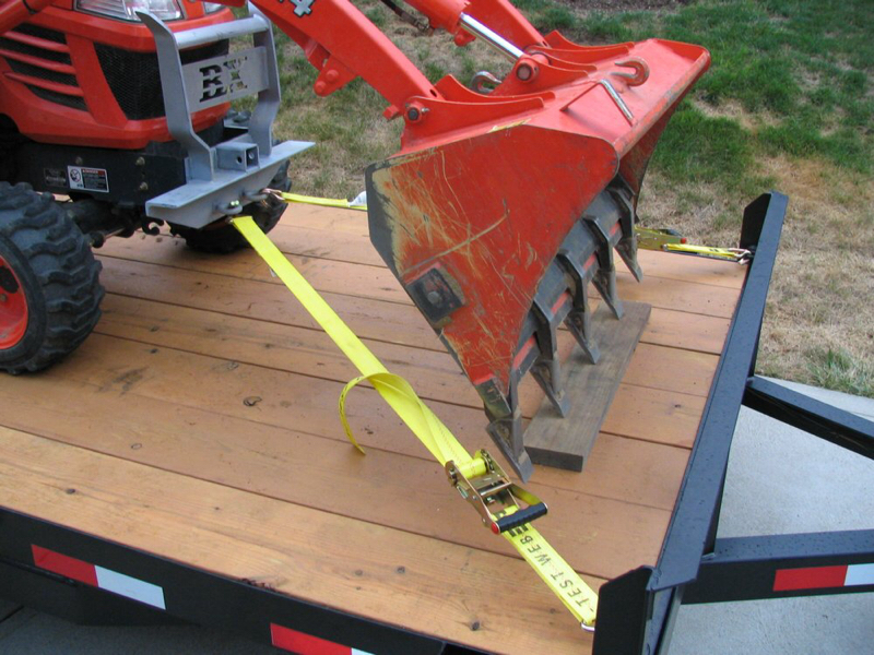

I posted this in another thread after I originated this thread. Found these pics online. These tie downs were previously made by Jari and Ai2, but the companies are either no longer in business or no longer sell them. I spoke with Middleton Equipment Sales who used to distribute them, and Middleton states that they are going to start producing them soon. I'm in for the first set. LOL
And no chain or strap on the backhoe. All implements must be secured to the trailer.
/ Bx25D Tie Down Attach Points For Trailering? #28
The chain is rated for 5400 lbs
The backhoe has a pin dropped in at the main pivot so it cannot drop
Because each strap / chain is "separate", there is redundancy. I always use 4 tie downs (min) when moving heavy equipment at work for much larger pieces of equipment and have never had any issue at weigh or inspection stations
Not sure what "it is not being held down" means (the chains and straps are both pulling the machine down). As I mentioned before, by far the highest and most frequent loads on the tie downs is the equipment moving forward during heavy braking
The rear chain hooks are welded on but you could also go to the "hitch mount" on the back of the tractor in front of the BH

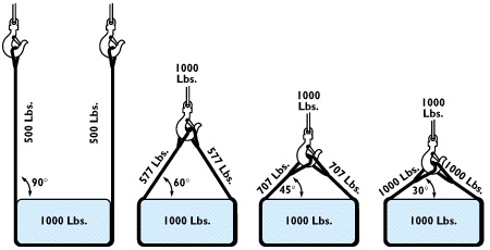

The tie down points are a great idea, but those straps in the picture of the BX on the trailer has the straps pulling sideways more than front to back. See the image of the lifting slings that shows how forces get multiplied when you pull "sideways"

Agreed, I'm hopeful to find those bolt-on tie downs and would prefer the see the rear tie down attachment points at the back of the trailer with the straps crossed if possible.

Looks like your front straps are not doing anything to hold the machine down but rather keeping it from rolling backwards. Even pulling it forward if something happened to chains in the rear. I have chains and straps but feel totally confident that my straps will hold mine DOWN.:)
Did you add those hooks on the rear, like those. Welded or bolted on? More pics of them, please.
Looked again at rear hooks and noticed you also have back being pulled back with chains instead of DOWN. If front straps were to break then you'd have a loose tractor with lots of rolling potential also assuming the brakes that should be locked on are not able to hold the tires on that wood deck. My:2cents: is you need to strap it DOWN instead of being pulled front to back or back to front.
His tie down points on his trailer are below the points on his tractor. He is strapped down as well as stopping front to back. IMO it's a good job .02
