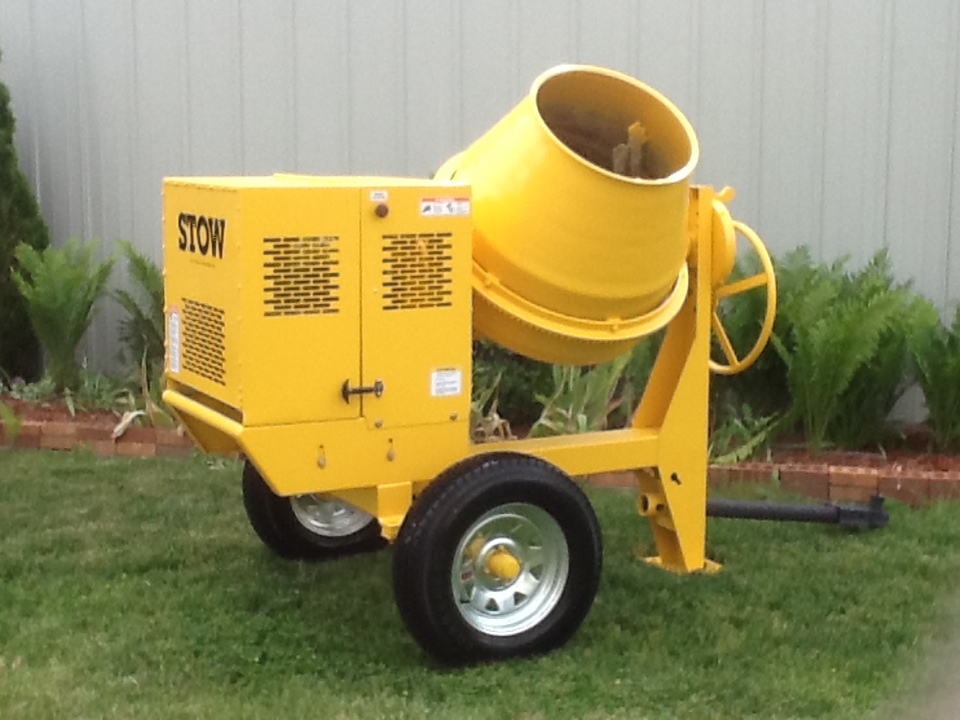

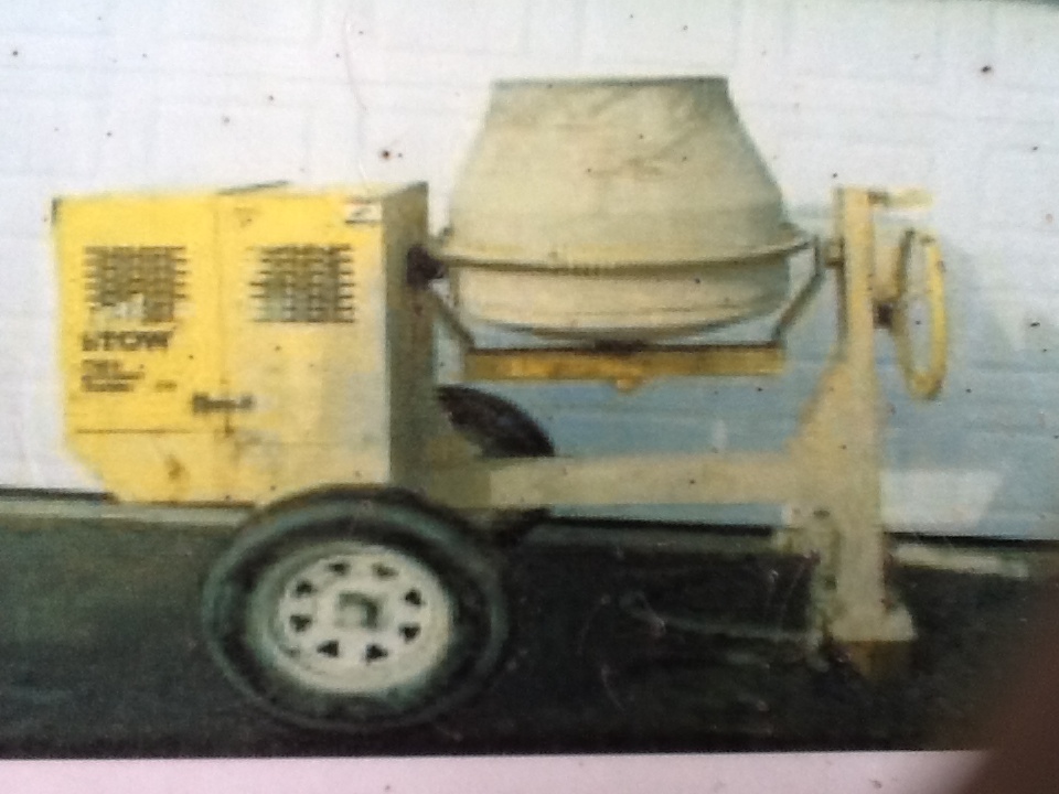

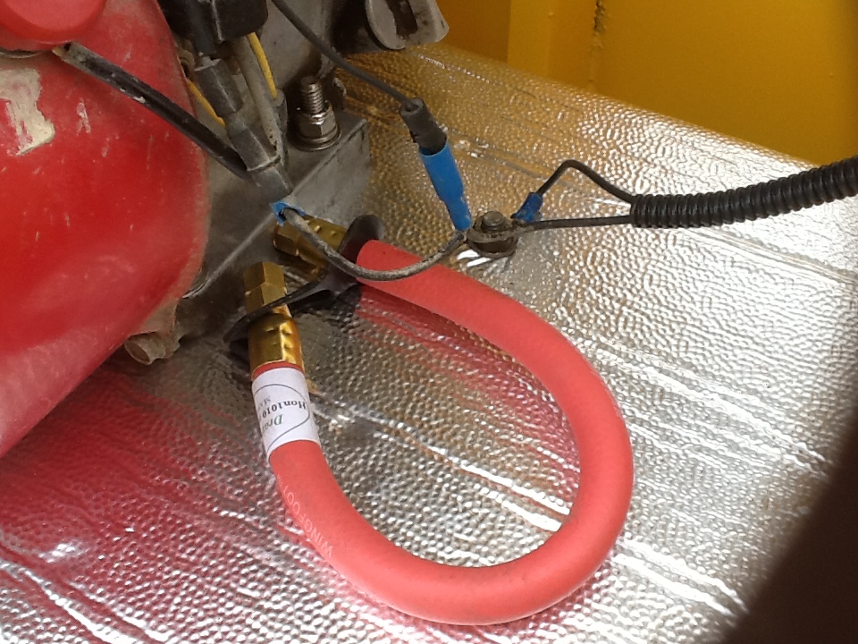

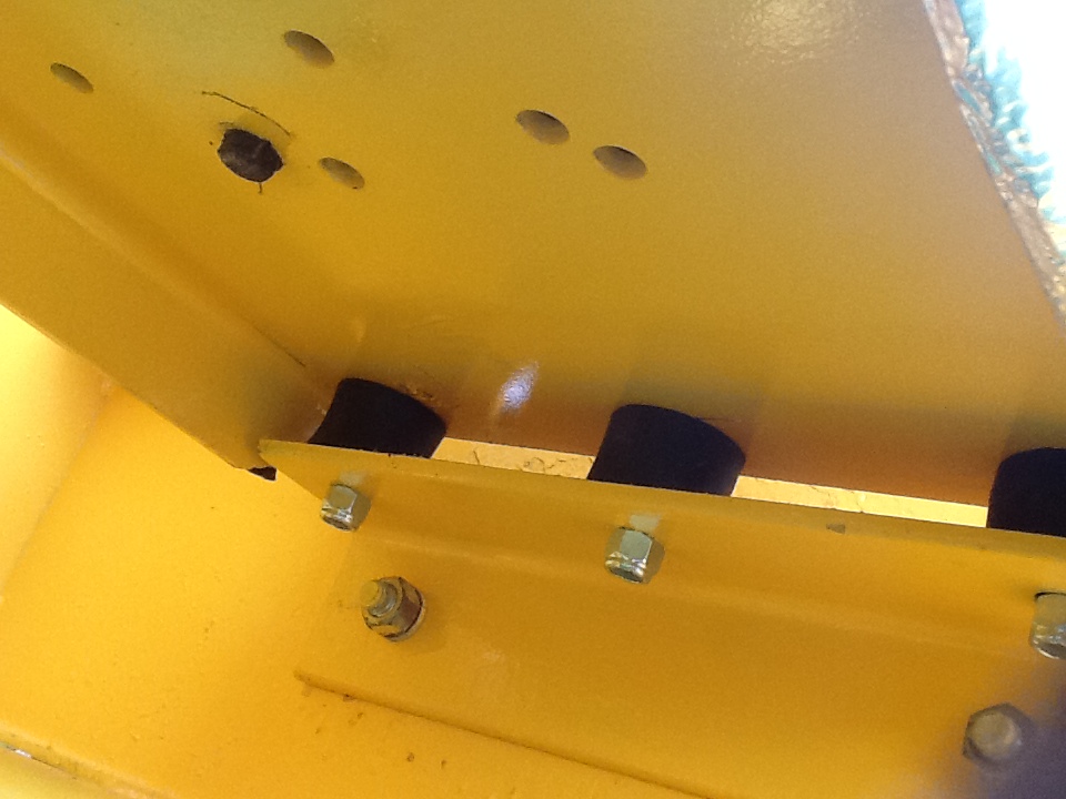

I got done with the cement mixer.
I did just a couple MODS so far,

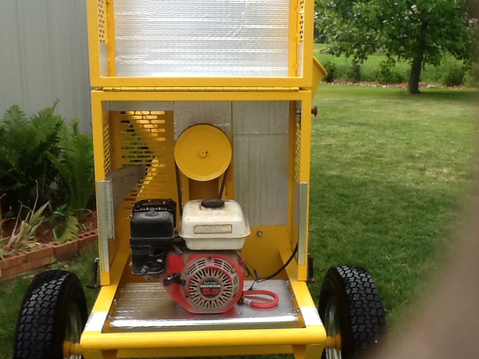

I added some "Flex-Clad" under the sheet metal motor enclosure, and use rubber mounts for the Honda Engine Deck. The thing wanted to vibrate itself to pieces.
I also added some rubber mounts on the engine deck. I used 6 of them, so the "belt side"is in tension, which is different than what would normally be acceptable I guess. (compression) We'll see how long they last.
I didn't shine up the Honda 5.5 (Gx160) yet, but that could easily be a "next winter"project.
I added a
"Drainzit" drain hose for oil changes, gets engine oil over the edge instead of just draining all over base plate About $20 plus shipping from Northern Tool.
If you ever have a noise or vibration problem to abate, the addition of the Flex Clad made a huge difference. Keep it in mind for our tractors. It's available from any industrial insulation supplier, if anybody needs info on it let me know. Here's a link (not affiliated with them, just work around industrial setting and our insulators use it) This variety has the foil backing, it's about a 1/16" thick, and has a very tacky, rubber like material that has to be cut with a razor knife.
www.flexclad.com/
I added a
Nice job on the cement mixer looks new :thumbsup:

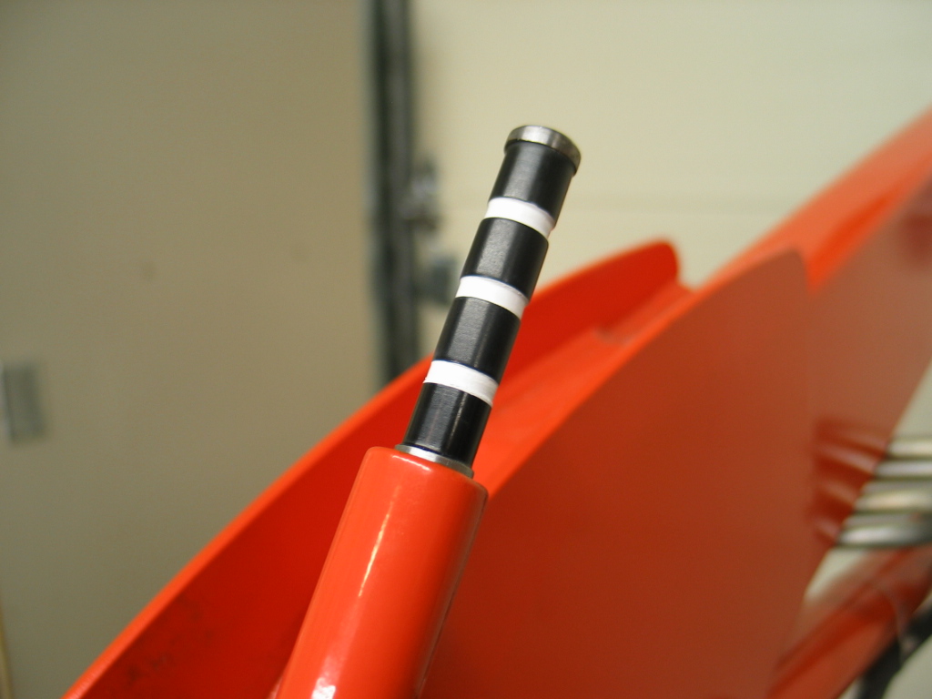

bucket leveler 001.jpgbucket leveler 002.jpgbucket leveler 003.jpgnot to hijack, but here is my bucket level indicator. I needed to make one because I removed the factory one to install angle iron for bucket hooks. It is just a length of 1/4" rod and a stub of pipe for it to travel through. I welded a nut for the rod to pivot on the bucket arm. I also ground a small notch in the rod and gave it some black paint to indicate level. I like it better than the factory one.

Yours is very nice WaxMan, as you can see, mine rubs alittle when the bucket is in full pivot.
Thanks, I used a full tube so it does not have to be so long like Kubota's style. I also machine the end so it's smaller then the tube and won't rub off.
I attached the tube and rod to the fel piston pivots. I center drilled and tapped the piston pins. The tube is attached to the top pin and the rod is attached to the bottom pin. You can find the level mark if the bucket is up in the air or on the ground. Since the BX only has one piston what you did works best for you. I will be replacing the long Kubota rod on my new 3240
