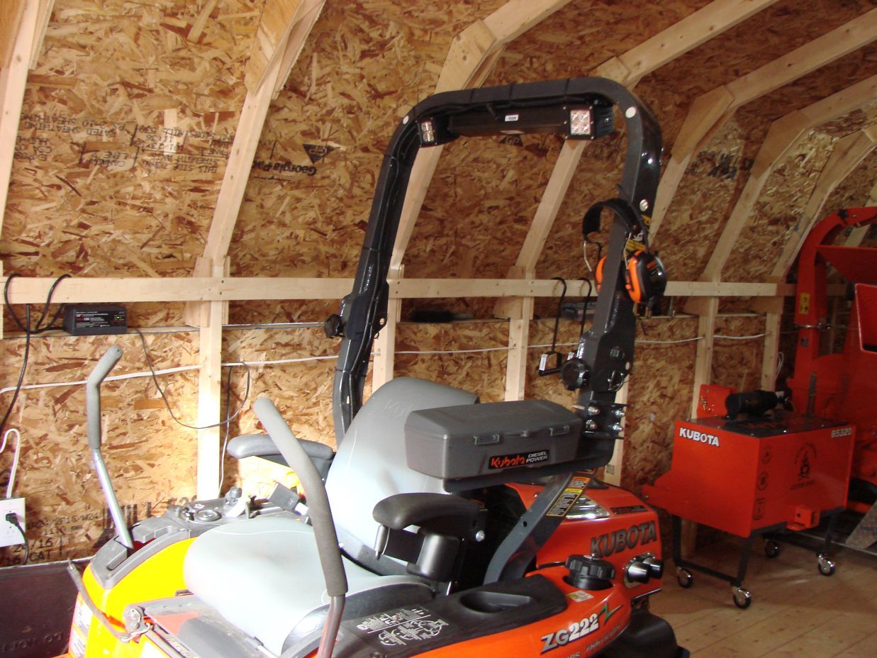

I think led lighting is the greatest invention since the wheel. Glad you found the same results as well as me. It's a great trade off for sure. The last few weeks being busy for me at work and the generator shelter project I found myself having to mow the grass in the dark because the sun goes down so early so last night I had a couple of extra 4" led work lights so I put them on the ZTR. Now if I have to mow I will at least see where I'm mowing :D
This is cool! I plan to do the same. Did you add a switch to control the lights? I'm curious what you used. Nice lights. Are these also Cree?

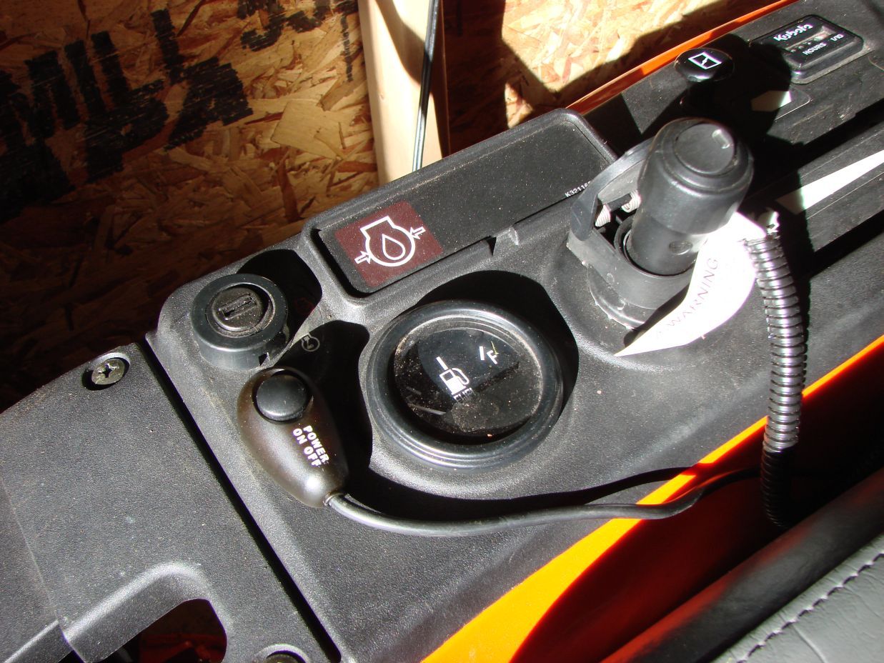

They were two lights I had left over from the 5740's lighting project I did on the Alley lights. I also had a relayed harness that has its own dedicated switch. When the ign is on the small green LED light is also on in the switch. When you turn the switch on the lights come on and the switch light turns to grean. Nice set up and it's nice to see in the dark now.Yes they are Cree.

Thanks for the pics Paul! Harness looks like it simplifies install. I'm thinking about mounting 4 lights on my future zero turn. Should look like a combine at night! Hah!

Your welcome sir. I wish I had taken a photo of the harness before the install but I had a little to much to do that day. We has company here at the shop and they wanted to see everything I was doing and I never got to my camera.
The harness was only $19. It comes with all that's needed including the relay, fuse holder, switch with two small led lights within the switch. Very easy hook up. One ground, one positive battery and I positive to ignition. All that's left to do is plug in the lights.
