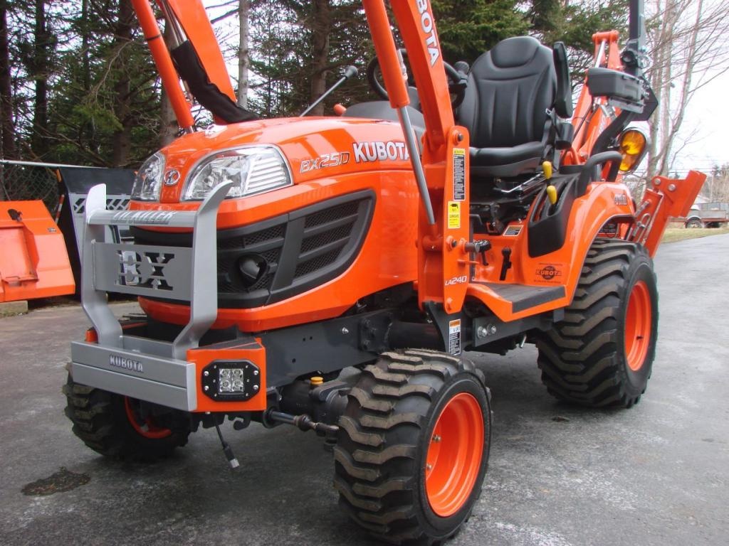

OK. I'm happy to report that I've completed all the wiring on the BX25D.
Yep. It took all day and most of this evening but it's done. I snapped some photo's for you all to look at. As you'll see I installed an auxiliary 6 cavity fuse panel. It's relayed so that power will only be on the fuses when the key is on.
I also snapped a few photo's of some GM weather pack solder-less terminals that I used. Some might not have see these used before so I wanted to include them in the photo's. You'll notice there's a special crimping tool that's need to crimp the little pins but I like these and use them a good bit. 95% of all the wiring was soldered and heat shrinked. I am not a fan of stab loc connectors but I do use butt connectors where it's dry and away from water.
I used waterproof switches for everything. I also installed a horn, reverse alarm with a by-pass switch so it could be deactivated when ever I didn't want it on. I installed the horn switch towards the said of the instrument panel due to lake of space but it's easy to reach there so I'm OK with it. I put in an extra accessory outlet and the tactical light on the ROPS is working now as is the 20" LED light bar. The ditch lights are absolutely awesome now that they are working. I also got the back hoe lights wired in and they are very nice as well. The 6 cavity fuse panel was just enough to get it done. I put a disconnect on the back hoe with harness because when I go to let the hoe go from the back of the tractor I'd need to be able to split the wiring.
Anyway I hope you enjoy the photos. I'm using a new camera and it's taking some getting used to so bare with me. :eek:

Paul,
A friend of mine that worked on a lot of marine stuff used to fill the butt connectors with RTV silicone before he inserted the wires and crimped the connector. He claimed he never had any problems with corrosion after that. Messy while you're working at it, but trouble free afterwards.

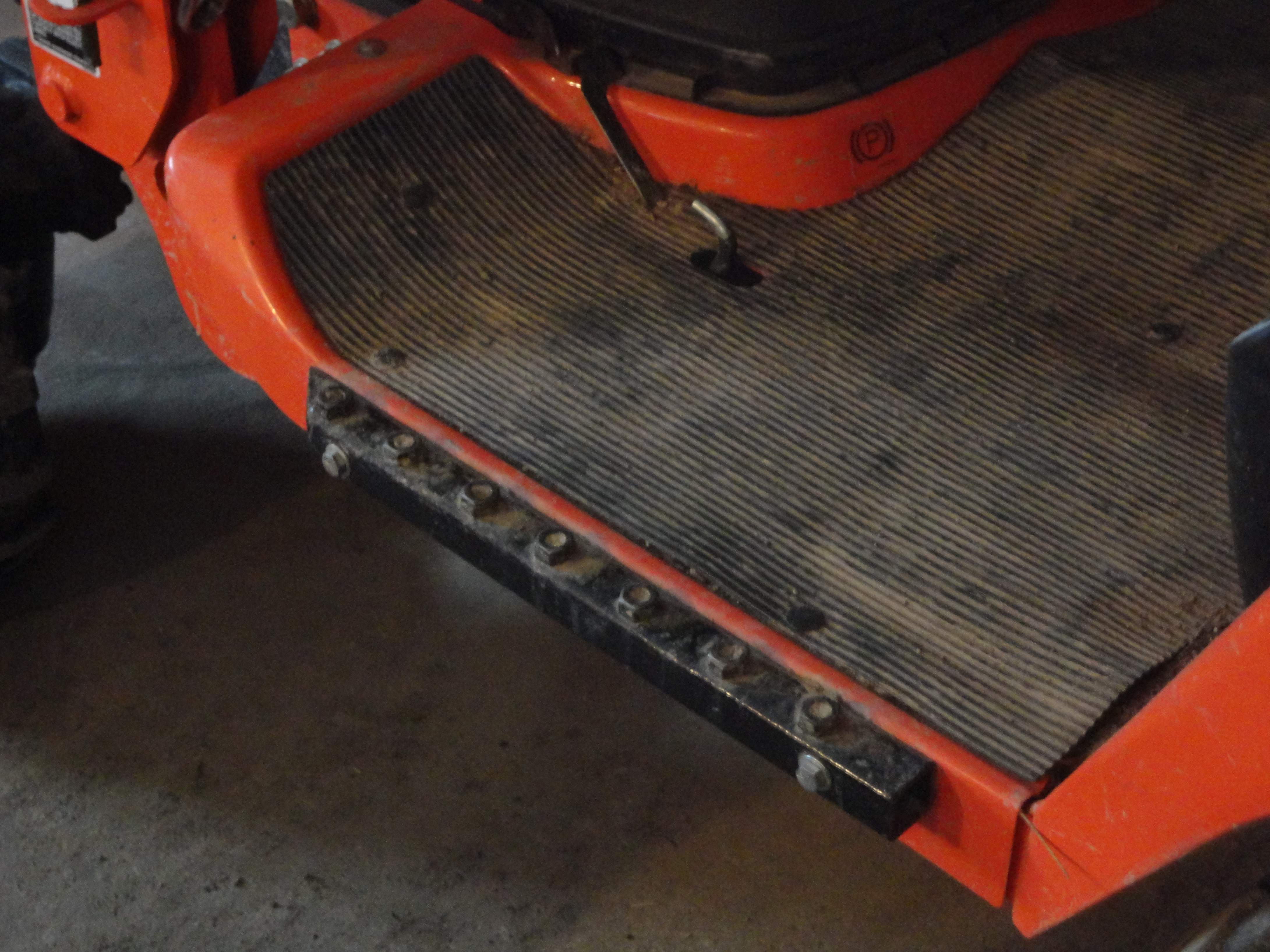

Just a simple modification that I am sure you Paul(4shorts) could improve on:
I found here in Ontario like I imagine on Atlantic coast, I found myself slipping on tractor floor board when getting up into tractor, with muddy or snow covered boots.
I had a piece on 1 inch square tubing, that I welded a handful of nuts to upper face and then bolted the piece to outer edge of left side floor board. Just a safety modification that has saved me landing on my butt and elbows this winter...see pic attached, maybe 4shorts or others can improve for your machine.

Paul,
Sean
Ya. I do that in high corrosion areas but I use dielectric grease. RTV is OK until you need to get it apart again. Good tip though :thumbsup:
Ha. That was the very first mod I did with the BX. If you look at the BX above you'll see I used grip tape in that same area. You'll notice it in the attachment as well. Works for me. Thanks for that tip :thumbsup:

In theory a crimp should be air tight but that is hard to do with the style of crimpers 4shorts is using. A ratchet crimpper has better dies and is adjusted for a repeatable crush.
I think I paid about $50 for the set I have. But I don't see where the RTV would harm anything and may help when the crimp is less then perfect.
/ BX25D. Mod #1 and continued.
#230
I have many different types of those crimpers but I never use them under a dash or a dry area. In a high corrosive area I'll solder then use the heat shrink with the sealant in it. It's expensive but it will last almost forever without issues. The crimp tool you see in my post is strictly for solder less terminals and for the weather PAC systems that you see on all the newer vehicles.
