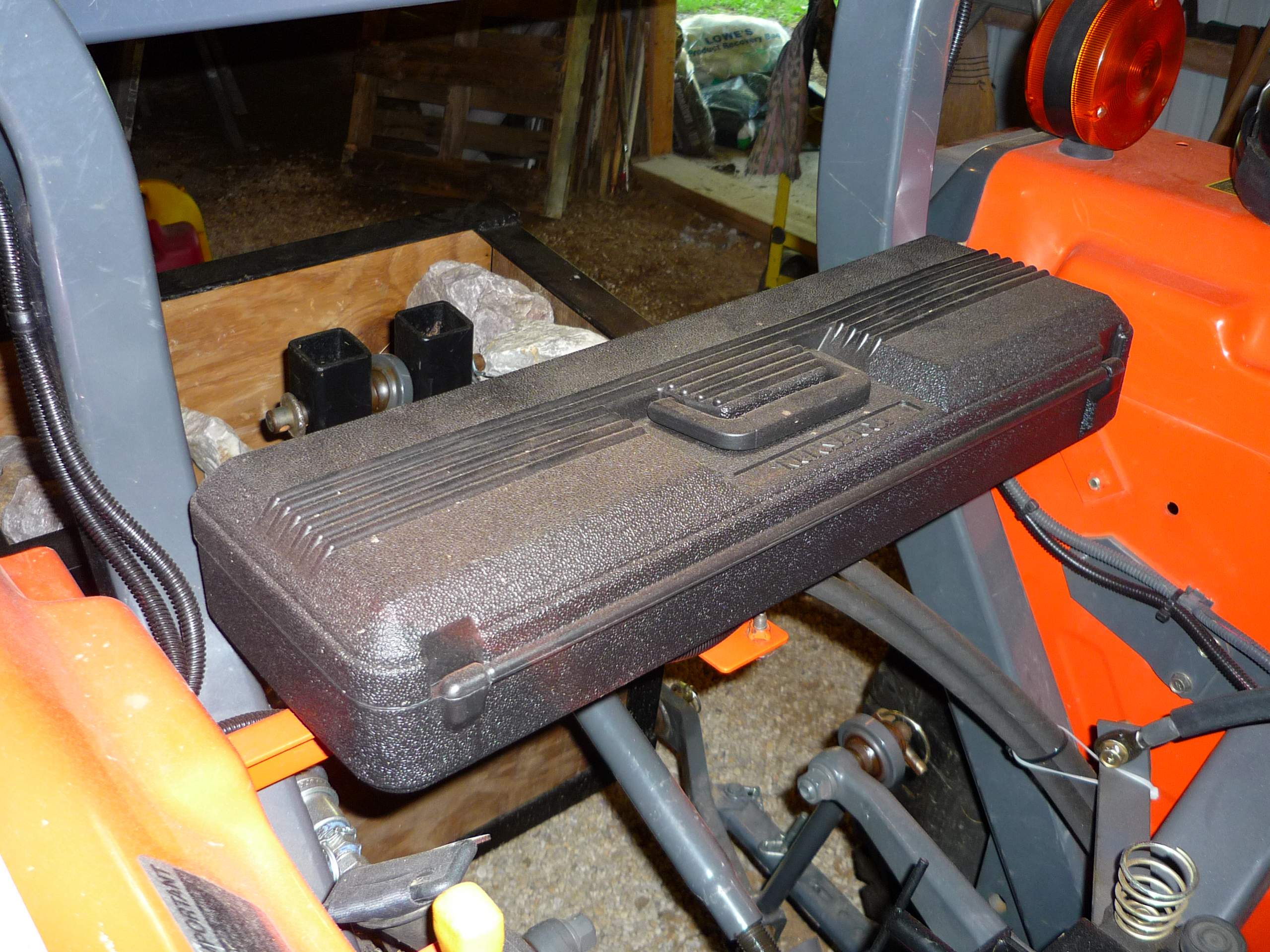

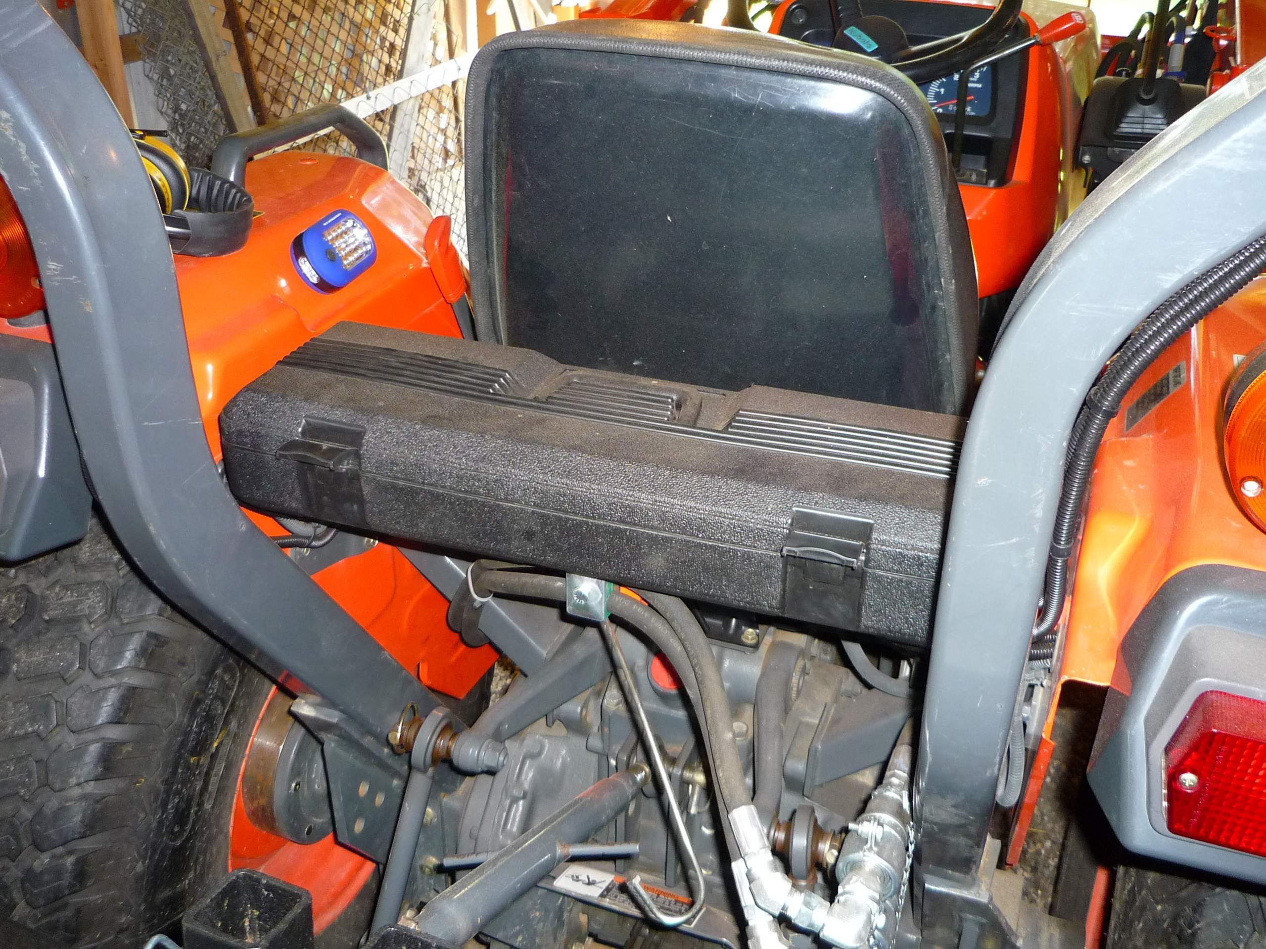

Well, look at 4shorts' BX25D- he installed a couple of armrest type toolboxes, I believe. My own solution was the $10 Sears Craftsman truck tool box- waterproof, won't rust, and a good size for my needs. I used the existing SMV mounting bar, some SS machine screws and large washers to prevent a tear out if the box gets hit with something. I had the same box on an earlier tractor, and it lasted over the years with no problems.
