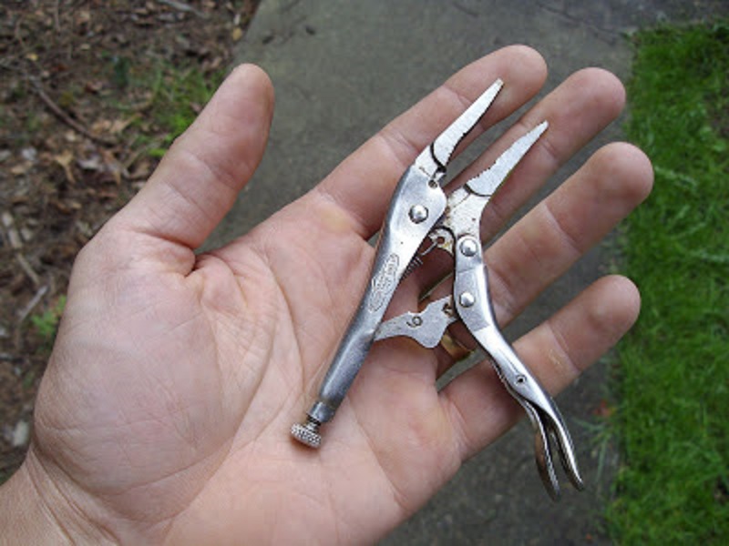

Great idea but I use a small pair of needle nose vise grips. Has worked great for decades. Get one size larger than the sample shown below.
