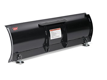

Well, a new piece of property and some new challenges.
SNOW! ...and how to get rid of the stuff! Well, I have another
crazy idea and hook or crook I am going to do it. I should
have the ability to plow AND use my bucket to move snow
when done, meaning w/ the grapple down I plow, with the grapple
up and the plow totally out of the way I can move snow into tall
piles or move it elsewhere.

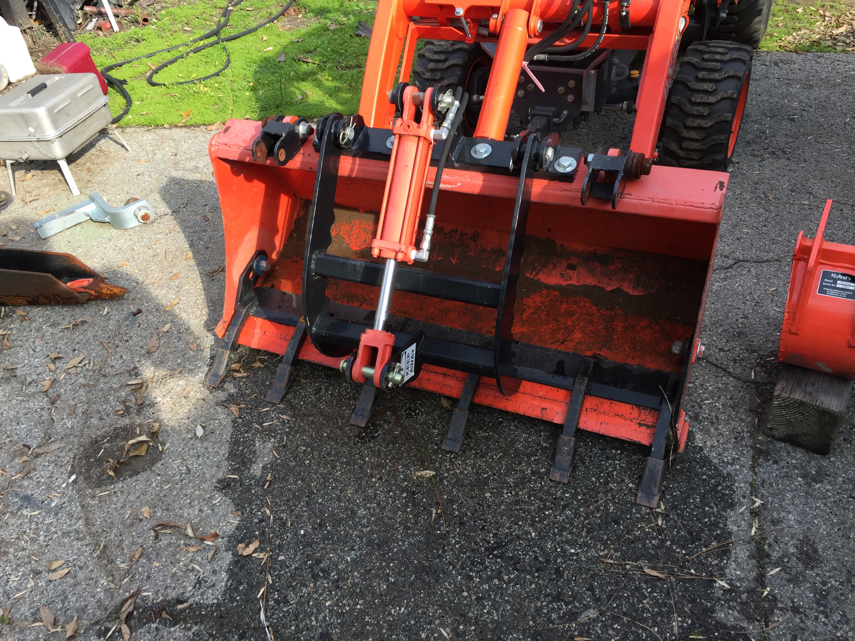

You all know about the GrappleOMatic I added. It really works well.
CLICK HERE to see it in action. SO the idea is to mount a 60"
WARN Provantage plow "TO" the grapple so I can "lift" the
plow out of the way and use the bucket to pile snow etc.
For the life of me I can not see why this will not work, and
work well at that...

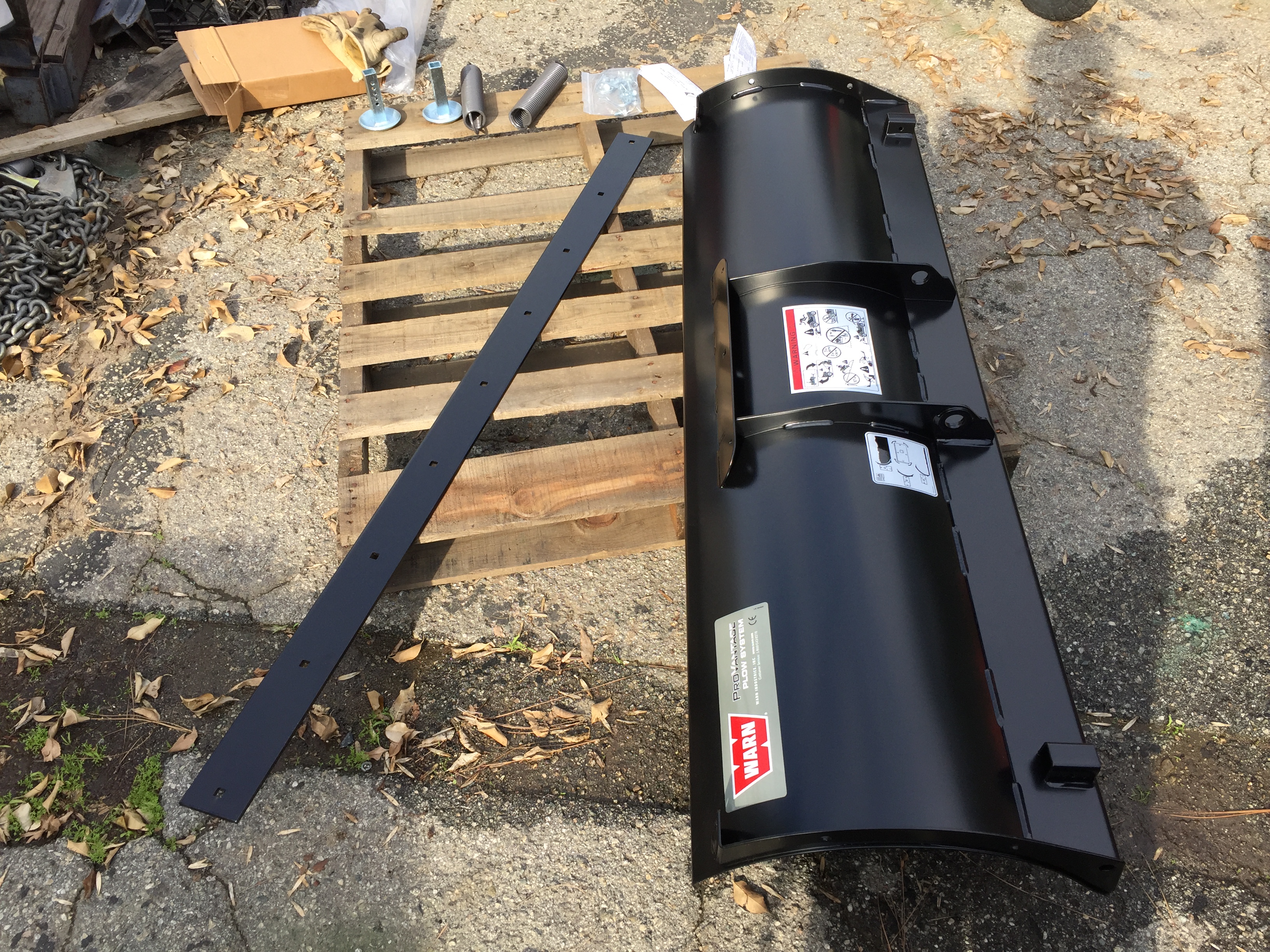

Here are the parts I will use;
WARN 92100 PROVANTAGE PLOW BASE
WARN 78960 PROVANTAGE PLOW (60")
Custom mounts
I think I can make a couple or "Horns" if you will that
protrude from the grapple and then simply slip the plow base over
said horns w/ a couple of reatainer clips and viola!
I might shorten the tubes, time will tell. Then eventually add
WARNs automatic Plow Pivot so I do not have to leave the seat
to angle the bucket.
It seems like w in win to me. The only reservation I have is
where the very bottom of the grapples pointed ends stop
just inside the bucket. I am concerned w/ the torsional
forces on things. If there is an issue I can simple make a
couple of bolt of receivers for those ends I do believe.
I did remove the tooth bar fwiw.
Any comments?

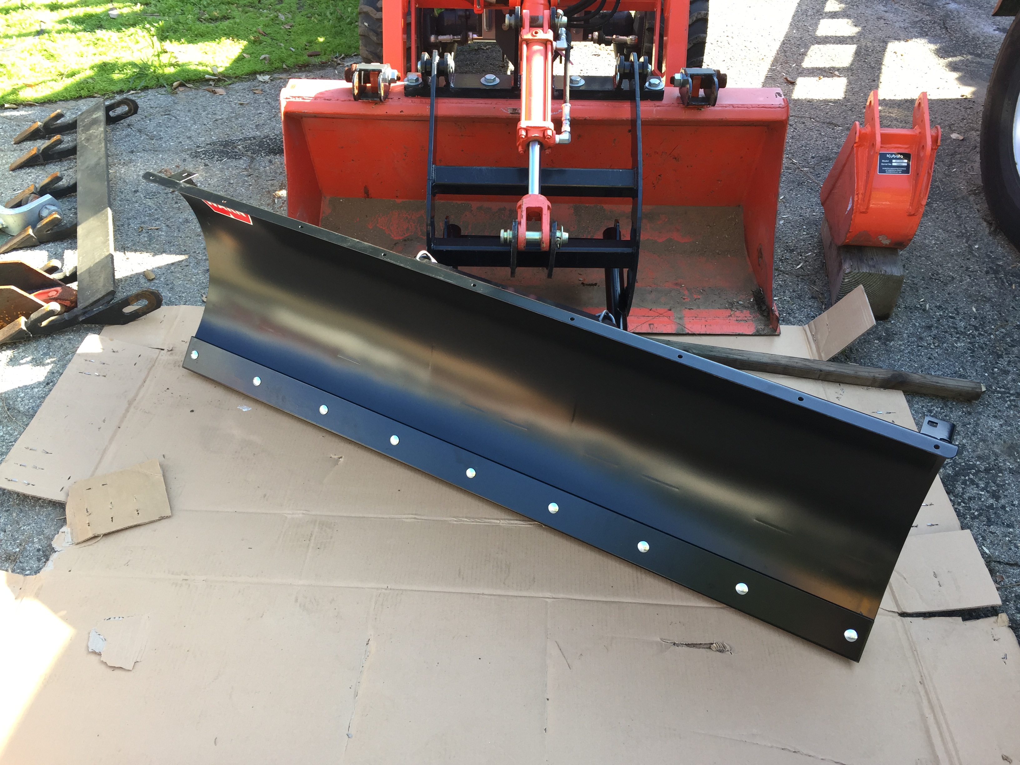

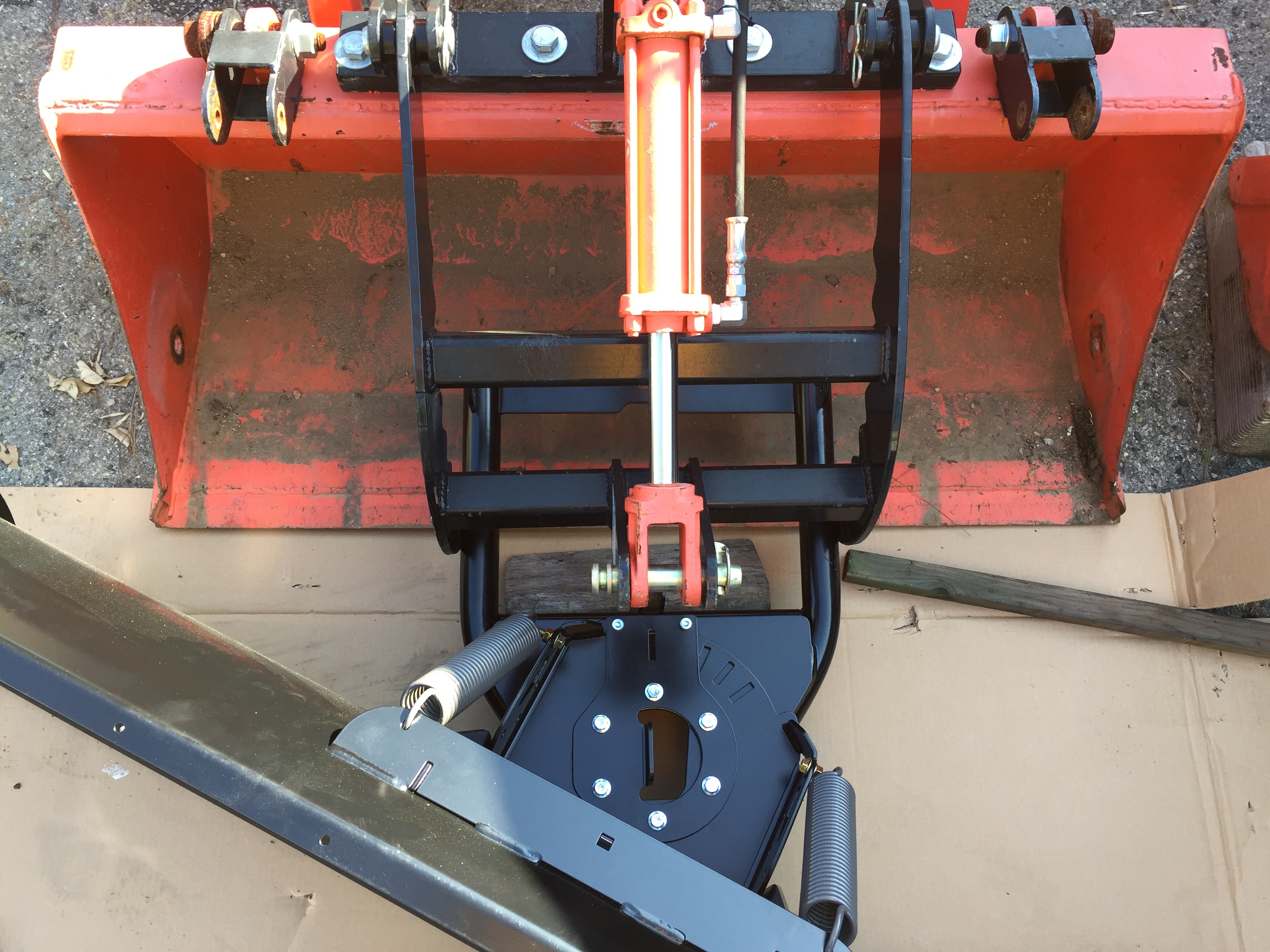

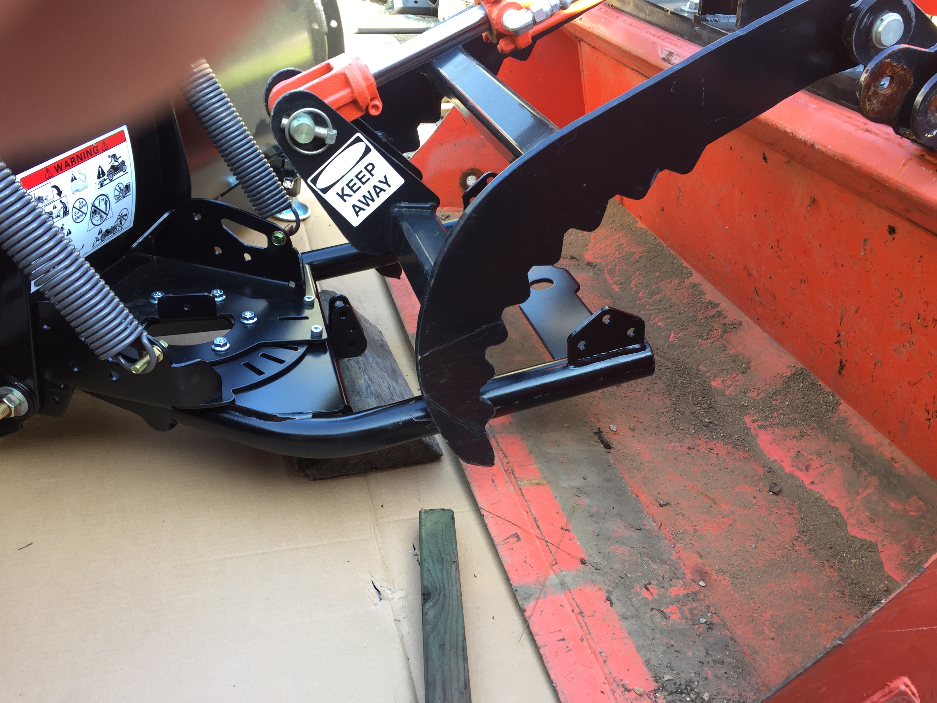

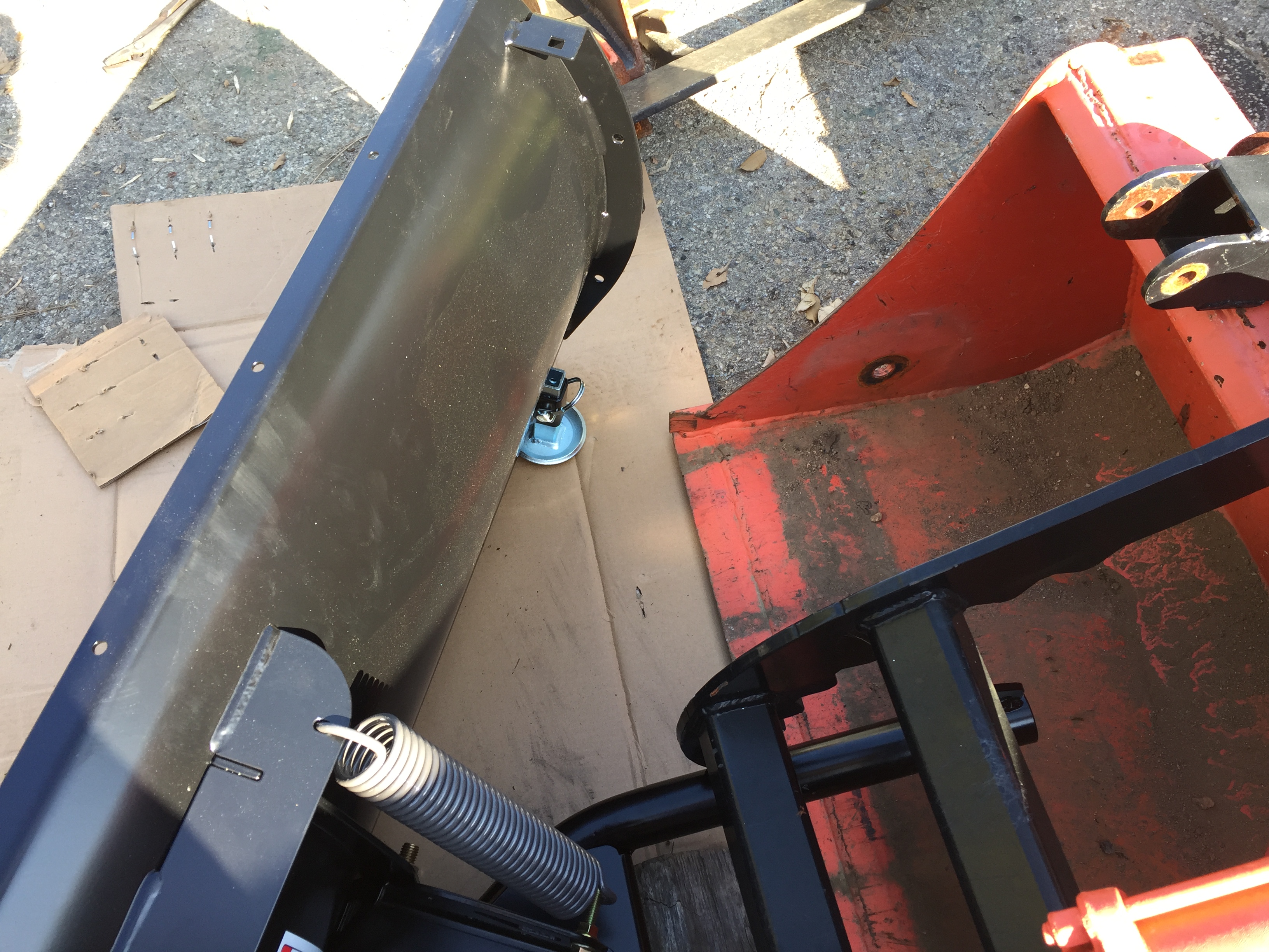

/ BX25 SnowPlowOMatic
So I ordered a base, it came and I will be dipped in it. It was a return,
someone raped the hardware package out of it, it was partially assembled,
the hardware box's staple was pulled and resealed w/ duct tape plus plus plus.
The seller on Ebay was a real stand up company. The said there refunding
me all my $, I have since purchased anew and close to get it quicker.
SO I jury rigged some bushing and nuts and bolts just to fit things up and
wow, the tubular plow base frame "just" fits between the claws. SWEET!
The angle you see is very close to the proper angle it is to be mounted at,
and the front to back position is very close to where I would like it as well.
The plow is angled to the right to its max as pictured.
If this works well I will upgrade and get Warn Pro-Pivot system so I need to
leave room for it. (Yes it will add 20 lbs or so deezler :) )
Here is what I have so far. I am open to suggestions on how to mount this.
We must keep in mind it has to be removable. I do not mind a few bits hanging on the claws
if necessary. I have a few ideas. I would love more.

/ BX25 SnowPlowOMatic #6
You will want the turntable to be as close to level as possible or the trip won't work right. It will be too stiff and bend things, or be too weak and trip all the time.
Aaron Z

/ BX25 SnowPlowOMatic #8
Your Idea may work but don't know how "robust" it will be.Your machine has a small bucket to start and you are filling it up with plow parts and a grapple.I have a thumb on a six ft.bucket and remove it for moving any material;four bolts and not a big job.
Your plow was made for a ATV or Side/Side so not really heavy duty;not saying it won't work but designed for a machine that may weight 1200# and you are heavier.
It looks like the geometry is wrong if you bolt to the bucket and then the thumb,doesn't look like you have enough "swing".You may want to use a chain to lift instead of a hard point.

/ BX25 SnowPlowOMatic #12
Like you, I'm a tinkerer and often do things I didn't know couldn't be done. Some work, some not so much, but nothing ventured, nothing gained!
In this instance, you might want to consider "backstopping" the tubular frame of the plow.
My concern is that placing all the push load on the end of the grapple jaws (which in themselves are more than rugged enough) will transfer, and multiply via leverage, all that torque to the mounting point of the grapple assembly on the top of the bucket.
If you work out a way to transfer that load to the back of the bucket by adding to the tubular frame or perhaps bolting a piece of angle iron to the bottom of the bucket, you'll lessen the load on the grapple mount without making much difference in the amount of snow the bucket can handle.

Paul, Yea I have been chewing on all the forces, well, as best as I can.
The top of my bucket was reinforced w/ a piece of, I think it was 3" x 2" x .25"
Angle iron all across the top, then the grapple was added. I am more worried about
"backstopping" the tips of the teeth of the claws. Were thinking about making a
bolt on saddle of sorts to stop any side to side movement nor rearwards movement.
HERE is a link to the GrappleOMatic build thread, It shows how I beefed it up
on the top in post #1 me thinks.

I am considering something like this, and maybe a small "Stop" at the very bottom, behind the claw tips so they can not be pushed back.
/ BX25 SnowPlowOMatic #18
If I'm looking at that drawing right, I see 2 angles bolted to the bottom of the bucket to stop the grapple jaws and the plow from moving laterally. Correct?
#19
Yes, that is what I will most likely do, but I might weld them instead of bolting them.
