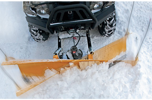

/ BX25 SnowPlowOMatic
#26
Indeed the blade can be angled L or R, as advertised by WARN.
WARN has an accessory called a PROPIVOT that I can add
if I wish. One step at a time.
The white stuff is at my Ranchette in the PNW.
#27
check looks like you are going to get your way...
Tonight a received a Warn ProPivot I found on Ebay.
It was advertised as an Open Box Special. I think all
the parts are here and a few scratches are not going
to sway me to return it so we will do the install.
Here are the basic parts that will allow me to power
angle / turn the blade from the drivers seat. It is
a very substantial unit weighing in at about 33lbs.
(Plus I can lift the plow and use the bucket)
The unit has a contactor that "should" be kept in a dry area
so I ordered up a small pelican box to throw that component into.
Should be the cats azz, wait, I mean the cats "meow" when down. ;-)

I got another key component in today, a small Pelican
box to houze the "Contactor" for the ProPivot for the plow. Things are
coming together as if the were store bought. I am extending wiring harness's
and engineering things like I want it to last, all w/ soldered connections
and nyloc nutz. Stay tuned Miss Bindian... ;-) Your tractor is bigger than mine
but "my" tractor can wiggle into places yours can only dream of.... :)

So the SnowPlowOmatic is coming along nicely.
Silly me, it has to look store-bought so were taking
some time to do the wiring right using Deutsch connectors
and soldering all joints w/ double shirink wrap etc. I hit
a snag as in the L&R plow switch has a #18 wire that
needs 12V and the main motor has #12 wires that need
12V as well. I wrote warn and asked for the fuse size
I should use, I was floored when they said NONE.
No kidding, I have it in writing.
I AM PROTECTING these circuits w/ fuses. So I opened the
fuse box and plugged in one of those add-a-circuit fuse deals
but when I went to put the lid on the fuse box it would not fit!
THAT lead into a whole new project. It WILL be right...
CLICK HERE if you want to see where we are currently sidetracked.
#32
The build is 99% done. A few zip ties here and there
and it is ready for the trailer and off to the PNW. It might
not be till next year before it is used in snow but now I
am ready. I foresee no issues. It will work well. Couple this
w/ a 5' rear blade I own and I will enjoy moving snow.
(well, so long as my Gerbings 12V heated boxers work! Ha! )
The plow is 100% removable. I had to adjust every wire for
the plow, I did it w/ Deutsch Connectors. On the FEL you
can see an Orange Pelican box, that is a junction box /
a holder for the "contactor" for the plow as well. Looks
store bought.
CLICK HERE for the latest video
