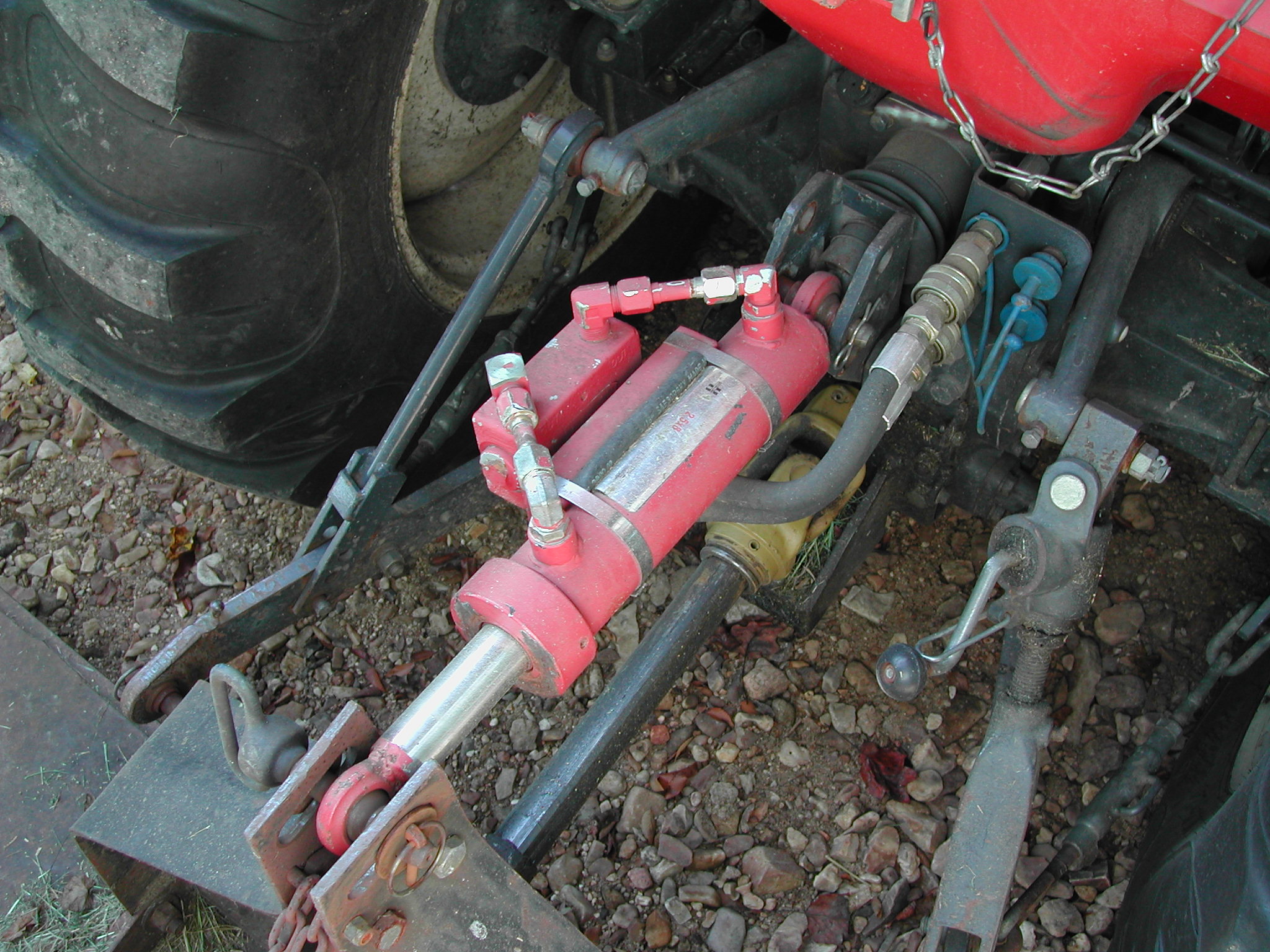

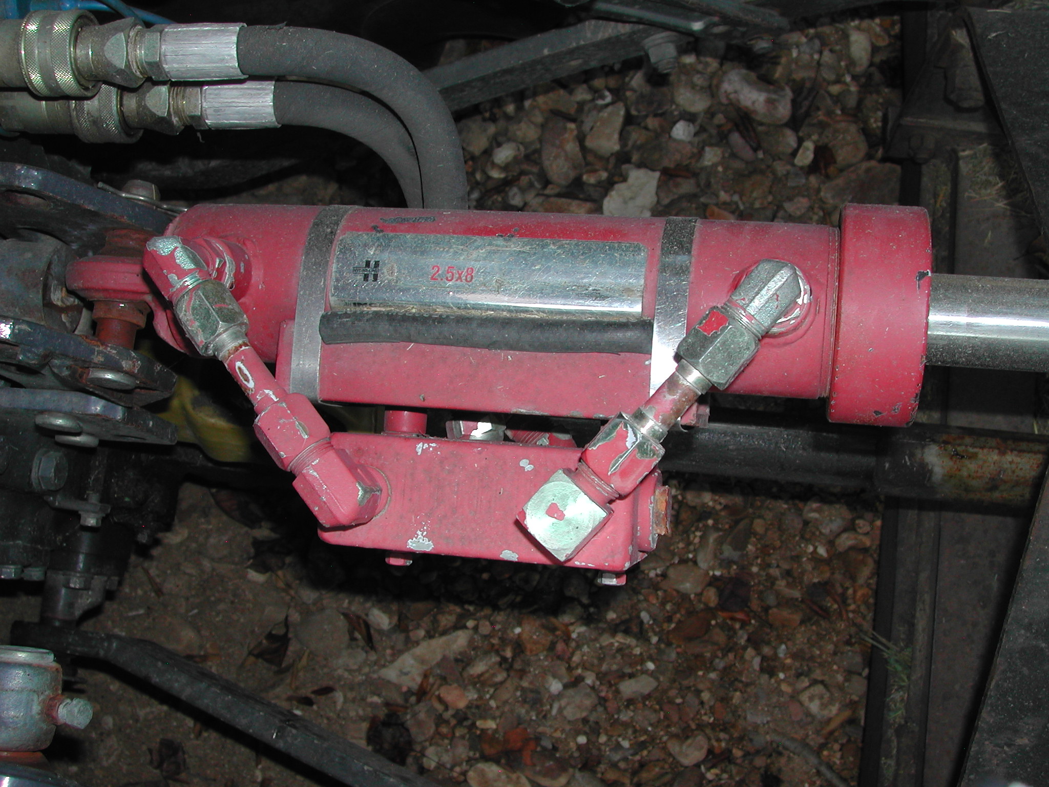

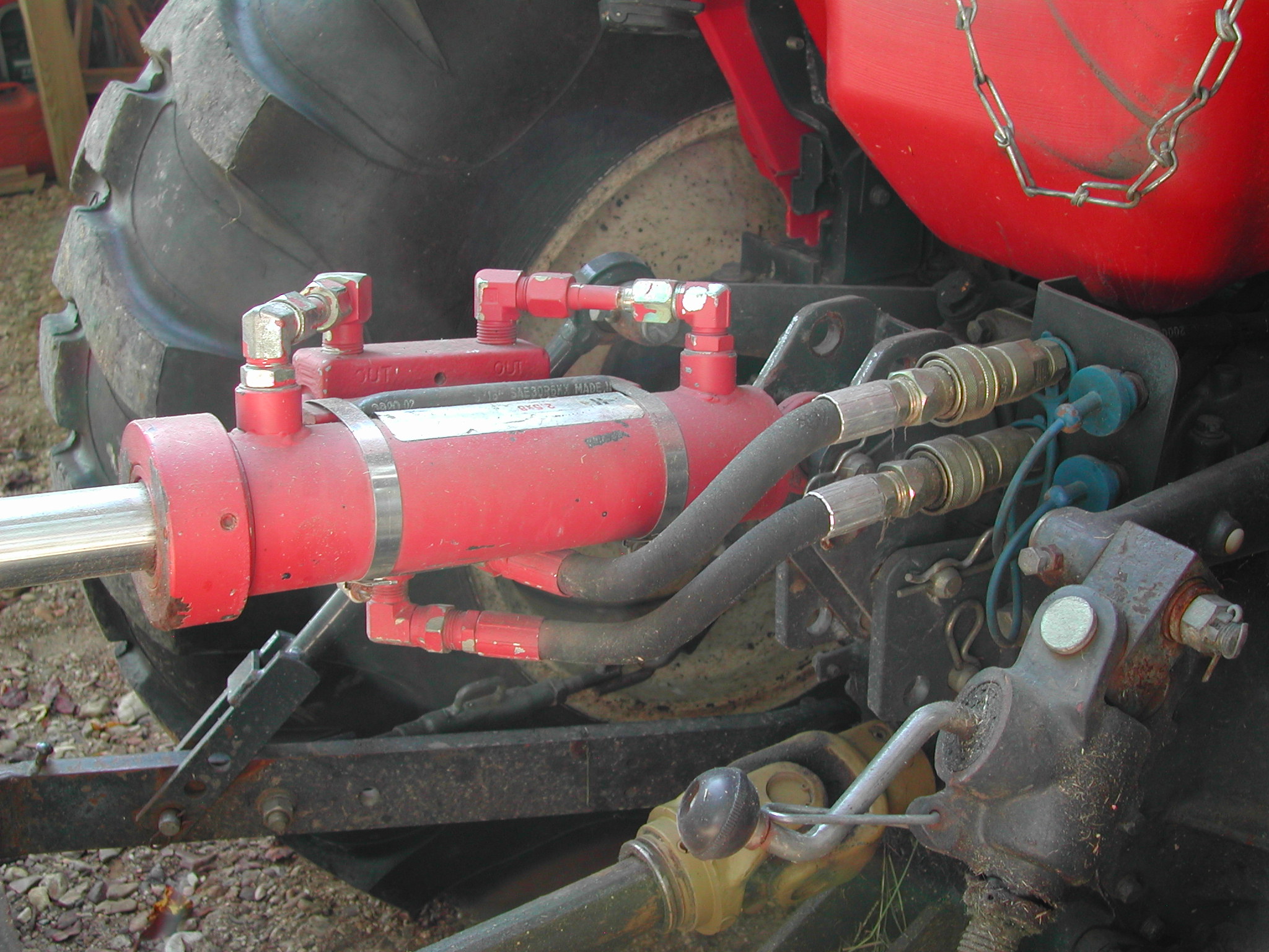

Here's the link I built. I bought the cylinder (2.5"x8"), pilot check valve & hoses from Surplus Center. The cylinder originally had clevis ends, I bought 2 weld-on swivel eye ends from Tractor Supply and cut them off by hand with a hacksaw. I was able to get the exact length I needed this way to fit my tractor's needs. Borrowed a friend's welder and installed the swivel ends. This rig has worked well for about 5 years for me so far and it has taken quite a bit of heavy work. I've got less than $180 in the whole thing, fittings and all.
For most of my uses, the ability to go shorter is more important than going longer, especially for the boxblade and bushog and transporting the finish mower. I used my boxblade as the guide when figuring the length I needed and it worked well for everything else. For my 2 bottom plow I have to use a very long top link and it's the only implement I can't use my cylinder with and have a dedicated mechanical link set for it.

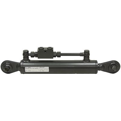

I checked the surplus version- you are right, the one with a check valve looks like the right size, but it's too long for the BX. Surplus doesnt sell one seperately just like the one in the picture! SO my question is can you can the one from surplus center 1.5X8X1 DA HYD CYL SWIVEL EYES and add the small professional looking check valve from another site to it? it would be a better fit.

/ BX25 hydraulic top link #9
Yes. you could put a pilot operated check valve on the cylinder but they ain't cheap. You could also add a needle valve to close off the fluid at the set position.
Skip, that is one of the ugliest toplinks I think I have ever seen.;) Who cares? If it works and doesn't get in the way of things, it's perfect.:) The hoses do look a little short. Do you have a full range of motion with them? I think you and Rob (3RRL) should get DIY awards for your links with DPOCVs. Great job!
