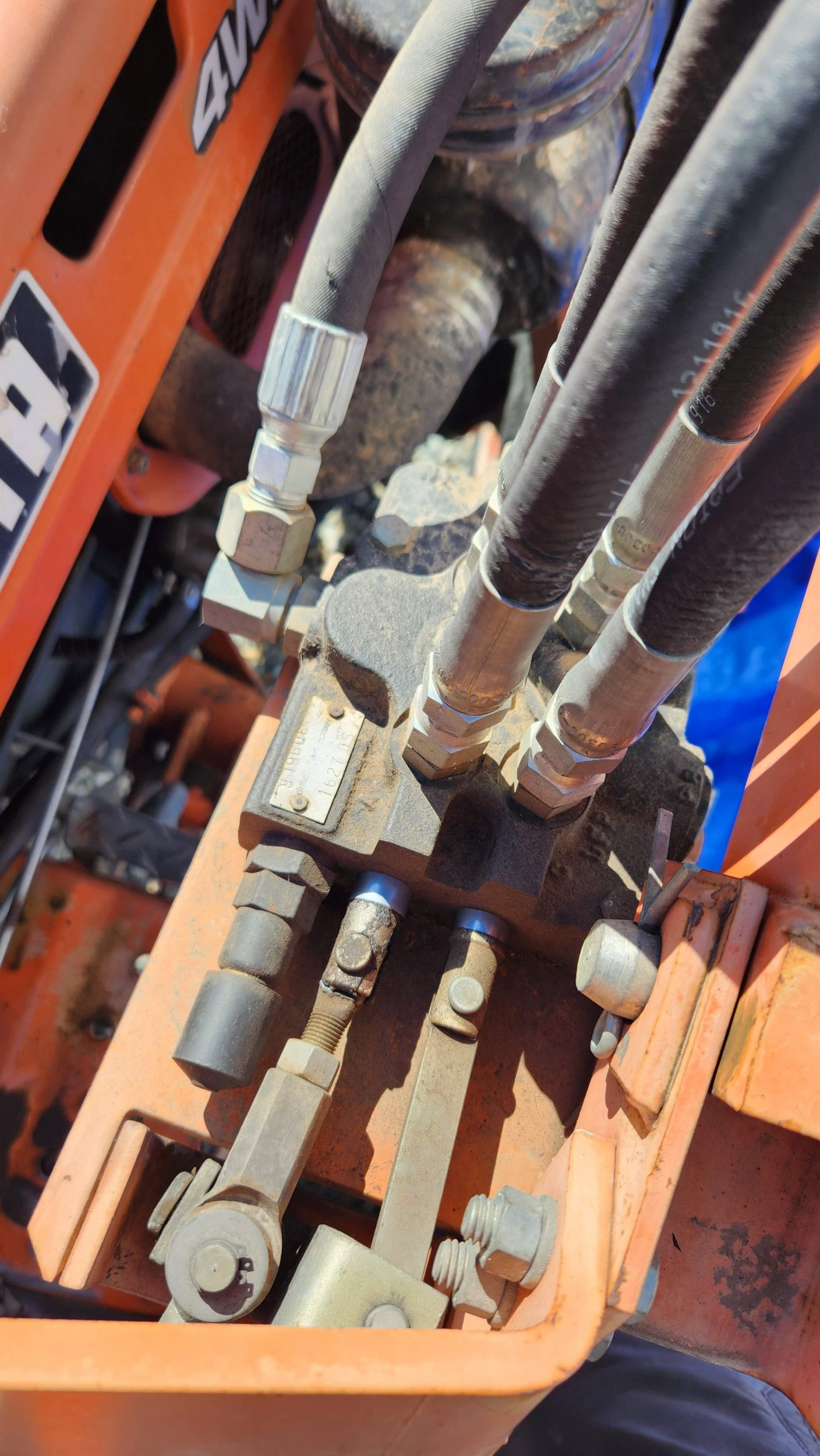

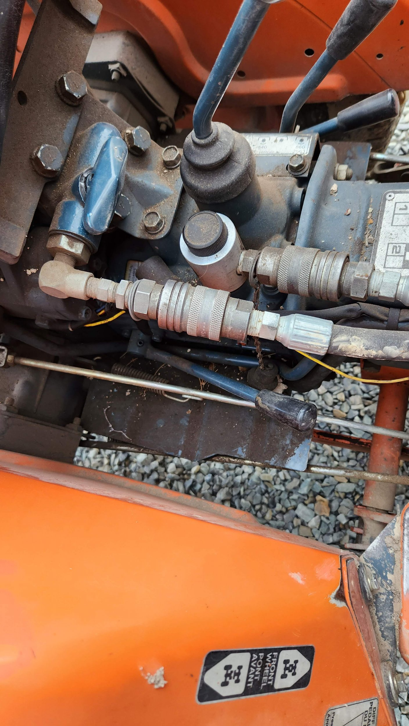

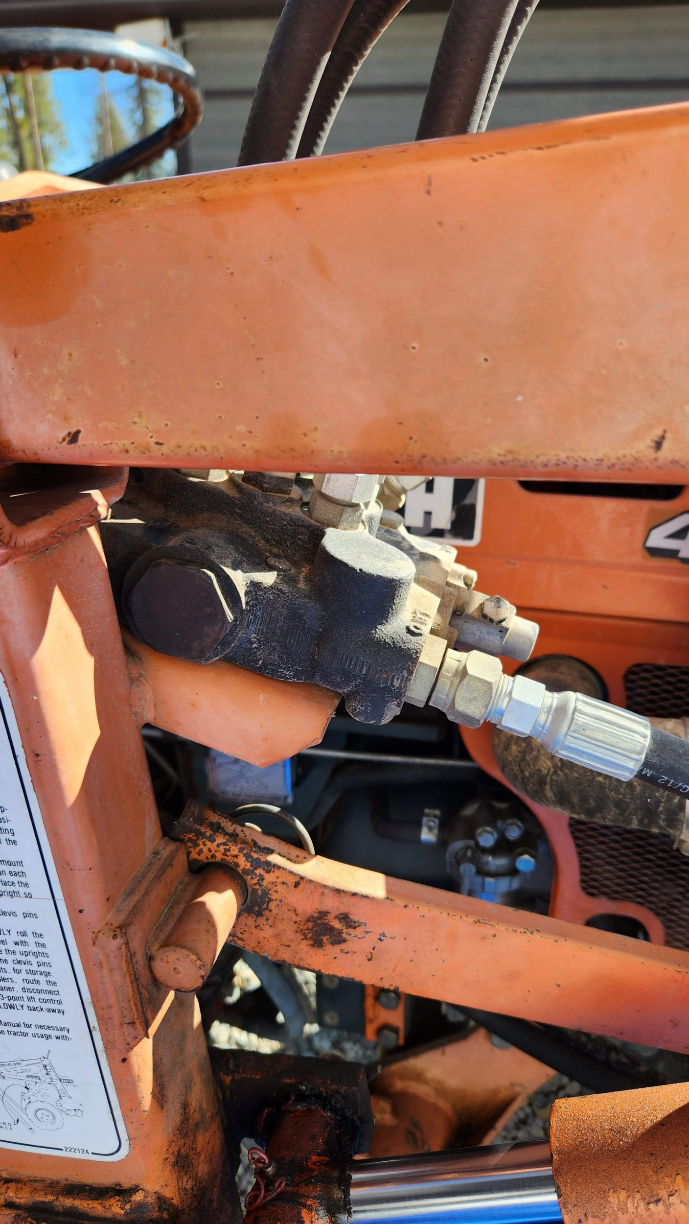

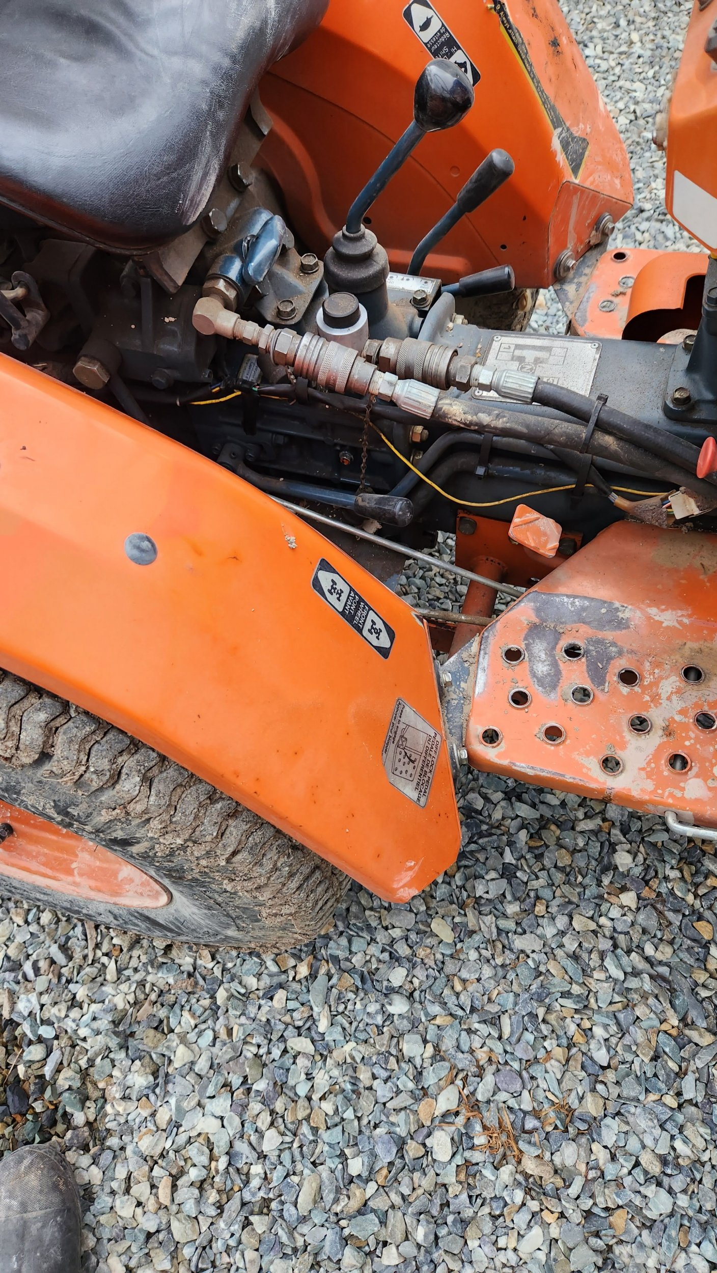

As I've used the tractor more and more, I discovered that there is a thing called a hydraulic top link that existsin the world. I immediately said, "Yes, I need that.":p I'm looking for some guidance on how I could do this. This tractor has a directional control valve(Big blue lever) that directs between the 3PH and the FEL. That diverter valve is what is throwing me off on how I can pipe in a third valve/cylinder. The FEL has a power beyond valve. Basically, I'm looking to add dedicated top link hydraulics while simultaneously using the 3PH. I would possibly like an extra set of hydraulic controls to the back of the tractor for possible future implements, but I will focus on one problem at the moment. The big kicker is how do I achieve top link functionality without having to constantly switch that directional control valve? Initially, I was thinking that I could add a valve to the FEL power beyond. Maybe that's my only choice but it forces me to keep going back and forth with the blue diverter valve. Hope that makes sense.
Is it simply a case of adding a valve on the pressure side(OUT) of the pump? Or am I forced to using the FEL power beyond port? Valve type? This is where I really start to get lost in the information. I included a sketch of what I was thinking as a possibility. Any constructive input would be greatly appreciated.
