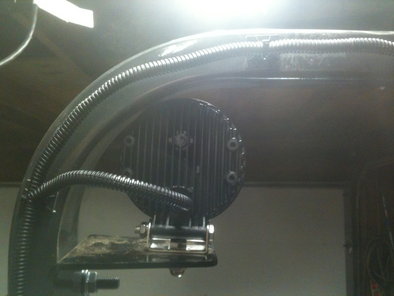

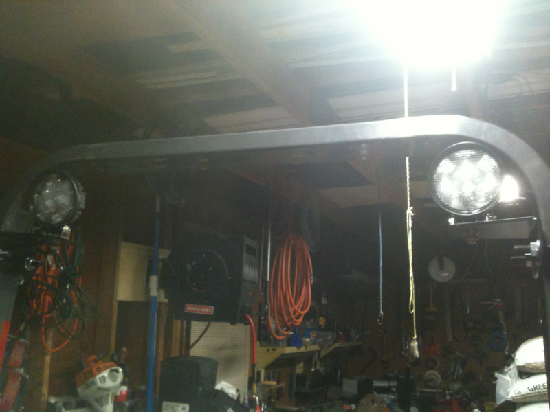

I started my work light project tonight. I installed a fuse block that will power all extras I add. I purchased two 1000 lumen led lights for the front and the Kubota rear work light kit for the rear. I also ran a 2 wire power connector so I can power my sander and sprayer.

put the same cree led lights on my rops 1 forward 1 back , with a 10 amp inline fuse, weather proof cap , put the switch on the left side inside the hand rail on a flat spot, hooked into the rear hot wire by the 3pt. hitch, works great very bright.
