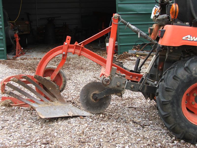

This one works well for me, don't think I could pull two though. I've measured straight across the bottom of the plow and from the landslide to the back tip of the share, it is 14".

milkman how dep do you plow.? from the picture it loks like the couter is nearly as deep as the bottom of the plow. i thought you set that only a couple of in's. .just to cut the sod. and milkman had a viedo on you tube plowing if i remember right.
/ BX24 with a 2 bottom plow? #11

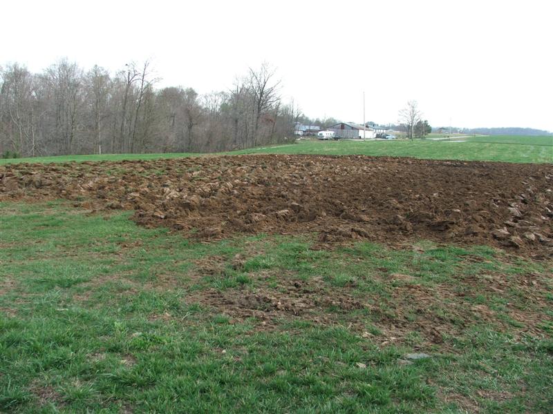

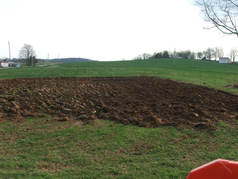

The coulter doesn't run as deep as it looks in the picture, there's a lot of slop in the pivot point on the coulter and it raise up some when in the ground. Picture of the garden last spring that I plowed too wet, probably 6-7 inches deep.
Edit: milkman how dep do you plow.? My son said that is a personal question!!!!:D:D:eek:
