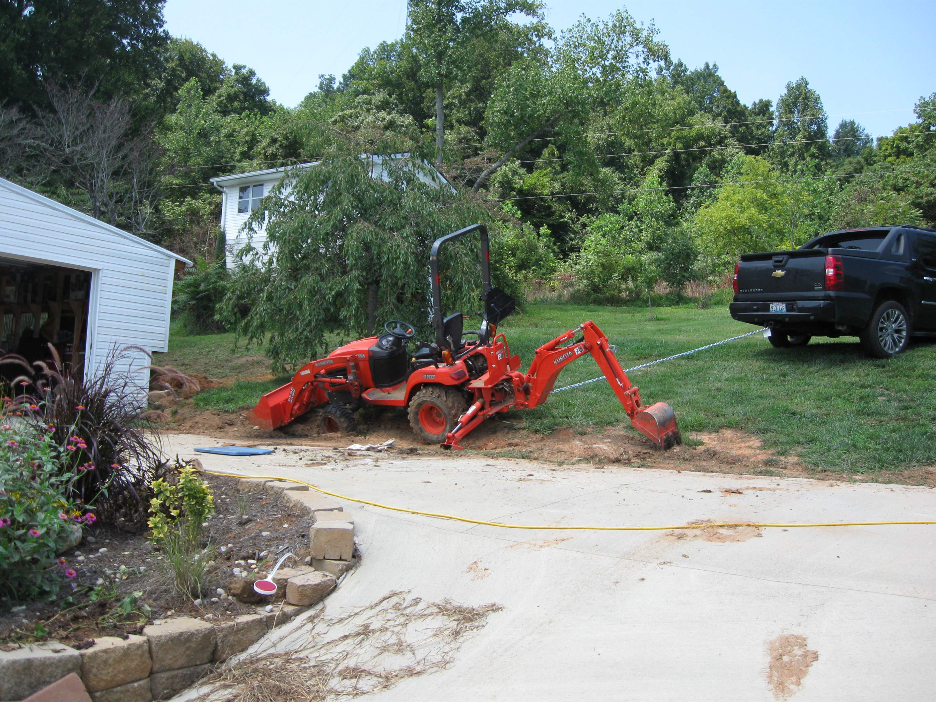

Add weight to the rear for the reasons given. Let a tractor take off with you, turn over or tear up you'll see the error of your ways. A boxblade is a very usable implement and can add the weight needed for FEL work. A used BB can be reasonably priced.
