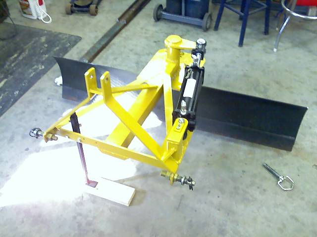

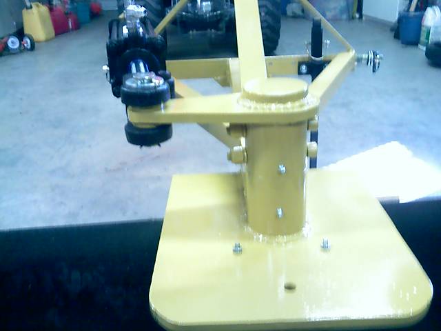

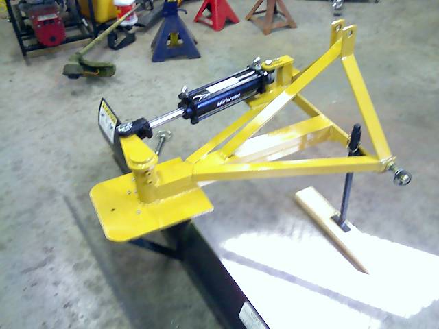

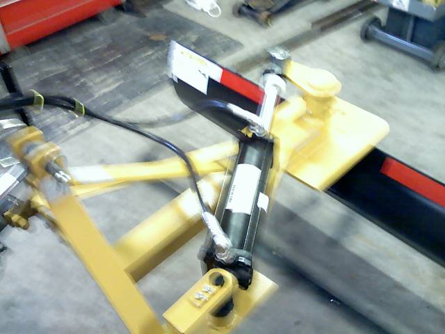

I added a Hydraulic cylinder to my rear blade this fall. Now I am able to rotate it over 180 degrees with out getting out of the seat. Can't wait to try it out in the snow, which we haven't got any yet. I used a 3" bore 10" stroke cylinder I know this is a little to big of a cylinder but it was the closest I could find for the price ($70) and that is all I have invested in the project. I made a custom stroke limiter for the cyl. so it would be able stop and go over center and the blade would go in the other direction works great. Hope to have some action pictures with it in the snow soon.

Hello,I am new to this site and since first seeing this set-up I have been set on doing the same thing to my back blade. I am in the process of buying a new B3030 with rear remotes added (after the sale of my B2150) and I was wondering how you set this up to over center and turn the blade around, and will it angle away from the tractor on the right side or just go straight across? Is there any check valve to hold it in place under load or is there a limit that the cylinder will take under load? That is one neat set-up man, here's to our sore necks!! Thanks, Bret
/ BX2350 Hyd. Angle Rear Blade #9
How do you get the cylinder to "go past center" when reversing the blade?
/ BX2350 Hyd. Angle Rear Blade #10
The reason I ask is that normally to fold anything beyond about 120 degrees requires an intermediate link between the cylinder and whatever's being rotated. The link requires some type of guiding means as it "wraps around the pivot".
Just curious how you're doing it.
Thanks
Nelson
#11
"Bret Mc" No I don't have any check valves or relief valve it is straight off the remote valve on the tractor. And as stated the cylinder is a little over sized and it can bend things if your not careful.
Bret & npalen; As for going over center it uses the momentum of the blade swinging to break it over the center point. When the cylinder is fully retracted quickly shift the valve in the other direction and the blade will keep going in that direction. At the fully retracted point I built in a little slop in the cyl. rod clevis. This allows about 1" of play on either side of the cylinders center line. So when the cylinder is retracting at speed the momentum of the blade will cause the cyl. to break over its center line. And by quickly extending the cyl. it will continue on in that direction. The external stroke limiter is how I fine tuned it. So that when the cyl. is fully retracted it is not pulling the crank arm tight.
