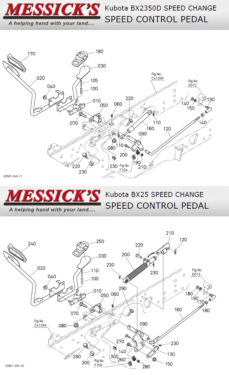

Actually the damper controls in both directions on both models. And no the **60 series damper does not help on the **50 series. Yes the linkage is different from the **50 to the **60 series.

I highly doubt they did a new HST bt they might have changed a few parts like mentioned. They might have designed a brand new linkage system. Maybe the two linkage systems showed be compared. The answer may lie there also.

I think cowbell might be onto something. However we need a willing 60 series donor like BX25 to let us TBN'ers to take it apart and compare it with mine (BX24). Yup I am willing to do that and do this side by side in same garage so we can reverse engineer this and get the answers ourselves once for all. :cool:
any takers? :licking:
Now who is planning on staying late to put both back together :confused:;):D.

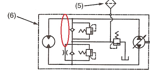

Ok, thanks to Oldnslo who posted the BX1850/2350 hydraulic schematic, I am convinced that the abrupt stop issue is caused by the lack of a flow restrictor in the forward side of the HST circuit (circled in red below):
By studying the schematic and parts diagram for the HST I believe I have found two external plugs which allow access to both sides of the "missing" flow restrictor. It should be relatively inexpensive to rig up a needle valve between the ports as a test and experiment with various settings to see if that solves the problem.
However, before diving it, I would like to review the schematic for the BX2360/BX25, where the problem is fixed, to see if Kubota fixed it by adding this flow restrictor. Does anyone have the hydraulic schematic for the BX1860/BX2360/BX25 that they could post?
Thanks in advance.
