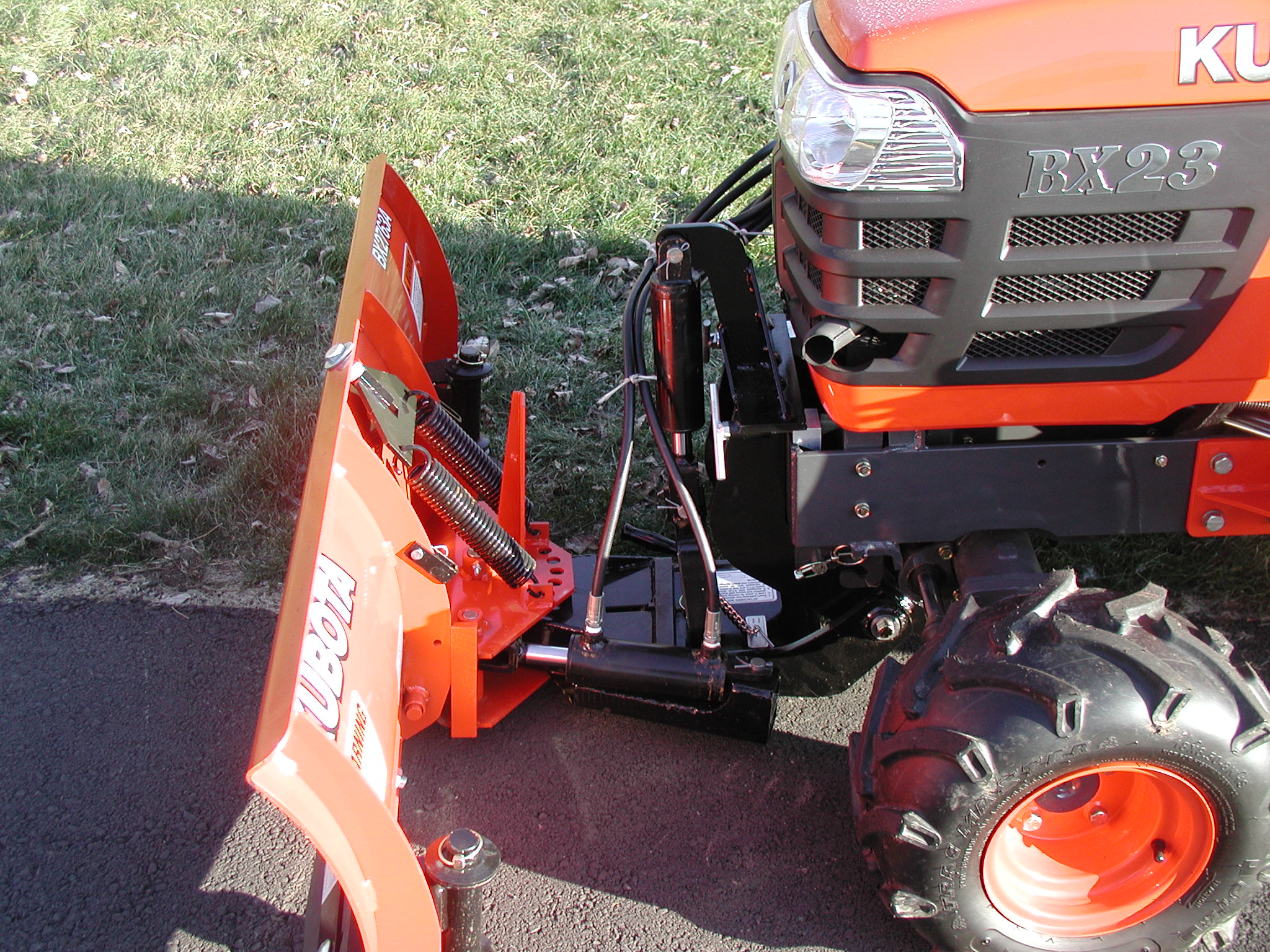

Will the fast hitch and power angle blade of the BX fit on the 3030. attached is a photo of my BX setup.

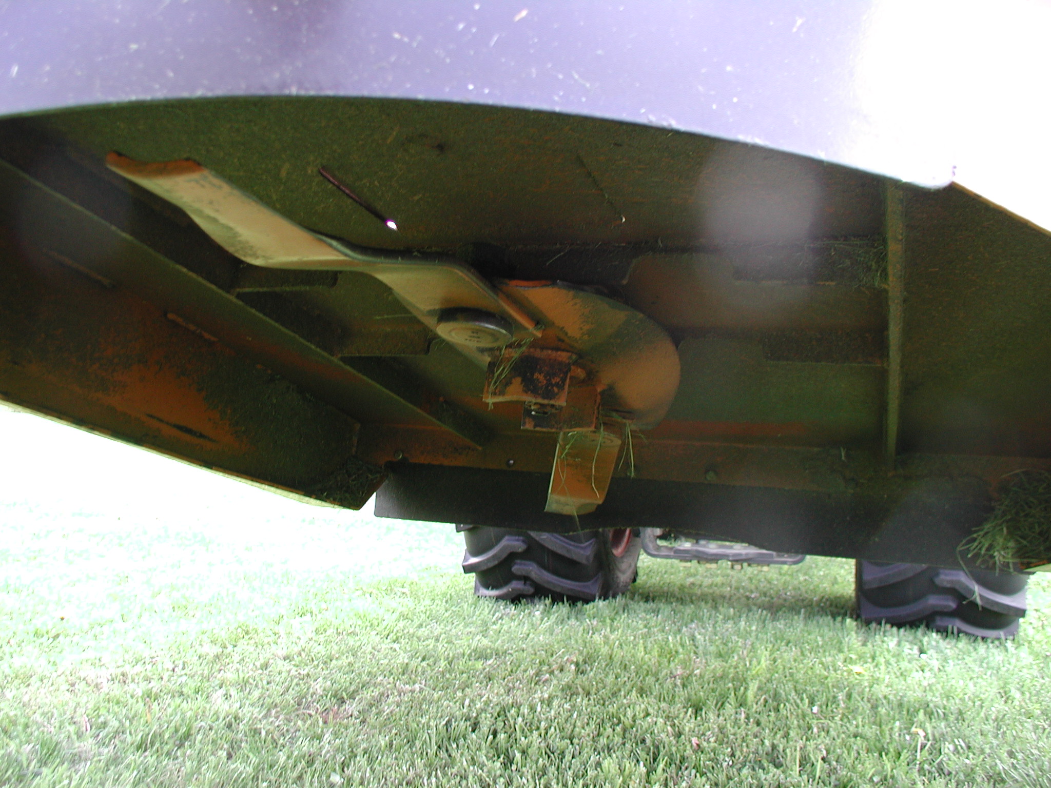

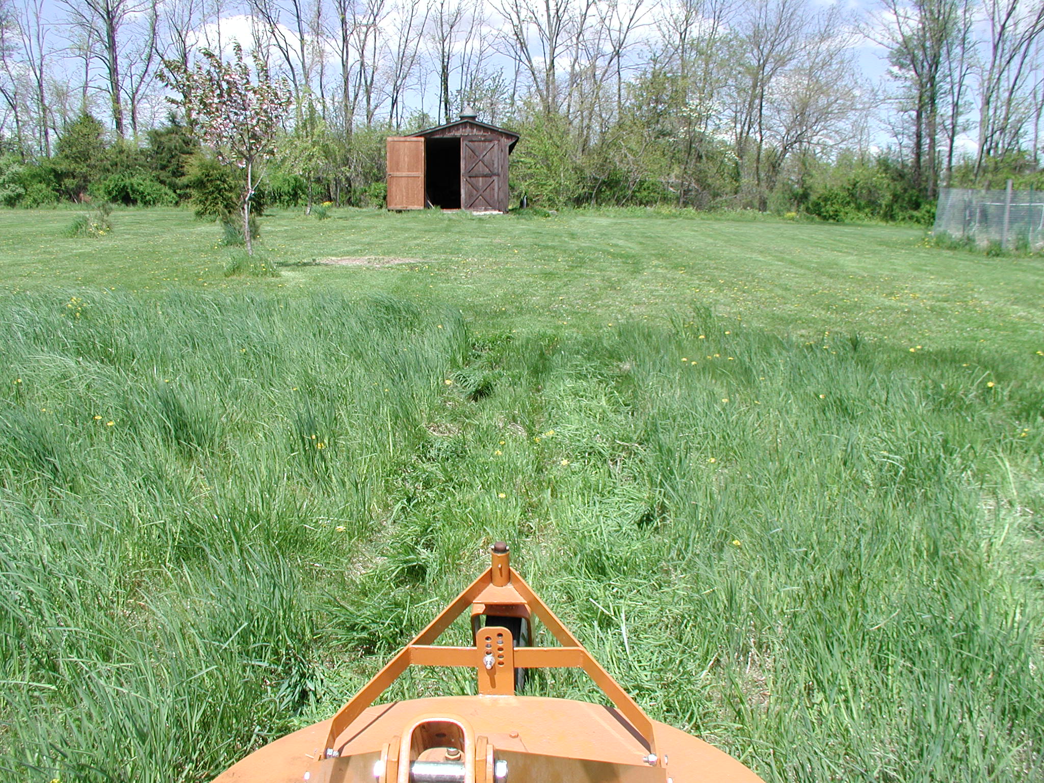

Here is the WOODS cutter and tractor and photo of the cut
/ BX23/B3030 swap
#9
the blades of the RC

Can't answer any of your B3030 questions but that rotary cutter might do a much better job if the leading edge was kept approx 1/4" to 1/2" lower than the trailing edge. Are you useing check chains?
I know what you mean about wanting a smoother ride on a BX23. On rough ground my BX23 will beat a man to death...
I was able to smooth mine out a bit by going to turfs and running the rear air pressure about 8lbs lower. It's alot better but not as smooth as a B3030 with those large wheels would be.
I'd say go it, good luck.

Regarding the reuse of your quick hitch and blade -
The B3030 quick hitch is completely different, it is huge, about 3' long.
Your blade may still work though, I would suggest using the blades with the B3030, it is much taller.

I would think you'd get a much better cut with a RFM than with the Woods cutter. My 60" RFM cuts grass much better than my Howse brush cutter. I save the Howse for the rough stuff.
FWIW......
